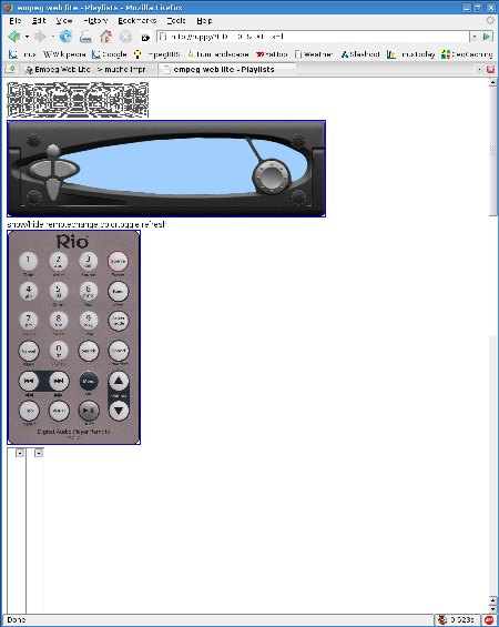

A bunch of us have been working away in a slightly obscure thread on this BSS, modifying Mark Cushman's excellent Empeg Web Lite stylesheet.
One result is the attached file, a .zip file you can download, unzip, and then move the contents to the root (/) directory of your empeg via FTP.
Once done, just surf to the Hijack web interface (upgrade to the latest Hijack first!), and click on the link at the bottom of the page. This gives you an animated facsimile of your empeg, complete with clickable buttons, and a full playlist structure for exploring your tunes.
The catch? It only (all) works in Firefox at the moment.
Development is still underway, but I feel we need more people to become involved.
So, please install it and try it out, and continue the feedback / discussions in this new thread.
Actually, only two files from the .zip are needed: default.xsl, and fascia.png. The remainder of the files are just alternative colour versions of the latter. So if you prefer an amber lens on your empeg, just copy fascia_amber.png over to your player as fascia.png.

Hmmmm - I guess I am just being really thick here, but I can't see any way to use the default.xsl stylesheet. Is this for use with charcoalgray's interface? It is the only one I have, and I don't see any alternative which references this stylesheet?
Did someone post an alternative and I have just missed that discussion?

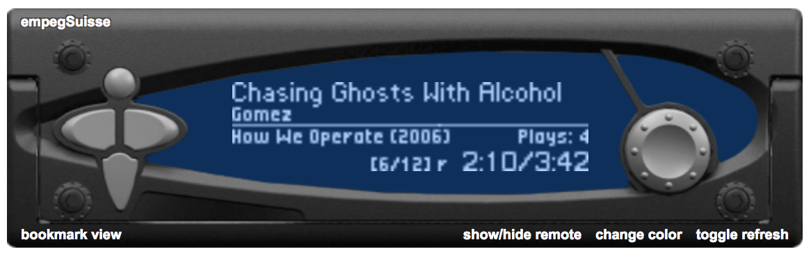

I've created a new empeg_weblite version featuring:
- fascia selection
- sorting of columns (just click on the column-title)
- 3 "lit button" fascia images are missing
- it still does not work in IE
Alex
Alex
Yeah. Here's Mark Cushman's explanation of why my hacks don't work in IE (from the original thread):
While you're around.. how do I get my button onmousexxx= events to work in MSIE? They work fine as-is in Firefox.
It's not the onmousexxx (is that some kind of kinky mouse porno?) commands that are not working, it is the imagemap. Internet Exploder doesn't allow imagemaps on PNG images without some trickery. The same page where I got the transparency fix describes the problem here. I tried the modified script, but it is just making things much more complicated. I think our options are to a) get the script to work or b) slice up the image again.
What a pain.

Oh, I meant to add: I hardly understand a word of the explanation/fix at the link in the comments above, but if you can understand it, then please have a go at implementing it for us all!
Thanks
The fix stretches a single pixel transparant gif over the PNG file and resets the imagemap to be applied to the gif. The way the script works does it behind the scenes using the DOM, although you could probably also do it manually in the stylesheet itself. The way the fix works messes up the positioning of everything on the screen, though. I can take a look at it later and see if I can find a manual way of applying the imagemap that will work cross-browser.

So, here's a list of things that would be really cool to have in this web interface:
  • Move the lens selection menu to some kind of pop-up thingie.
  • Implement a pop-up Rio Remote control, fully functional.
    For this, we can probably steal Tony's version from the button guide,
    and then just implement the onmousexxx=yyyyy functionality in pretty much identical fashion to how the existing front-panel buttons are done. It's really coma lot easier than it looks.
  • Kludges for PNG onmouse events for MS IE support (see above).
    EDIT: As I understand this one, all we need to do is overlay a 1-pixel transparent GIF onto the fascia image (specifying width="572" height="172"), and then use *that* image for the imagemap rather than the PNG image of the fascia. Right?
  • Access to the current running order via some kind of pop-up. This requires a Hijack feature that I'm in the middle of implementing for Mark Cushman.
  • A back button for easier playlist navigation.
Hi,
this version should work in IE. IE below 5.5 will use an fascia gif.
I've also added a keyboard control:
Left side: Cursor Up/Down/Left/Right
Knob rotate: Page Up/Page Down
Knob press: Keypad "5", Pos1, End
Alex
299575-empeg_weblite.zip (533 downloads)

Whoo-hoo! Well done!
Here's a slightly modified default.xsl from your last one.
This one speeds up the KnobLeft and KnobRight repeat rates
so that volume changes and BreakOut Game moves work faster.
EDIT: Oh, and you can nuke the index.xml file from the .zip archive.
Edited by mlord (23/05/2007 00:48)

Whoa, Dude!! This even now works with IE 6/7 under Linux+Wine,
something that wasn't supposed to be possible!

Here's my next update. I moved all images to a subfolder called "weblite". The default.xsl dynamically lists the contents
of this folder to find all /fascia.*\.(png|gif)/. So you just have to drop new images in this folder and they will show up
in the interface.
I also optimized the png images for size and created a better looking .gif fallback image.

Here (attached) is a slightly hacked update to 0.70 (above). This one adds a fully functional Rio Remote to the interface.
But it still needs some work, as wide playlists will overlap the Rio Remote.. need to resolve this somehow. Ideally, some AJAX wizard here would make the remote a floating image, that could be dragged around the screen at will. I think that would be super cool, but I don't know how to do it off-hand.
Also, it would be really nice to have the Button Guide information pop-up as help text when one hovers over a button for more than xx seconds.
Anyone here know how to do those simple things ?

#307931 - 05/03/2008 16:08 Re: Adding a clickable Rio Remote.. [Re: mlord]
Posts: 14537
Or, actually, just a small button on the screen just (below the fascia? or on the rivets?) that one presses to make the remote appear/disappear when needed (below the fascia, on top of the playlists).
That's probably better, and less cluttered.
#307933 - 05/03/2008 17:02 Re: Adding a clickable Rio Remote.. [Re: mlord]
ghostwheel
Registered: 18/07/2001
Posts: 41
Loc: Koblenz, Germany
Hi,
I've created a quick-hack "movable" version here:
https://www.ghostwheel.de/empeg/
Give me some time and I'll finish it.

#307936 - 05/03/2008 17:23 Re: Adding a clickable Rio Remote.. [Re: ghostwheel]
Posts: 14537
Originally Posted By: ghostwheel
Hi,
Alex
Okay, that's looking cool!
I think what we might want is to have it not normally visible, and clicking on one (or any) of the four rivets would toggle it on/off display-wise. (?)

But it doesn't work here (Firefox 2 on Linux):
#307945 - 05/03/2008 22:52 Re: .png or .gif for image map? [Re: mlord]
Posts: 14537
Oh.. your .zip file is missing these:
weblite/weblite.js
weblite/domresize.js
weblite/weblite.css
whoops, fixed. sorry.
a new zip file is attached.
Alex
empeg_weblite.zip (361 downloads)

I've just finished a new version which can parse some variables passed in the URL - now you can save a bookmark with your favorite settings.
There are three parameters:
remote=[0|1]            example:  remote=1   (show remote)
color={name}            example:  color=red  (load fascia_red.png)
refresh={milliseconds}  example:  refresh=0  (disable refresh)
I haven't tested it on my empeg (it is in my car, I know I shouldn't leave it there) and hope the parameters don't interfere with the other parameters FID and EXT.
An example URL would be:
http://www.ghostwheel.de/empeg/?FID=91e1&color=green&remote=1&refresh=0&EXT=.xml
Alex
empeg_weblite.zip (478 downloads)
Edited by ghostwheel (06/03/2008 22:45)

#308072 - 10/03/2008 19:40 Empeg Weblite 0.93 [Re: ghostwheel]
ghostwheel
Posts: 41
Hi,
the last version didn't work on the empeg because of the query string variables. I've fixed this - the variables are now passed as anchor ("#"):
sort={column}           example:  order=artist (set sort column)
order={asc|desc}        example:  order=asc    (set sort order)
An example URL would be http://www.ghostwheel.de/empeg/?FID=91e1...title#order=asc
Version 0.93 also has a new fascia "rainbow" and a bookmark button to save a favorite of the current view.
Alex
empeg_weblite.zip (445 downloads)

I recently became the owner of more than one empeg whistle
As such, and even though I have them setup in my local DNS with different names, I decided to add the player name to the UI of weblite, in order to see which player I'm dealing with at-a-glance.
The player name is displayed on the top left corner of the fascia:
I modified the weblite code ever so slightly and here it is for everyone...I also incremented the version to 0.96. Apologies for any future versioning clash that might cause smirk
Screen Shot 2018-05-17 at 2.47.35 PM.png (1659 downloads)
weblite_0.96.zip (87 downloads)
