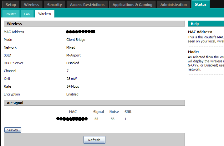

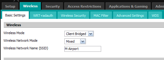

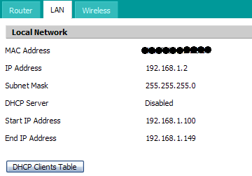

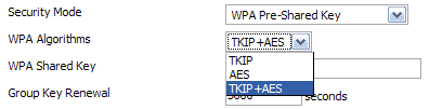

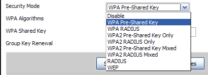

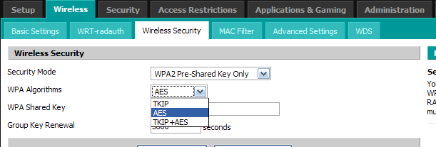

I'll try to get a screen shot of the options on both routers.
I've included the screenshots. The first is the Airport, the second two are the Linksys.

Let's simplify the interoperability somewhat: Set both routers to use WPA2-Personal(Pre-Shared Key Only), and AES only. Not WPA/WPA2, just WPA2.
This way we'll eliminate any mis-matches in encryption methods and the like, which have confounded many others before you.
Next, find that status screen (or log) on the Linksys, so that you can know *for certain* exactly what is happening (or not).
Edited by mlord (11/01/2008 17:39)
#305987 - 11/01/2008 17:37 Re: Wireless bridging! [Re: mlord]
Posts: 14537
This is necessary, because two things have to be working for your PC to connect:
(1) the wireless association between the routers, and
(2) the forwarding of IP packets from your PC to the far end.
The status/log info will help track down which part is not working.

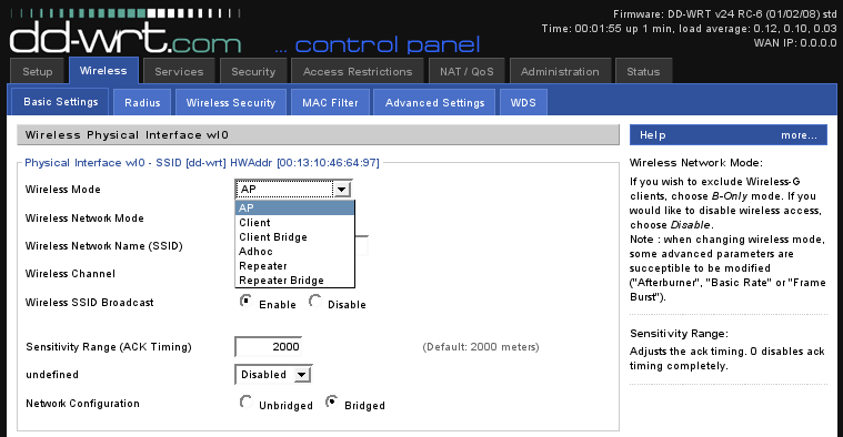

Mmm.. no problem with the wireless bridging part -- except there's a choice of bridges in the DD-WRT config: Client Bridge or Repeater Bridge.
Just for fun, I chose Repeater Bridge.
The bridge works, but I cannot figure out how to turn off the DHCP server in the DD-WRT box, so my clients always get a bad DHCP setup from it. If I manually set the IP config, my client talks across the bridge and out just fine.

Okay, in DD-WRT, click on the Status tab, and then on the Wireless sub-tab that appears. Then go to the bottom of that screen, and hit Site Survey. Your airport router should appear, so then just click on the Join button to connect to it.
If all goes well, it should show it connecting.
Then back to the Status->Wireless page again, scroll down, and (refresh) it should show the SSID of the airport router, along with Rx/Tx packet info etc..

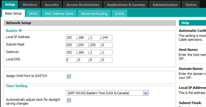

Anyway, my fix here, was to just change the static IP of the DD-WRT to be compatible with the subnet at the far end.
My internal net uses 10.0.0.0/24, so I went to Setup->Basic Setup and just put 10.0.0.144 into the Local IP Address field.
It all now works just fine.
You should probably do something similar, if only to prevent the two APs from trying to use the same IP address.. they may both be defaulting to the same value there..

So I can enable DHCP on the Linksys, but just give it a different range? If so, it makes sense to me.
I've done that "Site Survey" and "Join" part, and I saw the Airport's SSID and chose it, but it never works after that...

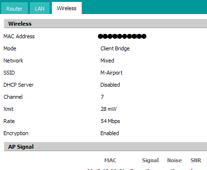

That's odd, I don't see Repeater Bridge, just Client Bridge.

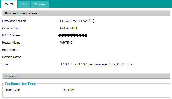

I've included screenshots of what I believe are all the relevant sections in the DD-WRT admin. In the first one, I only just recently changed "Gateway" to a value other than 0.0.0.0 (I'm just fumbling around in the dark here, I think), so I'm sure that isn't right.
The second shot I included just to ask if it should be Gateway or something else.

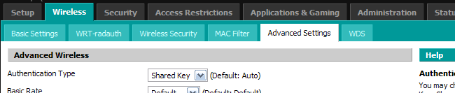

The rest of the shots.
No, just disable DHCP Server on the Linksys -- it actually did that automatically when I selected "Repeater Bridge" as the base configuration. The part I missed at first though, was to fix the IP address of the Linksys, to be in the same range (subnet) as used by the other router.
Mmm.. well, you're right that the problem is there.
The DD-WRT firmware I'm using here is whatever was current when I got the thing: DD-WRT v24 RC-4 (10/10/07) std.

Now upgraded to the latest V24_RC6.2 firmware.
And it still has a "repeater bridge" option. smile
But reportedly that is broken in this version. frown
Edited by mlord (12/01/2008 01:10)

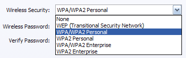

I just noticed that on the wireless settings page in the Airport configuration utility, right under the password it says "WPA2 clients can join this network using AES-CCMP." Might that CCMP, whatever it is, be important?
#306029 - 12/01/2008 03:55 Re: Wireless bridging! [Re: Dignan]
Posts: 14537
AES+CCMP is generally what is meant by "pure WPA2". The Linksys can handle it just fine. But many other, older wireless devices cannot do AES, so they want TKIP+CCMP instead (I think I got that right). Which a "pure WPA2" box may not support.
Try upgrading your DD-WRT to the V2_RC4 version that I tested with here -- known to work, and all of that.

I just had a look at mine running v23 SP2. I am only using WPA, not WPA2.
From memory I couldn't get it bridge properly when using WPA2. I was happy enough with just WPA. So that might be the issue you're having although you're running an even older firmware version.
I'd be at least upgrading to v23 SP2 or try that v24 version Mark suggested. You said you're running v23 SP2 but the screen shot you gave shows only v23. It should say "DD-WRT v23 SP2 (09/15/06) std - build 3932"
#306032 - 12/01/2008 06:54 Re: Wireless bridging! [Re: Shonky]
And v23 SP2 doesn't seem to support AES-CCMP that I can see.
#306035 - 12/01/2008 11:40 Re: Wireless bridging! [Re: Shonky]
Weird, I thought I'd gotten sp2. I might try that release candidate later today.

Well, I got the release candidate, and now everything appears to be working! I guess they didn't have the encryption stuff really worked out correctly in the older releases. I'll have to keep up with the firmware (though I'll probably take the "if it aint broke, don't fix it" approach).
In the end, I still wasn't able to use WPA Personal on the Linksys, even though the Airport was in WPA/WPA2 Personal mode. But the Linksys now has completely different encryption options, including WPA2 Personal (it wasn't there before). That one worked.
Thanks for all your help, everyone. I appreciate the assistance greatly.

#306060 - 12/01/2008 20:40 Re: Wireless bridging! [Re: mlord]
Posts: 14537
Okay, still no problems here.
I have my DD-WRT (Linksys WRT54GS_v2) configured as "client bridge" over the wireless, and I now have two wired PCs plugged into it using remote DHCP, and now surfing the internet.
The DD-WRT is relaying everything over WiFi (WPA2-Personal/PSK) to another brand of WiFi access point (AP) in another part of the house, and that AP is wired to the internal LAN here.
A wired server on the internal LAN provides DHCP service for all, and is also the internet gateway for our external DSL connection.
File transfer throughput (NVSv3) to/from a DD-WRT attached PC, to the wired server at the far end, is about 20 mbits/second, which is pretty much what one should expect over a Wireless-G connection (under 50% of the raw 54mbits/sec rate).
Any questions?
Edited by mlord (12/01/2008 21:09)
