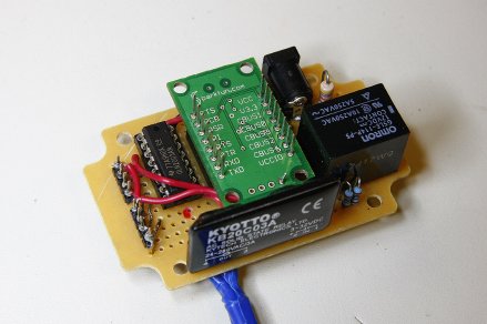

Now, there's a good USB Device string I could use for the next version of it!
I've got my new solid state motor controller PCB (just a chip, really), and the USB-to-Serial-and-GPIO converters.
I'm going to combine one USB converter with the motor controller and motor, into a simpler bus-powered Frankenswitch device. This takes 3 GPIO pins: one for "clockwise", one for "anti-clockwise", and another for "idle" mode.
That still leaves many more pins, and a full serial interface unused.. mmmm...

#316771 - 29/11/2008 04:38 Frankenswitch v2. [Re: mlord]
Posts: 14546
Frankenswitch v2.
Description: Frankenswitch v2. Two 3:1 automated coax switches for my PVR.
#316776 - 29/11/2008 13:54 Re: Frankenswitch v2. [Re: mlord]
Wow, I'm so glad I get all of my terrestrial TV from one transmitter.
#316779 - 29/11/2008 14:58 Re: Frankenswitch v2. [Re: andym]
Posts: 14546
Now admittedly, it is a bit over the top.
We currently get reception from three different vectors: a big tower north of town (about 2/3 of the local stations), another south-east of town (the other 1/3 of the locals), and a very distant station far south-south-east of here (USA PBS station).
So this gizmo has a pair of 3:1 pushbutton switches (one for each analog tuner in the PVR), and six solenoid actuators to press the buttons. An FT232RL USB-serial breakout board provides control (in "bitbang" mode), and a ULN2003A darlington array drives the solenoid coils.
For added complexity, there's a small relay to cut DC power from the solenoid circuitry when idle (for paranoia). But it's kinda redundant now, since I later added a second, solid-state relay to power down the entire AC PSU (a brick which provides +27VDC@600mA) when idle (saves watts since the thing is only rarely active, and only then for brief instants).
It was a fun build! smile
Description: The control unit.
