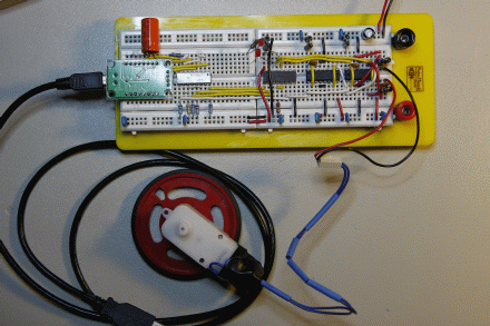

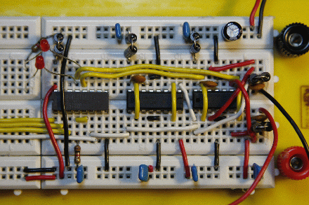

#308271 - 16/03/2008 01:28 Re: Electronics help- H-Bridge is annoying me [Re: Ross Wellington]
Posts: 14478
Thanks, Ross. I'm still digesting your latest brain dump, but do please keep them coming. I'm sure everyone else here also enjoys them!
Meanwhile, I decided that the only way to improve the layout of my circuit was to scrap the preassembled L293D boards. They are fun to play with, and have blinken lights for debugging and all, but they also lack any attempt at EMI suppression. Not a single cap on board either of them.
My last order from Digikey included a couple of raw L293D chips, so I just plopped them down on the breadboard, and started routing signals again.
This time I was careful to keep the logic and motor power buses completely separate, as well as maintaining the full isolation to the USB sub-assembly.
I applied a generous spinkling of little through-hole ferrite beads, and some little blue capacitors labeled "693M", as well as my limited stock of 0.1uF ceramic discs.
Woo-hoo, it works!
I can power the motor & electronics from the same ATX supply that the PC and USB end use, and have not managed to trip up the USB at all, despite furious attempts to do so.
Here are some photos of the latest layout.
Description: The complete breadboard. USB isolated at the left by the "shiny" quad optoisolator chip.
Description: The motor side of the house. Left chip is a 3:8 decoder to provide fan-out from my limited number of GPIO pins. Lots of ferrite beads and pretty blue capacitors, too! The middle H-Bridge is not fully wired up yet; I've only been testing with the rightmost

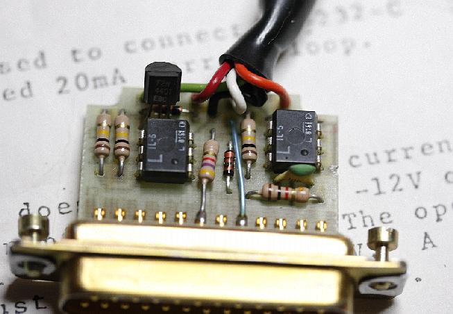

#308336 - 17/03/2008 20:05 Re: Electronics help- H-Bridge is annoying me [Re: mlord]
sn00p
Registered: 24/07/2002
Posts: 618
Loc: South London
We've now switched to isolation routing for in house prototypes, veroboard was taking too much time and effort:
#308337 - 17/03/2008 20:19 Re: Digital Storage Scopes.. cheap! [Re: mlord]
Speaking from personal experience, those breadboard blocks you're using are a sod for crosstalk. I've long since given up using them, as every circuit I was inerested in building on them simply wouldn't work because of the parasitic capacitance or inductance of the things.
Also, stop finding useful toys and posting the links! I've just finally completely paid off my credit card, and you go and tempt me with a decent scope at a good price wink
#308338 - 17/03/2008 21:34 Re: Digital Storage Scopes.. cheap! [Re: pca]
Posts: 14478
Yeah. It's particularly bad with those H-bridge chips.. the signal pins are sandwiched between power pins and output driver pins. And most of the signals are paired across the chip (opposite pins tied together, like the cute yellow jumpers above).
I can hardly wait to view the carnage once the new scope arrives.

#308339 - 17/03/2008 21:40 Re: Electronics help- H-Bridge is annoying me [Re: sn00p]
Posts: 14478
Wow! That looks totally extreme! Like for RF or something.
Thanks for posting it!
#308340 - 17/03/2008 22:02 Re: Electronics help- H-Bridge is annoying me [Re: mlord]
sn00p
Posts: 618
Loc: South London
Cool. Glad you liked. smile
That board is totally non exciting though! It's just a uart (TTL level) to 20ma converter (vending machine interface). I knew it'd take ages to do on veroboard, then check and double check...only to find that it didn't work.
