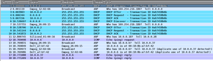

#312824 - 09/08/2008 13:22 DHCP trace from car2-v3alpha11 [Re: mlord]
Posts: 14524
Here's the wireshark trace. First, a short summary for those with good eyesight, and then an attached binary blob that can be reloaded back into wireshark for viewing/interpretation.
A more readable copy of the image below is available here.
Description: Screen capture
v3a11_dhcp_trace.bin (676 downloads)
Description: tcpdump format output from wireshark.

#312825 - 09/08/2008 13:35 Re: DHCP trace from car2-v3alpha11 [Re: mlord]
Posts: 14524
One problem seems to be that the empeg's bootp request has the "broadcast bootp flag" set, so the server must use broadcast when replying.. and that reply then gets picked up by all other empegs on the subnet.
Most of the other DHCP clients here do not set that bit, so the server sends a targeted response to them.
I could try having Hijack clear that bit on the outgoing packet, and see if the empeg copes with it.
Edited by mlord (09/08/2008 13:37)
#312826 - 09/08/2008 13:43 Re: DHCP trace from car2-v3alpha11 [Re: mlord]
Posts: 14524
Mmm.. I suppose that trace is not quite complete -- used a switch during the capture. It still illustrates the problem (two players claim the same IP address, even though they were assigned different IP addresses by DHCP), but not the complete sequence.
So for completeness, I'll later hook up a shared hub and run Wireshark from there to get all of the packets.
#312827 - 09/08/2008 13:58 Re: DHCP trace from car2-v3alpha11 [Re: mlord]
Hmmm... I do remember now that we set that bit for a reason -- we found a situation (perhaps it was a particular server) where it didn't work without the "broadcast replies" bit set. Still, that was the last remaining bit of the puzzle. You'll notice that your captured packets 3 and 8 (OFFER replies from the server aimed at the two clients) have the same xid in (Wireshark: "Transaction ID"), but different chaddr (Wireshark: "Client MAC address"). The Empeg, utterly incorrectly, matches on the former but not the latter.
So I suspect that checking incoming UDP to port 68 (bootpc) and dropping on the floor (or scrambling the xid of) packets whose chaddr isn't ours, would fix the problem.
Edited by peter (09/08/2008 14:05)
Edit Reason: chaddr, obviously, not ciaddr
#312830 - 09/08/2008 19:25 Re: DHCP trace from car2-v3alpha11 (Hijack v501) [Re: peter]
Posts: 14524
Yes, that certainly does seem to fix things.
Hijack v501 is now released, with this workaround incorporated.
Thanks, Peter!
