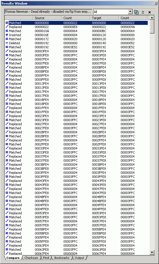

Empeg web interface in theory allows downloads, but it does not seem to work on any browser here.
However, I downloaded the fid via ftp.
on www.ilquen.it/download you can find a mp3 which gets skipped regularly by the ipod, and it's empeg version which works well on the empeg: i downloaded via ftp and hopefully did not damage it.
#316104 - 08/11/2008 11:41 Re: Issue downloading MP3s using Jemplode [Re: Taym]
... I also put two more mp3s, one with and another without glitches. The difference is clearly audible. And, the one without glitches was downloaded again via ftp from the empeg.
Something definitely happened while I wa susing jemplode...

Ok. So yeah the tags are different somehow. Looking at the Thomas Newman track basically 4 bytes are replaced with zeroes every 16kB. So the tracks were the same and from the same encoder before getting corrupted at least
Possbily whatever created the new tag with "Taym's Grab & Encode" has also munged the file?

Now, if there are 4 bytes replaced with zeroes every 16kB, that seems like a pattern. I doubt it is caused by random connection issues....

#316178 - 09/11/2008 21:54 Re: Issue downloading MP3s using Jemplode [Re: Taym]
Originally Posted By: taym
Shonky, what did you use to compare the two files?
Hexworkshop. Best hex editor I've found so far (there's a lot of crap ones) - not 100% happy with it but it does the job for most things I need.
http://www.hexworkshop.com/
When you've done the compare you can click on the lines in the screenshot I sent and it will highlight the data in the files.
Edited by Shonky (09/11/2008 21:56)
Edit Reason: added bit about compare
