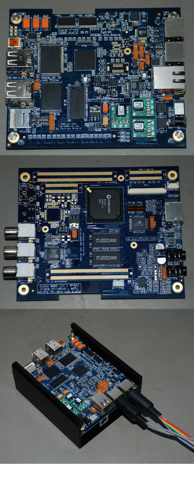

#316309 - 13/11/2008 16:52 It lives! My latest toy actually works :)
Hi.
As a few of you may know, for quite a while (ie more than 8 years) I've been working on a variety of remote piloted vehicle systems, mostly for my own amusement. The ultimate goal is for flying radio controlled aircraft, but quite a lot of the development has been on ground-based stuff for the simple reason that a system crash doesn't involve quite as many bits to dig out of the ground smile
The latest remote piloted buggy, based on an old electric wheelchair, was at the 10th empeg birthday party that various BBS members went to. The VR helmet system I was using there is about the 4th generation I've designed, and finally does pretty much everything I want but was rather bulky. I redesigned it into a much smaller form factor, and have just finished building the first set of PCBs. The processor board came up perfectly on the first attempt, and I've so pleased (and relieved) I felt I had to mention it wink
I packed it down from a backpack about 50cm x 60cm x 15cm to a box 10 x 12 x 5cm, and less than half a kilo from around 8kg. The ultimate goal is to build the entire thing into a VR helmet, but that's for later.
There's quite a bit in the box:
CPU board specs
200MHz EP9307 ARM9 processor (not the best implementation around, in fact it's pretty buggy, but I've been working with it for three years and know where most of the bugs are. In fact I found several of them, and how to work around them. The main thing is that it has a very configurable video subsection, which I needed)
64MB PC100 SDRAM
16MB flash
VGA output port
18 bit TFT output
Touch screen interface
I2S codec interface x 3
3 axis +-2/8g accelerometer
3 x serial, 2 at RS232 levels, one at 3V TTL
3 x USB2 HS host ports
3 x USB1.1 FS host ports
SPI
MicroSD card socket
I2C at 3.3V and 5V
10/100M ethernet
Runs from 8V to 24V power with on board SMPSU
Full data and control busses on expansion ports
Loads of GPIO lines
Graphics Overlay Board specs
2 x CVBS/Svideo/Component video input stream capture ports
24 bit TFT output port
VGA output port
24 bit stereo codec (line in, line out, Mic in, S/PDIF output)
Digital video expansion for stacked CVBS output board
Video processor which does:
PIP
PBP
Genlock
Chroma Key
Alpha blending, translucency, etc
Input and output scaling
and many other effects
The idea is that the processor board, which runs linux, generates onscreen graphics for virtual flight instruments from real time telemetry received from the remote vehicle, which the graphics board then blends and overlays onto the live video from the same source, in full colour. The prototypes, which I've been working on for around three years, worked very well, so I finally did a finished version.
Two graphics boards can be stacked on a processor board for full stereo operation. With one overlay board and one cpu card, the whole thing fits neatly into an off-the-shelf aluminium box giving a really nice looking system.
I mention it here as (A) I'm really pleases it works after nearly a year of design work, and three days solid of assembling the PCBs, and (B) possibly someone can think of other uses for it.

Nice work, I wish I could design PCB's of that complexity. Out of interest, did you have to put 'everything' on the boards? Do you do the BGA stuff yourself with a reflow oven?
#316324 - 13/11/2008 22:28 Re: It lives! My latest toy actually works :) [Re: andym]
I got the BGAs mounted by a company that does vapour phase reflow. £10 per chip, by far the cheapest I found anywhere. I am, as it happens, slowly building a reflow oven, but this project was too important to try experimental soldering techniques on. smile
I stuck down everything else. The 0402 resistors, etc, are easy enough, but the 0804 resistor networks are a bit of a pain.
#316328 - 13/11/2008 22:44 Re: It lives! My latest toy actually works :) [Re: pca]
The soldering looks really neat, I imagine a good deal of solder paste, flux and patience was used! smile
There's pretty much everything you'd possibly want on those boards. What's the per-board cost assuming they were pre-assembled?

So you designed it, sourced and obtained the parts, and soldered them all onto the board. Here I was proud of myself because a couple weeks ago I managed to solder together and shrink wrap two wires replacing the battery in my Karma without burning myself or setting the house on fire.
Sigh...
#316349 - 14/11/2008 06:48 Re: It lives! My latest toy actually works :) [Re: andym]
Don't use solder paste actually, I've always found it to be more trouble than it's worth. I just use fine flux cored solder. When building for my own purposes, PROPER solder as well, not that lead free crap smile
It's fairly easy once you've got a steady hand, a good soldering iron, and twenty years experience eek Lots of flux is essential though. I go through a lot of flux pens.
As far as the costs go, it's going to depend on quantity. One off, the component cost is in the hundred and fifty pound region, but that's subject to massive revision downwards once the quantities go up. The PCB is the least of it really - the boards cost about £18 each 10 off from a chinese manufacturer which is pretty good for a good quality 8 layer board 120mmx100mm in small quantities. The price drops like a stone when the quantities go up as well.
There's a lot more to the cost than the actual cost as well of course, but I'm certainly planning on selling the things if possible. I have a customer for them already, for embedding into a completely unrelated and non-obvious (and fairly expensive) project, and hopefully this will get the quantities up to the point where the cost is reasonable.
So far I've managed to test everything except the ethernet, which is going to take some effort. First, I need to persuade the horrible cirrus linux distribution to actually compile...

Can you point me towards your PCB manufacturer please?
Edit: Forgot to say - nice work!
#316393 - 15/11/2008 01:57 Re: It lives! My latest toy actually works :) [Re: Shonky]
Yeah, me too! Just post it here, even.. more than one or two of us could benefit!
#316401 - 15/11/2008 13:36 Re: It lives! My latest toy actually works :) [Re: pca]
maczrool
Registered: 13/01/2002
Posts: 1649
Loc: Louisiana, USA
Impressive! I too am curious who you had do the PCBs and BGAs. Love the blue solder mask by the way.
Stu
#316484 - 18/11/2008 10:35 Re: It lives! My latest toy actually works :) [Re: maczrool]
The PCBs are made by a company called FASTPCB, in China. Pretty sure it's these people, the logo they put on my boards is the same smile I used a company called ALR Services, who then arrange the boards to be made whereever. They're one of the companies I've used for years, and I've always had good service from them. There is a NRE charge for making the boards which is rather variable depending on options required, but the cost per board was about a third the price of any other quote I got. This was on 10 day turnround.
The BGA mounting was done by Allgood Technology using vapour-phase reflow which doesn't need a stencil, the expensive bit in prototyping. It was £10 + VAT per device mounted. Turnround time was about 5 days.
The blue is very nice, yes. The funny thing is that the two PCBs are noticeably different colours, although they were made by the same company at the same time!

Well, I now have all the USB ports running, the VGA output and LCD outputs working, all three serial ports active, and the I2C going. The next step is programming up the video digitizer and the framestore processor, a total of about 620 registers to set with the correct values. What fun.
Can't get the ethernet working at the moment, not sure why. I suspect a minor hardware fault somewhere. It's not too important right now as a usb to ethernet adapter works fine.
#316713 - 26/11/2008 15:23 Re: It lives! My latest toy actually works :) [Re: pca]
Linux, presumably?
#316717 - 26/11/2008 16:32 Re: It lives! My latest toy actually works :) [Re: mlord]
Yes, 2.6.25 kernel with modifications. I may need some help with drivers, any takers?
