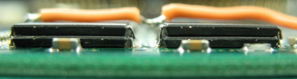

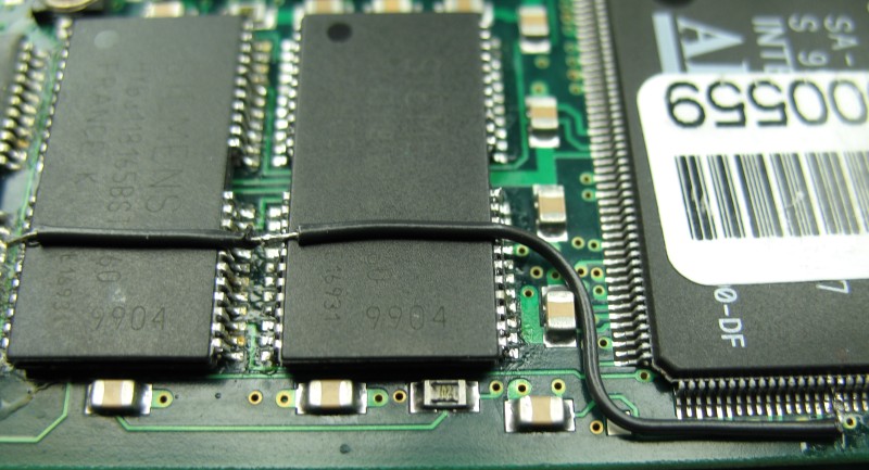

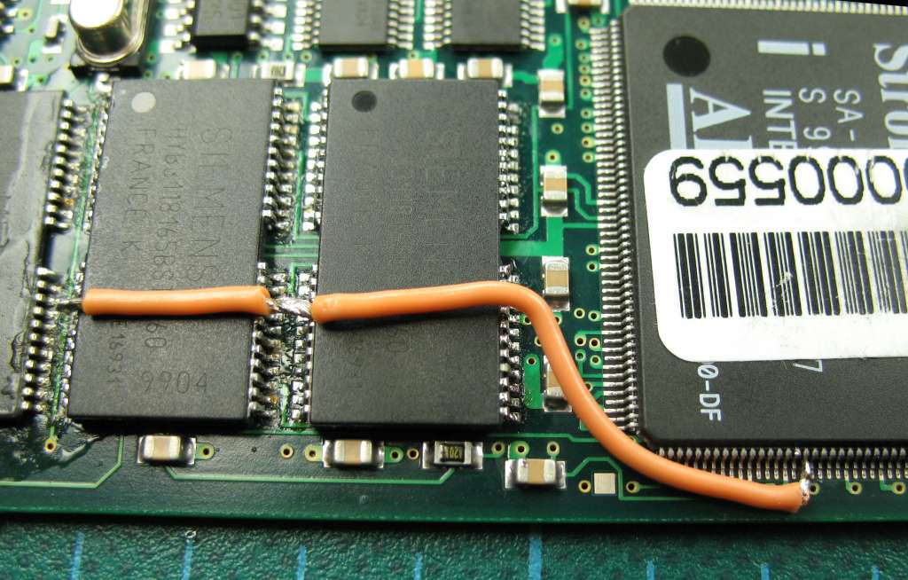

I took the plunge tonight. Worked first time! Talk about difficult...

should have used thinner wire and cleaned the fluxoff with alcohol

The flux's ok... my player came with flux covered chips from factory and has been fine for years. smile

Nice job! Funny how close-up photos make the wire look HUGE. smile
But I would followup on the suggestion to gently swab the area with a Q-tip or three dabbed in alcohol.

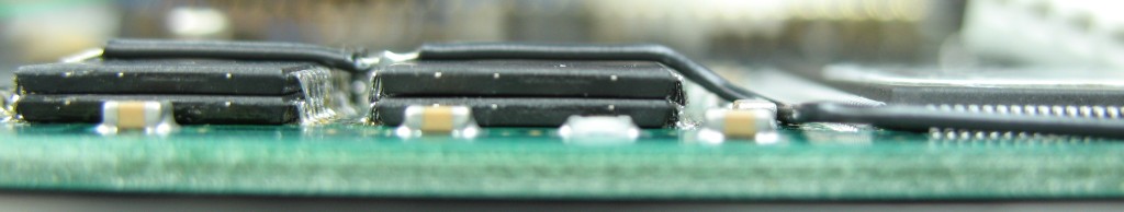

RAS lead replaced and on the hunt for some isopropyl alcohol. Thanks for your comments.

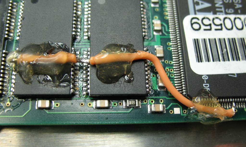

remember to fix the wires with hot melt glue...

Yup! wink
