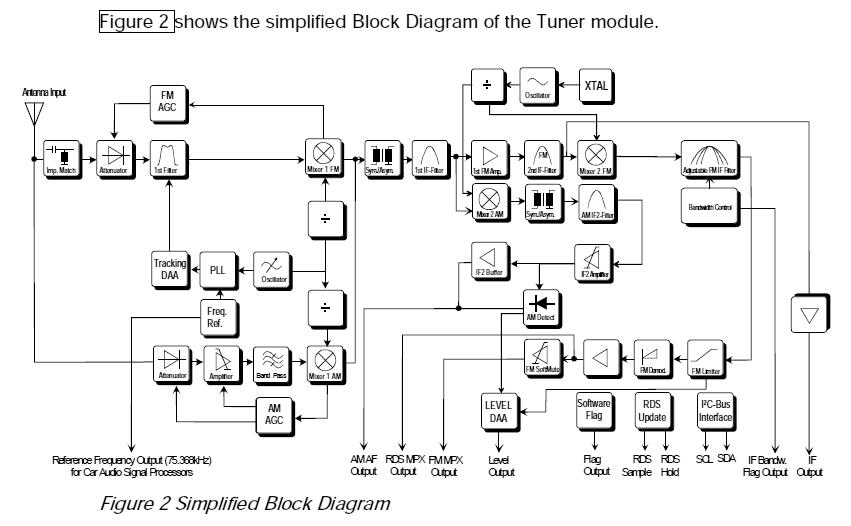

#322470 - 21/05/2009 13:56 Re: Need help diagnosing tuner problems [Re: benjammin]
Posts: 14531
Originally Posted By: benjammin
I'm gonna crack open my tuner and take a look asap. THAT could definitely be the failure mode I'm dealing with right now
Open up the radio, but not the sealed RF tuner module. Instead, you can probe on the pins from it to see if this is really the problem or not.
You'll have to poke at the datasheet for the RF module (microtune 1384 ufc/wfc, or 1385 ufc) to see which pins mean what, but I could get FM audio from an earlier output when probing around the dead component.
Eg. on the 1384wfc, pins 15-18 -- one of those had (muxed) audio, but the final output did not. Thus the failed component was between those two pins, whichever two they were.
Edited by mlord (21/05/2009 13:59)
#322471 - 21/05/2009 14:02 Re: Need help diagnosing tuner problems [Re: mlord]
Posts: 14531
In this block diagram of the sealed RF-Module, you can see what I mean.
The Level output had (scratchy) audio from FM, but the final FM/MPX output had nothing. Nothing on the RDS/MPX output either. So the failed component was therefore the FM-Demod stage, or the op-amp immediately following it.
Description: 1384wfc

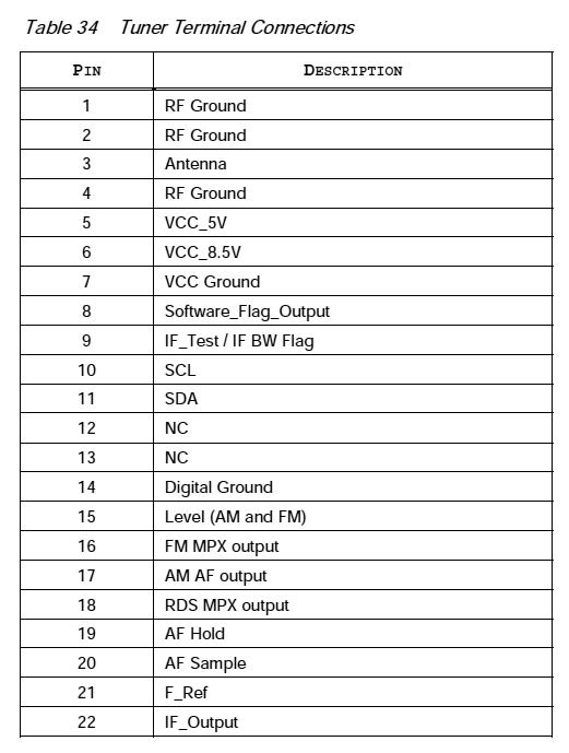

#322482 - 21/05/2009 17:10 Re: Need help diagnosing tuner problems [Re: benjammin]
Posts: 14531
I have the 1385 unit.
Ah, well then, all you need is the above diagram, and the pin-out list:
Description: 1385 pin-out.

Anyway - From what I can see, my pinout is different from the one you provided Mark. (although I appreciate the post)
Is there a thread on here that describes the operation of the radio module (as a whole) with the tuner module? I see the tuner is I2C based.. and I see the radio PCB has a PIC16C73B on there. What's it's purpose?
From what I can tell, there's no (with Mark's info and what I'm seeing on this IC) that there's no L/R output for Stereo. So I'm guessing that's being done elsewhere...
I'd love to hear some expert info since I'm just tearing into this for the first time.

Mark's pinout is for the tuner module and not the chip inside.

#322583 - 26/05/2009 15:15 Re: Need help diagnosing tuner problems [Re: benjammin]
Anyway - I see now.. the 1834/1385UFC (what I have) has 16pins
while the -WFC module has the >16pins...
I've not got a tuner module handy at the moment but the PCATS tuner construction manual shows it having a 1385UFC 3x0197 that has 22 pins...
#322585 - 26/05/2009 15:21 Re: Need help diagnosing tuner problems [Re: tman]

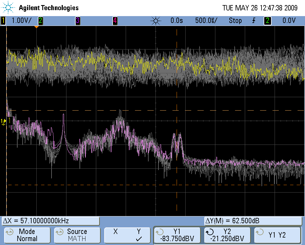

#322590 - 26/05/2009 15:56 Re: Need help diagnosing tuner problems [Re: tman]
benjammin
Registered: 11/08/2002
Posts: 189
Loc: Champaign, IL
Wow - so there's no rhyme or reason. Nice.
Well -- I'm gonna crack out my Comm analyzer next, but the prelim numbers from a really strong nearby station show me:
Audio @ FM-MPX: ~1.5Vp-p (sounds good - manual lists 75KHz=606mV (I'm assuming peak and not p-p))
Level Output: 3.43V (how many bars does the empeg show that as? and I'm assuming that's reported by the PIC on the Tuner Module? and the 1384ufc datasheet states 0-7VDC for the range with 3.3V = 100uV )
If I turn on the scope's FFT, I show the S/N being pretty darn good. (It's fun looking at the spectrum of an FM signal)
When I get my comm analyzer hooked up, I'll edit this with a real SignalIn = Level reading.
Description: 1835 UFC - FM_MPX Output
#322630 - 26/05/2009 19:10 Re: Need help diagnosing tuner problems [Re: tman]
Posts: 14531
Yeah, the PCATS radios use RF modules with more pins than the factory tuners -- a superset of pins, actually.
And there's some mislabelling somewhere for the factory modules -- I seem to recall that the number on the module doesn't match the datasheet number/name.

Ok, then... it seems my tuner module is working ok. It's putting out voltages on Level pin that make sense for a given input.
(i.e. it's maxing out while my display still shows no bars of signal.)
So if the PIC is reporting that level via serial port, something broke there.
If the receiver is reporting the signal via I2C -> RS232, something's broken there.
I'm going to solder my receiver back in more fully. laugh
-Ben

#322764 - 29/05/2009 01:09 Re: Need help diagnosing tuner problems [Re: benjammin]
Posts: 14531
Dunno. I think all of that is closed source, inside the player application. I think.
#322766 - 29/05/2009 02:41 Re: Need help diagnosing tuner problems [Re: mlord]
It seems pca would be the one to ask.
From his tuner kit manual, there is a signal wire and a level wire going back to the empeg. I've been meaning to see if I can defeat the signal strength meter with this wire.
#322778 - 29/05/2009 10:30 Re: Need help diagnosing tuner problems [Re: larry818]
Posts: 14531
Oh, well in that case, if the level wire goes all the way to the empeg, then it must connect to the saa7705h DSP chip. The datasheet for that will describe where it goes from there, and it undoubtedly is readable from a DSP register.
EDIT: from perusing the datasheet, it seems that the FM level info gets rolled into a noise measurement that can be incorporated into the RDS data, which is read out and processed by the player app.
Edited by mlord (29/05/2009 10:42)

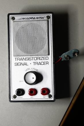

#322781 - 29/05/2009 10:49 Re: Need help diagnosing tuner problems [Re: mlord]
Posts: 14531
What I think you should do for diagnostics here, is to temporarily route the level output of the RF module to the radio in place of the MPX output, thus bypassing the part of the RF module which usually goes bad.
If you can hear (tinny) proper sound instead of just noise with that, then we know it's the usual component failure inside the RF module.
I use a small portable amplifier for that here, just touching the probe (amp input) to the level line, and then to the mpx line, and then back again.. and so on, to compare the two outputs.
Description: Small amplifier used for probing..

That's just it - I get audio just fine... it's only the signal bar that shows on the display that tells me I have no signal.
BTW, I LOVE that signal tracer. Very funny. (and simply practical)
My scope shows me nice hot outputs that completely correlate to the datasheet for the tuner module.
watching the RDS MPX is fun too. I had an RDS decoder around someplace.. I wonder where I put it.

#322812 - 30/05/2009 00:57 Re: Need help diagnosing tuner problems [Re: benjammin]
Posts: 14531
Ah, okay then!
Next, find the level-input pin on the DSP, and see if the signal makes it to there all of the way from the radio.
And, yup, check those connectors! smile
#322824 - 30/05/2009 23:06 Re: Need help diagnosing tuner problems [Re: mlord]
benjammin
Posts: 189
Loc: Champaign, IL
Ok, from what I can see so far, the Level output runs to an LM258 Op-Amp and then to one of the Analog inputs on the onboard PIC16C73...
shocked
UPDATE: I do see something that looks like it mirrors the level output on one of the empeg pins. (shaking head) Need to trace further. But because there is only 7 pins in use (one socket is empty) that makes:
So that leaves:
PWR, GND
TX, RX
FM-MPX
AM-Audio
Level (AM/FM)
So now where does RDS fit in? laugh
-Ben
