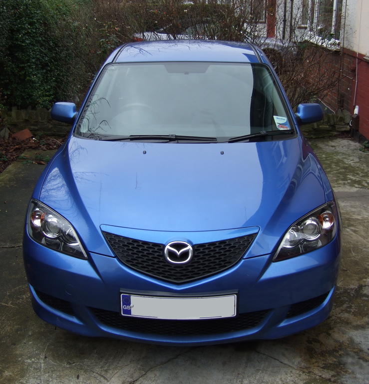

Treated myself to a new ride last month - now have a 2005 Mazda 3 1.6D TS Hatchback in Winning Blue smile Its pretty cool! Driving around for a month with its CD Player was pretty annoying though, so it was my patient for last weekend.
Description: This is the car!

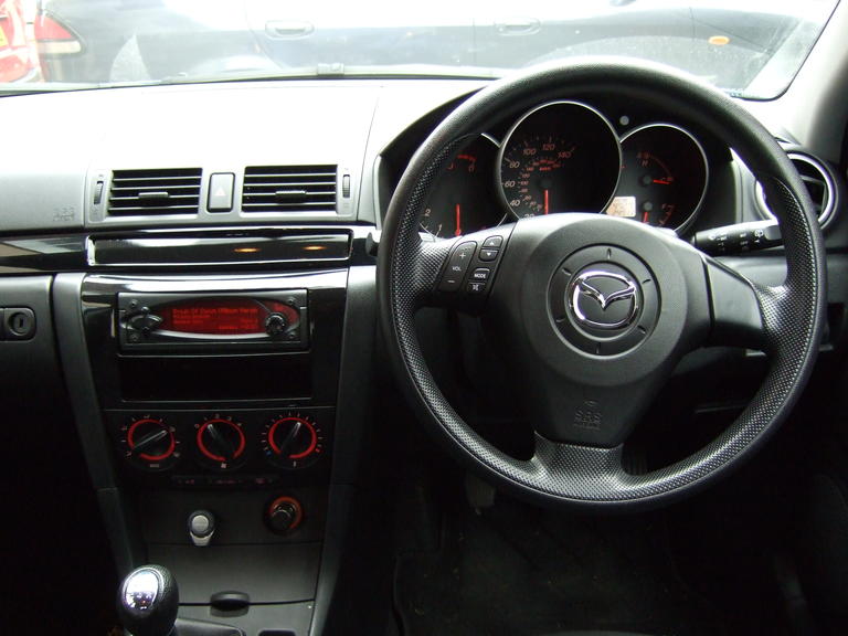

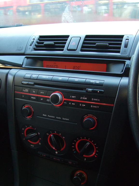

Description: This is what I have to work with. The display above the CD Player displays the time, CD/Radio info and outside temperature - its attached directly to the headunit. Its going to come out.
Description: It looks really cool with its red lights, knobs and stuff. The challenge is to make my Empeg look as good as this - the dash kit is boring black matt plastic, so I'm having a friend spray it gloss to match the trim.

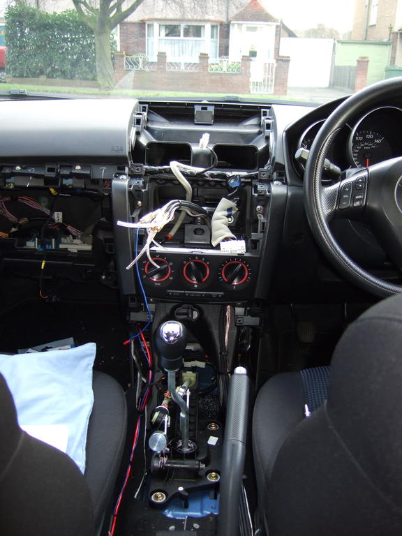

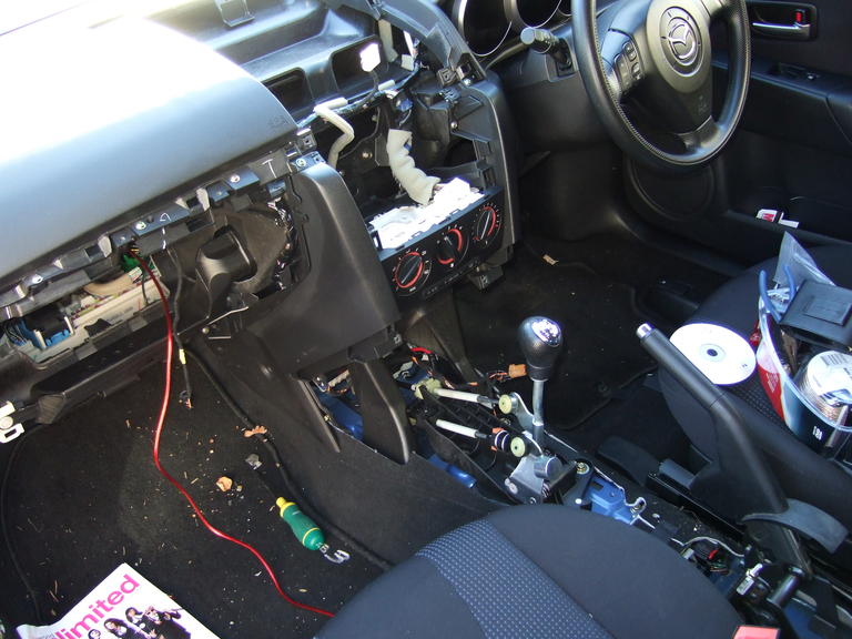

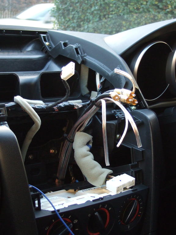

Its pretty amazing how easy it is to take this car apart. The trim pulls out. The glovebox comes out with two screws under the trim and quite a few pull out clips. The stereo is only held in with two screws. The vent panel is just two screws and a few pop clips. The whole center console is only held in with about 4 screws, and the cupholders ashtray etc just pull out.
Description: The glovebox and trim is out so I can run my amp power cable through the factory firewall to the battery.
Description: When you get something that looks a little like this, you have to think about whether you actually know what you're doing lol.

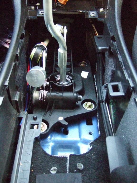

Description: Those cables are run down the center console to the back. Power on the left, audio cables on the right.

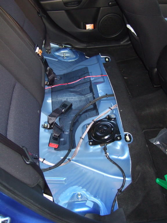

Description: Those cables come from the center console, under the carpet and under the back seat.

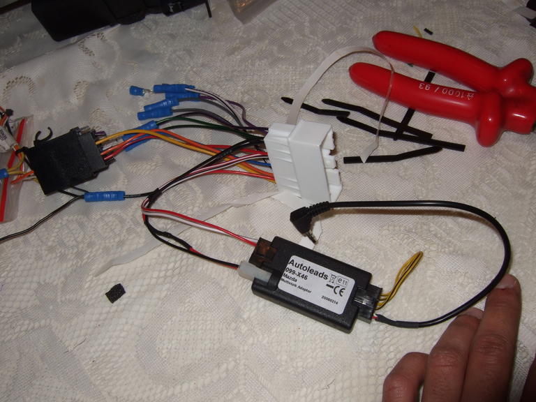

I am using the Autoleads PC99-X46 Mazda -> ISO adapter with 'Multistalk' interface. This connects up to the Autoleads PC99-SON 'Multistalk' adapter patch lead for Sony headunits. It even mentions RM-X2S and RM-X4S on the packet. Looks promising!
Description: This is the Autoleads loom that I've chopped the speaker input ISO connector off and replaced with crimp terminals. These will connect up to the output speaker cables from the amp. You can also see the little Autoleads steering wheel control adapter wit

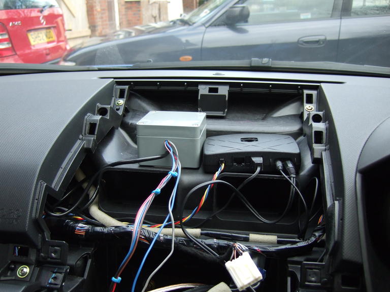

Description: This is a nice spot for my Bluetooth car kit box and PCATS tuner. Held in place with some surprisingly strong sticky back velcro from the one pound shop!

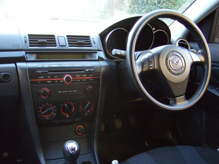

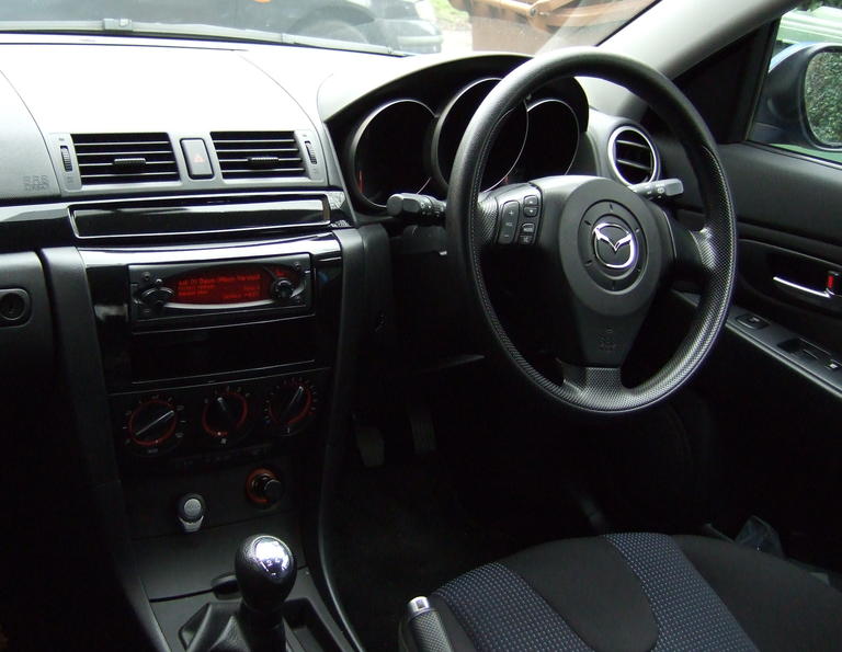

The dash kit I used is the 'Metra' kit available in the UK labelled as Autoleads. It normally looks boring with its cheap plastic, but I'm really happy with this shiny painted finish, the photo is lame and doesn't do it justice. The dash kit has a pocket to replace the display which I thought looks quite ugly. A bit of plastic was carefully cut to the shape of the hole and glued onto the hole of the pocket. This was sprayed gloss black. It looks good, but if anything it might be too much black. Its also hard to get a perfect finish on a small part. I may change it later.

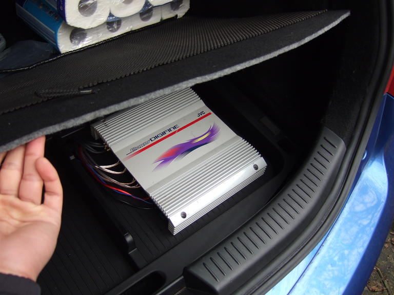

The car has a factory fitted tray under the boot floor where my amp sits, and the cables naturally end up after running under the back seat. There are luggage hooks bolted to the chassis inside the boot and these make pretty handy grounding points.
Description: All right, its all in now. Looks a lot better in real life, the paint on the dash kit is really flawless and matches the trim perfectly.
Description: Drivers eye view.
Description: The standard tray under the boot floor was crying out for me to install my amp in there. Drilled a 38mm hole in it to feed the cables through and some holes to mount up the Amp with some nuts and bolts that I had around. Got to love it.

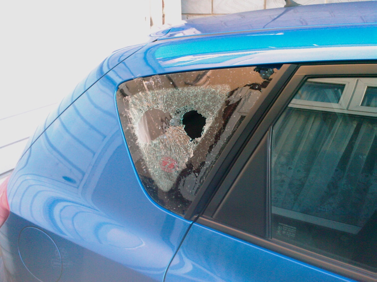

But it seems that the local inbred crack smoking chav scum are curious.
Oh the joys of North London. Busted my rear window, maybe trying to open the door handle from the inside (?). Didn't manage to open the doors or take anything. Hopefully they have now realised that I have deadlocks and use them (click the remote twice - Euro spec only I think).
The alarm in this car is a piece of junk. The siren is in the boot and sounds like a beeping watch from outside because of all the soundproofing. Why they don't hook it up to the nice dual tone horn, I don't know.
Anyway, a Toad 125dB 6 Tone Siren is on its way, and a Toad GSM Text Alert is here so hopefully fit that tomorrow. Yes, the Empeg comes with me when I park.
Assholes.

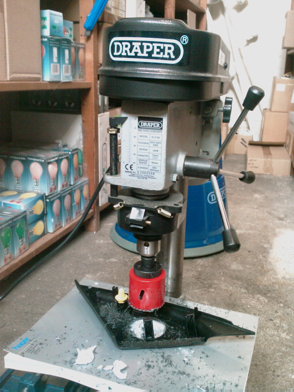

#307159 - 11/02/2008 19:11 New Speakers! [Re: sein]

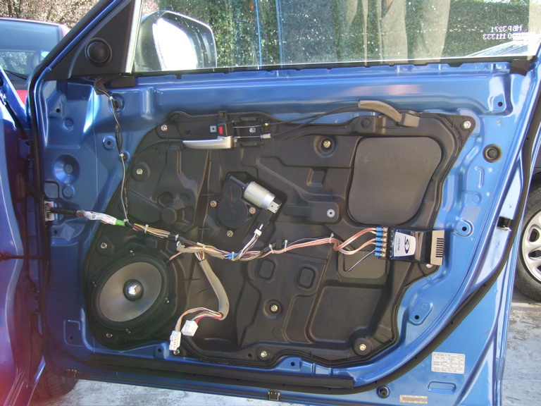

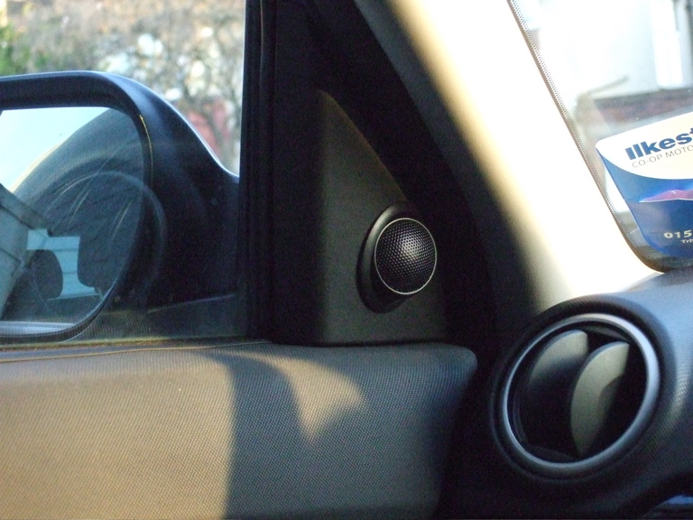

Finally got around to throwing out the standard speakers in my car. It really was about time, the more I listened to them the more I hate them! I went with a set of Alpine SPS-571A components.
Drill some holes. I'm a sucker for the stealth look, the tweeters gotta be flush, yo.
Installed and all wired up.
Man, these things are great! Sounds so good now, I listened to vocalists all the way home and drove slow so I could hear more! Oh, I just feel like going to sit in the car for a bit now lol. After a little bit of tweaking it really sends shivers down your spine.
Description: Drill holes
Description: All wired up
Description: Tweeter
