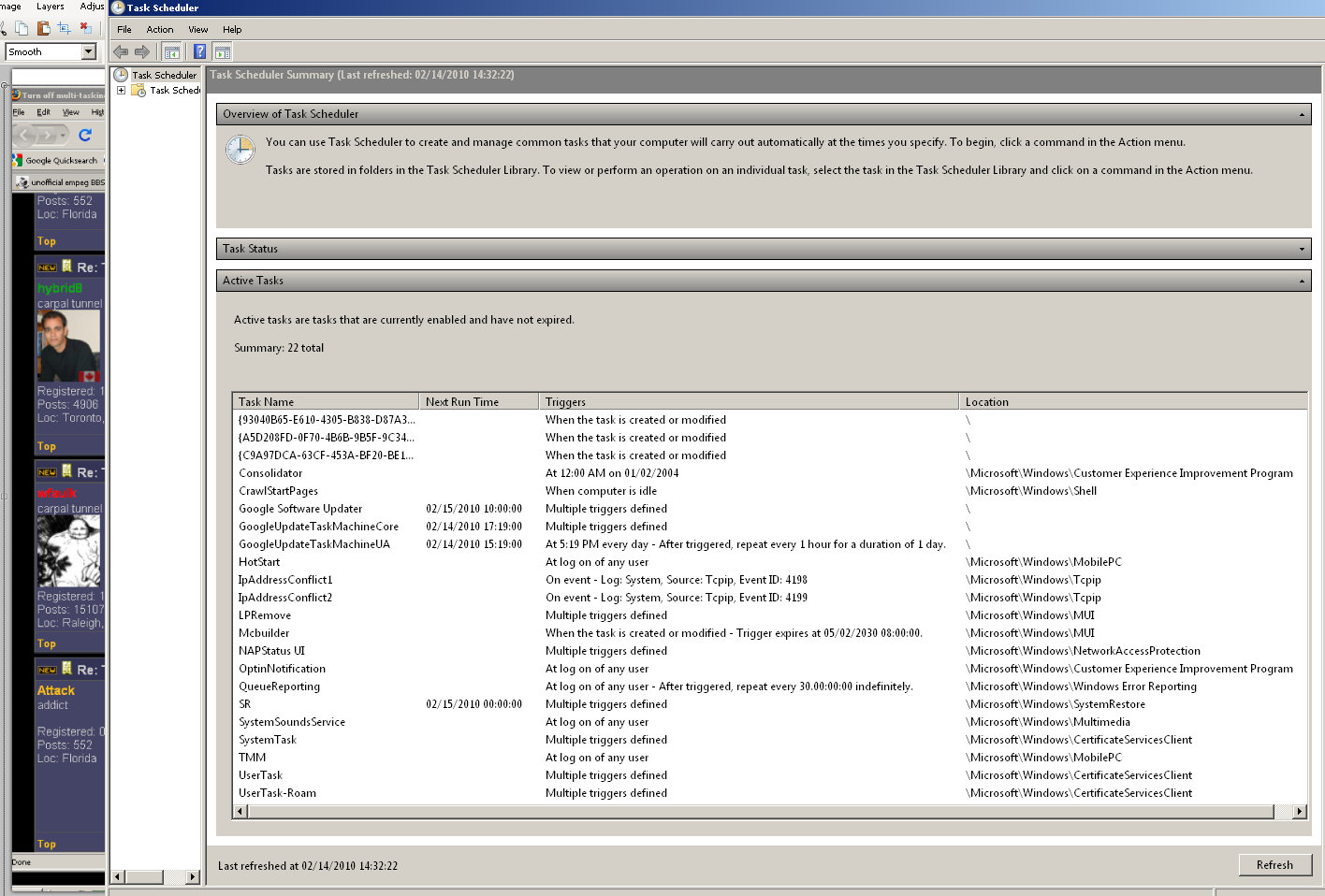

#330107 - 14/02/2010 21:18 Re: Turn off multi-tasking? [Re: tanstaafl.]
Ugh. Google Update. Now there's a piece of software that Google installs without your permission.

#330110 - 15/02/2010 03:08 Re: Turn off multi-tasking? [Re: Dignan]
Doug was showing the Task Scheduler. Heres a link to his attachment to view it full size.
#330111 - 15/02/2010 04:21 Re: Turn off multi-tasking? [Re: Dignan]
get a new PC that will handle this stuff better

One thing that did work beyond my expectations was increasing the priority. As an experiment, I set the priority to "Realtime" and ran 44% more simultaneous audio streams than I had ever successfully run before (increased from 18 streams to 26) and had a flawless conversion. (This was with virus scanning temporarily disabled.) Now perhaps I was just lucky and no other processes started up during the run, but this is definitely something I will try again.
#330112 - 15/02/2010 05:53 Re: Turn off multi-tasking? [Re: tanstaafl.]
Ahh, that's right. Couldn't tell from the severely resized screenshot.
