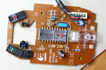

SWMBO & I use pretty much identical mice on our machines. Her's has a nice ladybug motif, whereas mine is boring Logitech silver. But mechanically and electrically they are the same Logitech M-UV69a/55a USB mouse.
And oddly, both of them wore out within days of each other. The left mouse buttons got bouncy and jittery, making use of Thunderbird much more difficult.

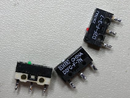

We like the mice, though, and see no reason to spend money on replacements. So into the junk pile of disused old serial and PS2 mice, for fresh micro-switches:
Description: Guts of one of the two mice.
Description: Microswitches.. all very similar. The middle one is one that had died; the others were culled from older, less used Logitech mice.

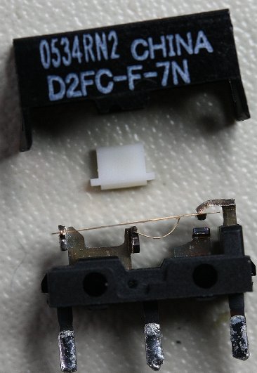

#330169 - 17/02/2010 18:02 Re: When good mice go bad. [Re: mlord]
Inside a failed microswitch.
Description: Inside a failed microswitch.

#330272 - 20/02/2010 14:15 Re: When good mice go bad. [Re: Shonky]
I doubt that contact cleaner would have had any effect whatsoever on the non-springy spring that was 75% of the the problem. smile
Mind you, I've kept the original worn switches, and can always "refurbish" those as needed in the future, where "refurbish" means (1) bend the spring back into a spring shape, and (2) remove the oxide from the switch contact.
