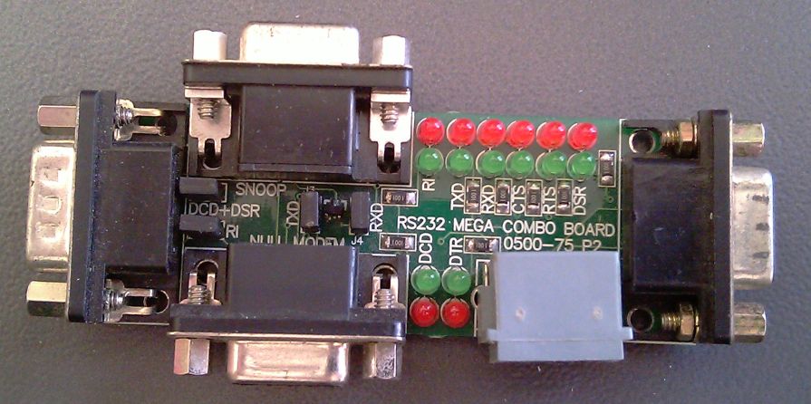

Always handy to have something like the picture for serial debugging. It's immediately obvious which signals are being driven. It's something I knocked up at my older employer since we did a lot of serial port interfacing. Can't seem to find anything similar online. For a once off it's not worth it but always good to have around.

I still have a commercial RS232 adapter hanging around that pulled out the pertinent pins to LEDs and provided a few switches for you to make the proper changes while it was all hooked up. That thing was a godsend back in the day. I even got to the point where I could usually tell what the data rate was based on the blinking, or, failing that, what the line noise looked like.
#335146 - 19/07/2010 21:36 Re: Serial programming woes [Re: wfaulk]
Yep. I could often work out in seconds what would take ages to sort out with oscilloscopes etc. I know what you mean about baud rates too - you could at least get a basic idea if it was right.
It also had a snoop function (TX, RX or both if half duplex), null modem, RS232D (RJ45) all in one as well as the pass through. About the only thing it couldn't do was RS232D to RS232D but simply two of them joined did the trick then.
Otherwise called a "Christmas tree"...
