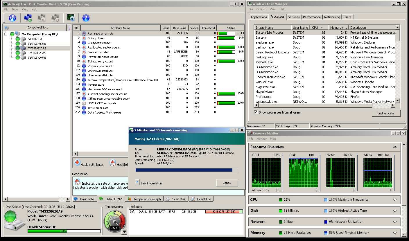

Running backups overnight, the backup program slowed and finally quit ("program not responding..."). A little bit of experimenting seemed to show that any program with high disk I/O exhibited similar behavior.
The first attached screen shot seems to point toward the cause of the problem, but I am beyond what little bit of expertise I have in these matters.The shot was taken copying C:-->M:, but the failure actually occurred while copying F:-->L: which would suggest that it isn't a problem with a specific drive.
Is this as serious as it looks? MEMTEST.EXE showed zero errors after running for an hour.
The second screen shot shows what things look like when the backup application stalls. It looked pretty much like this for about five minutes before I captured it.

#335815 - 05/08/2010 14:18 Re: Memory problem? [Re: tanstaafl.]
Depends on what you think it looks like.
It does not mean that your memory is faulty. In this context, "fault" means that the information that was requested was expected to be in RAM, but wasn't, because it had been paged out to virtual memory on disk.
It does mean, however, that you have less RAM than the processes you're running concurrently need. It still works, nominally, because the OS is able to move data from RAM to disk when it needs more RAM for something else, but a hard drive is many orders of magnitude slower than your RAM.
This is normally not a big deal when you have multiple programs running concurrently when they're not really doing that much all at the same time. (For example, if you have Photoshop open with a huge image, it's okay for it to page all that memory out to disk when it's not being used, because you're doing something else. When you get back to Photoshop, it'll just pull it back into RAM and page out what you had been working with.) But when processes all actively running at the same time need more RAM than you have, it starts using the hard drive as intensively as it uses the physical RAM. Or tries to. And it's incredibly slow.
So: run fewer programs or buy more RAM.

A backup program should not cause a machine to run out of RAM and slow to a halt. Something else is going wrong here, something OS-related or software-related.
That's what was confusing me. I can't imagine how you're running out of ~3.5GB of RAM when you're not even using the computer. At the very least, I'd imagine that a decent backup program would give you the option to use fewer system resources.
About 2.7GB (if I'm reading it right -- it's quite small) is being used for caching. This is expected; Windows Vista (and 7) aggressively use memory for caching.
And, as Peter says, those page faults could well be caused by memory-mapped I/O. This is perfectly normal.
You've got the memory and nobody is using it so the OS might as well use it to cache files. If an application does need that memory then it'll get released and allocated.

He's got the maximum possible memory for a 32-bit system, and this is an overnight backup
Oooh. He's got so much RAM that no one process can map it all (unless both the sysadmin and the process jump through hoops). Perhaps the backup program is sizing its buffers by system memory size, and running out of address space in MapViewOfFile? Is it possible to tell Windows to boot with only 2GB of RAM and see whether the problem goes away?
Alternatively, take a look in the Processes tab in Task Manager and see if the "VM Size" of the backup program grows endlessly, until it reaches 2GB and things start failing.

I notice in the images, the minimum page file size is only slightly larger than the amount of ram being currently used.
I know this isn't XP, but Windows XP was always a little flaky when it was allowed to manage the page file size. My system would always grind to a halt when XP decided to expand the page file size. The fix was to make the page file bigger, and make the min and max sizes the same.
