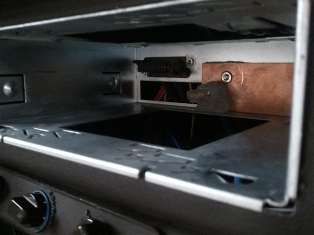

#345219 - 18/05/2011 00:04 Re: Squeezeslave running on Empeg [Re: tfabris]
presslab
Registered: 29/07/2008
Posts: 73
Loc: North Bay, CA
Thanks again Tony, the hot glue worked great!
Description: Dock blind mate Ethernet
#345223 - 18/05/2011 02:58 Re: Squeezeslave running on Empeg [Re: presslab]
If that's in the *car* be careful, because the interior of some parked cars gets hot enough to melt hot-melt glue. I know from experience. If it's just indoors, though no worries.
#345224 - 18/05/2011 03:49 Re: Squeezeslave running on Empeg [Re: tfabris]
presslab
Posts: 73
Loc: North Bay, CA
Yes, that's in the camper. I looked at the hot glue sticks and apparently they are of the high temperature 380 F type. I'll take my chances, thanks for the heads up though. At least hot glue isn't as bad to remove as other glues. smile
I am able to get the Ethernet to work on my gigabit hub but when I plug direct into the server the link light is lit but no data is received. It is an Auto-MDI/X (gigabit) port so I should not need a crossover cable, but I'll try that next. I know the Empeg is a bit finicky with it's 10baseT port.
#345250 - 19/05/2011 14:14 Re: Squeezeslave running on Empeg [Re: presslab]
That's exactly right: Its 10baseT port is finicky. There are documented accounts where doesn't get along with some 10/100 switches, and probably plenty of anecdotal evidence that the same might happen with gigabit switches. You sometimes need to put a cheap-ass hub in between the 'peg and the faster switch to get it to work.
#345268 - 20/05/2011 05:50 Re: Squeezeslave running on Empeg [Re: tfabris]
My mk2 and mk2a definitely work with Netgear GS108 GigE switches.
#345271 - 20/05/2011 12:03 Re: Squeezeslave running on Empeg [Re: Roger]
presslab
Posts: 73
Loc: North Bay, CA
Well, it was through no fault of the empeg that the Ethernet wasn't working. My Iomega iConnect that is my music server needed some patches applied to the kernel in order for the Ethernet to work at any speed other than 1000baseT.
Using a straight-through cable now works thanks to the Auto-MDI/X on the server and it connects at 10baseT half duplex.

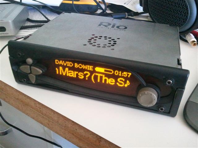

#345999 - 27/06/2011 03:12 Re: Squeezeslave running on Empeg [Re: Roger]
presslab
Posts: 73
Loc: North Bay, CA
For now I'm just saving the EQ data after running 'player' to a file and reloading it on startup. Not exactly user friendly but it works.
It's pretty far along now!
#346005 - 27/06/2011 08:52 Re: Squeezeslave running on Empeg [Re: presslab]
This looks great! Are you thinking of making it available once you've got it fully working ???
