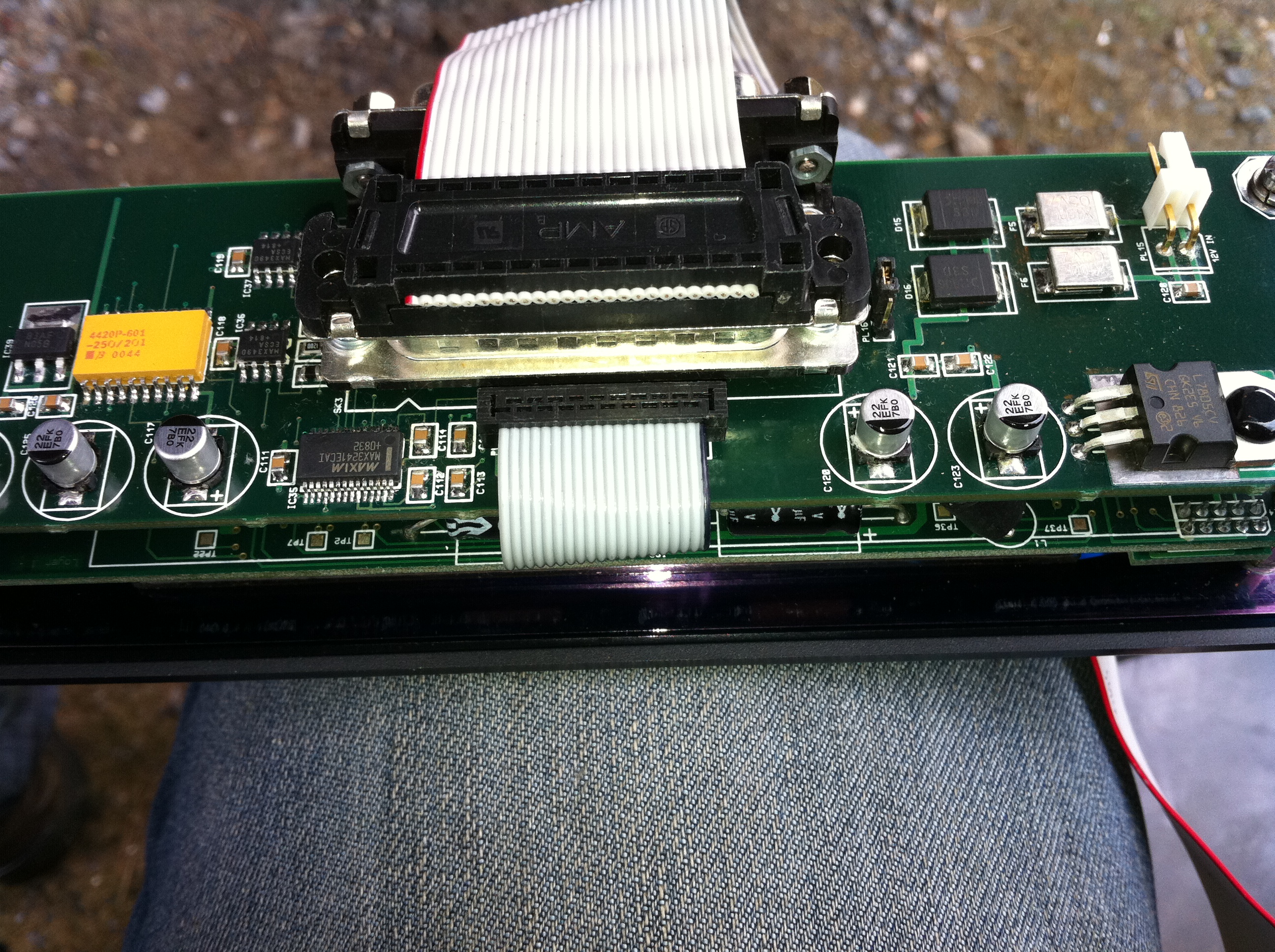

I have the extender board installed, and when I disambled it to test a new placement of the display unit, I accidently put the flat cable connecting the new board to the old display board the wrong way. I also turned the power on, not realizing the error.
It didn't work - and it doesn't work even after fixing the error.
Is it possible to fix it, or is my 11 year old empeg dead?
See the picture to see the cable (it's the small one of course)
Kyrre

Fuses.. fuses.. tiny little surface-mount fuses near the display header. See if you can find them in the FAQ.

Thank you for the claryfication. I have actually replaced this fuse once before. I think it was Rob (not Schofiel) who sent a couple me - but I cant find the last one.
The Digi Key website is out of stock.
Anyone able to sell a couple of fuses to me, og can provide a link to a product page with the correct fuse? Lot's of simular fuses smile
Is this the one: https://www.elfaelektronikk.no/elfa3~no_no/elfa/init.do?item=33-240-11&toc=20515
