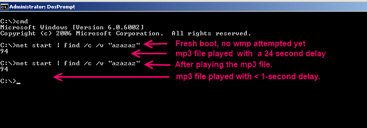

Doug, if you want an easy way to test the services theory, we can try something at the command prompt. Do this after a clean boot, and after the system seems to have settled down.
Before you start Media Player for the first time, run this command:
net start | find /c /v "azazaz"
That command should return a number. Then fire up an MP3 to play, and run the command again, see if the number changes.
net start is outputting what services are currently in the started state. We then pipe the input into the find command. /C is search for a string and count how many lines contain it. /V inverts the search to count how many lines the string did not appear in, then "azazaz" is a garbage string. The end result is counting how may lines of output net start generated each time. If the number goes up in the second run, it means services were started that were in a manual state. To remove the delay the first time a song is played, you could then track down whatever service it is and add it to the automatic startup setting.
On a Windows 7 VM, I had 60 as the pre MP3 number, and 61 when Media Player opened.
Code: net start | find /c /v "azazaz"
O-kay...
#346767 - 04/08/2011 20:10 Re: WMP peculiarity [Re: tanstaafl.]
Hrm, there goes the services theory. Though just to be clear, that first 94 was before you clicked on the .mp3, after a clean boot? That second arrow pointing at the first 94 makes it a little unclear.
Correct. (1) Ran netstart. (2) Played the mp3 file (with delay). (3) Ran netstart again. (4) Played mp3 file without delay.

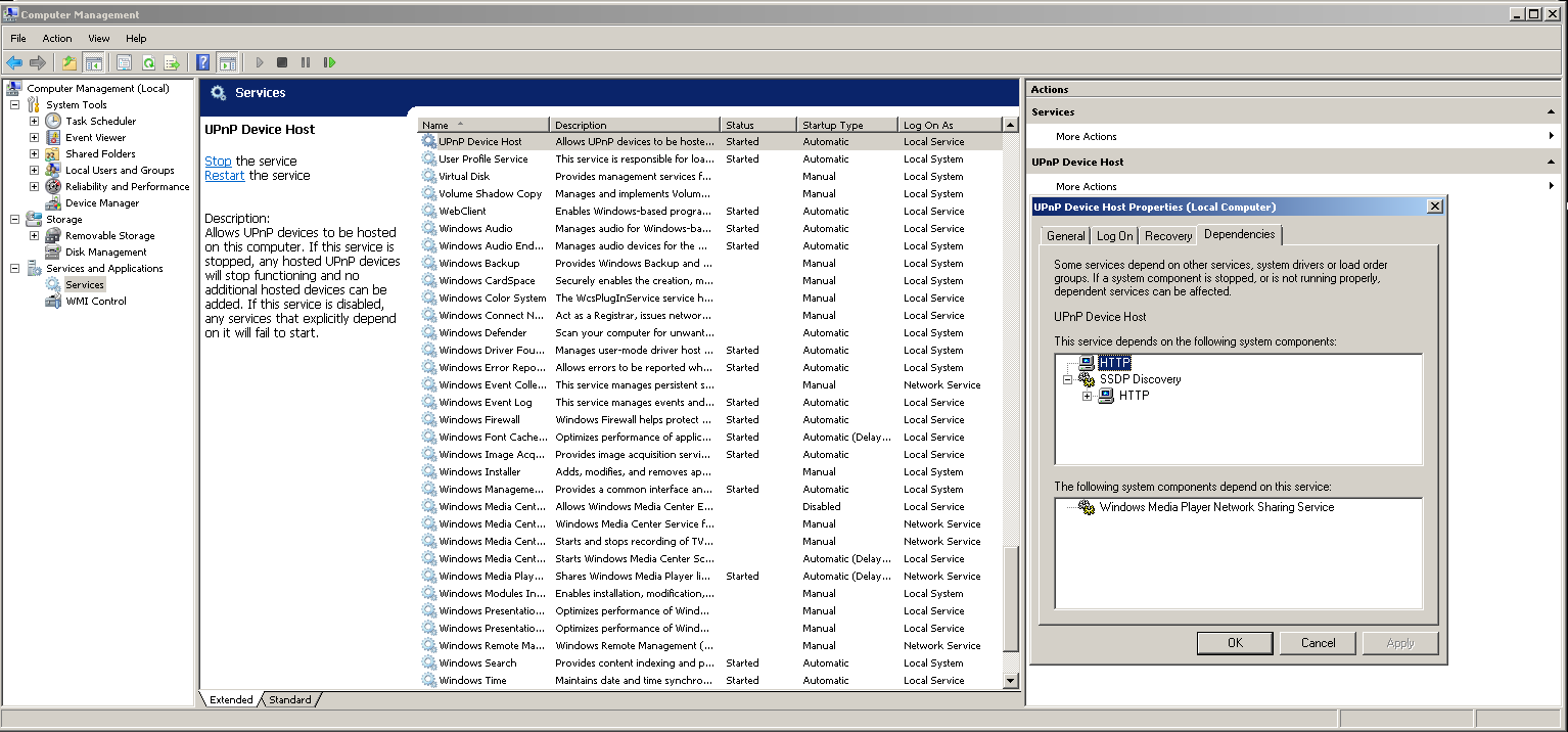

Windows Media Player was starting a service called "UPnP Device Host". Can you check your services control panel to see if that service is set to manual, automatic or disabled?
Not sure how to do that. I ran MSCONFIG, and the "UPnP Device Host" shows up as "Running". I didn't start it up myself, so does that mean it is set to automatic?

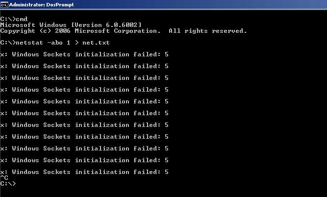

Code: netstat -abo 1 > net.txt
Didn't work out so well... (see below). I don't know what the x: is referring to, I don't have any such drive. My "network" such as it is consists of SWMBO's Macintosh connected via router, and as she is in Alaska at the moment her computer is turned off. Could that be it? Also connected to the router is my cable modem and Ooma VOIP phone system, but they don't talk to my computer.
The most likely culprit is my Tunebite program. It is a transcoder that sets up 28 virtual sound cards in memory, and transcodes up to 28 wma (or mp3) files simultaneously, playing them in 1:1 real time. However, it is NOT my default. My default audio source is a set of USB headphones.
The net.txt file grows pretty quickly, I shut it off after about two seconds and it still runs a couple of hundred lines. I've attached it along with the screen shot. If you want I can let it run longer. (The first time I ran it it came to 783K!) I didn't see anything too compromising in it, unless it has the URLs of my favorite porn sites. smile
The way I always go into Services is via a right click on My Computer (on the desktop, or the Computer entry in the start menu), and picking Manage from the menu. Services will be on the left, and then you can find the UPnP Device Host in the list on the right. Double clicking it will bring up it's properties, including if it is set to start automatically or not. Much like Bonjour, this is a service related to network sharing. If you have nothing that streams music from Windows Media Player, try setting the service to disabled to see if it has any impact.
Not sure what that error is about, as the output in the text file looked right. Lets try it again, but this time zip the file before uploading it. It will get large (and highly compressable), but what I plan to do is split it up and see what differences appear during the time it's loading. That will point to what network interactions (if any) is slowing down the first play. Also, make sure to close as many programs as possible before doing this. The last report showed Firefox open with active connections, so it pollutes the output a little bit.

#346803 - 08/08/2011 14:41 Re: WMP peculiarity [Re: drakino]
Oh... neat trick. I didn't know about that one!
Zip file attached. I let it run out to about 6200 lines. However, only 111 of the lines are unique, the other 6000+ are duplicates, including 180 "wmpnetwk.exe" and 330 "Can not obtain ownership information" lines, those two being the most popular. There, now that I've done that in-depth analysis for you, I'm sure the answer will be right at your fingertips. smile
