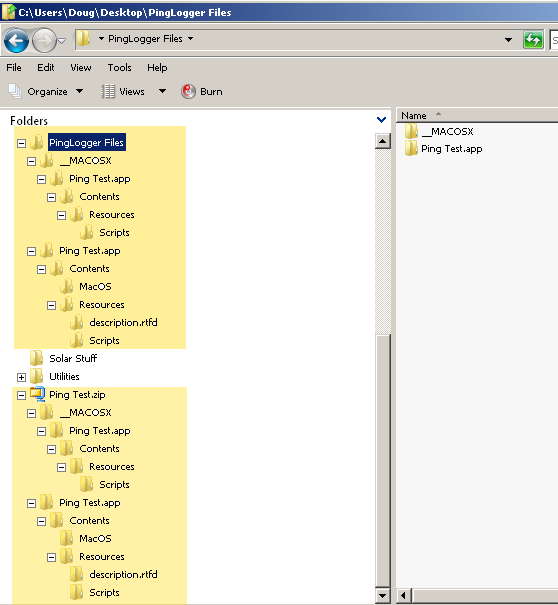

I must confess to being a bit confused here. When I unzip the file (on my Windows machine where I know [a little bit] what I'm doing, I get a directory named _MACOSX, and another directory named Ping Test.app.
The _MACOSX directory contains a directory named Ping Test.app, and a file named ._Ping Test.app. That Ping Test.app directory contains subdirectories...aaarrggh. See the attached screen shot! (Right click --> "View Image" to make it readable)
Anyway, just what am I supposed to put on the Evil Macintosh (tm)? My plan would be to put it on a flash drive, then copy it to the Mac's desktop and run it from there. Then, after a week or so stop the app, copy the output file (via flash drive) back to my computer where I can tweak it with Excel, where I very much DO know what I'm doing.
Keep in mind that I have only laid hands on a Macintosh thee or four times in my life, and then only under duress, so explanation will have to be basic and very simple. Don't assume I know ANYTHING about those evil machines. Remember my motto: If it's different from what I'm used to, it can't be any good. smile
#347473 - 16/09/2011 20:34 Re: Ping Logger [Re: tanstaafl.]
Mac applications are actually folders (as you have discovered by unzipping it on Windows). And the __MACOSX folder contains filesystem metadata for the files in the zip.
To move it to the Mac, don't unzip it on your windows machine. Just copy the ZIP to a flash drive, then unzip it on the Mac. Unzipping is built into a Mac, just double click it. Out should pop the Ping Test application, as a single file.
To "properly" install it, drag the app to the Applications folder on the Mac.

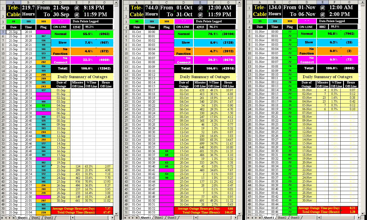

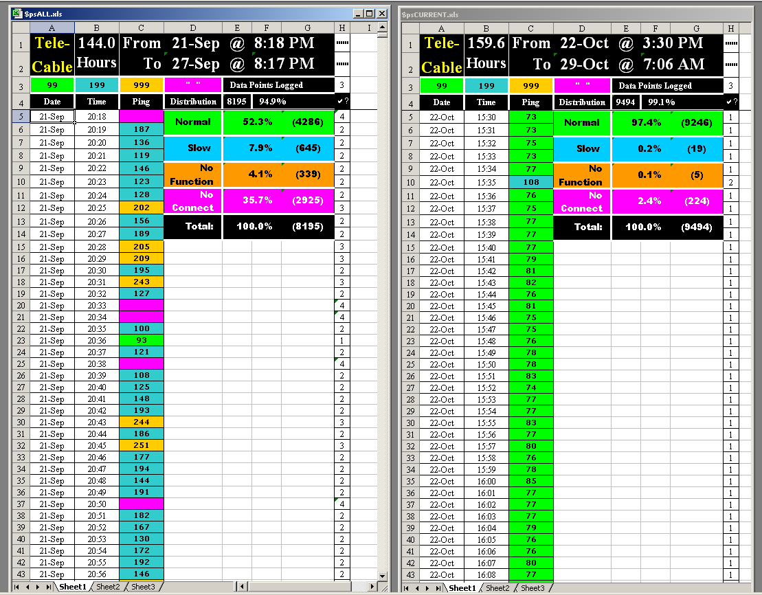

#347599 - 27/09/2011 11:01 Re: Ping Logger [Re: tanstaafl.]
Originally Posted By: tanstaafl
...CSV file of the first 12 hours, and it is pretty damning for my ISP.
I have now accumulated four and a half days of data, and my internet connection has been either unusable (so slow that web pages time out while loading) or completely non-existant (ping refused because of no connection) for 41.34% of the time. Even in Mexico I suspect that this is non-optimal performance. smile
I got lucky yesterday. I consolidated the most recent 40 hours of data onto four pages, multi-columnized with six hundred ping records per page, all conditionally formatted to color-code the four different statuses of connectivity: "Normal", "Slow", "Non-Functional", and "No Connection". I took this to my ISP which is normally a useless operation because it is staffed only by two women whose combined English vocabulary is about 10 words (note: that is MY problem, not theirs. I live in THEIR country, and I damn well better learn THEIR language if I want to communicate!) and whose total technical expertise is to tell a client if they owe money and if so, how much. But as I said, I got lucky. Their one and only English-speaking technician happened to be in the office between service calls, and I was able to speak with him. He was very impressed with my colorful printout, and 90 minutes later he was ringing my doorbell. He thought that he and his partner had found a damaged cable on the utility pole by my house and fixed the problem, but I was skeptical. As it turned out, justifiably so. So they came inside, and they hooked up some kind of signal meter to the raw cable, checked all my connections (splitter/TV/computer/modem/router), and for no really good reason the internet came back. Hmmmm... today they are going to bring me a replacement cable modem, but I think they are just taking random shots at fixing the problem. The big news, however, is that the English-speaking tech gave me his personal cell phone number and told me to call him any time, night or day, if I were having internet problems. Now that is what I call service.
We'll just have to wait and see how it goes...
Edit: I forgot to mention that after the techs left yesterday afternoon, I had internet for about five hours, then it quit again for four hours, returning on-line at six minutes past midnight.
pingsmulti-column.xls (358 downloads)
Description: Ping log in printable format
Edited by tanstaafl. (27/09/2011 12:07)
Edit Reason: Additional info

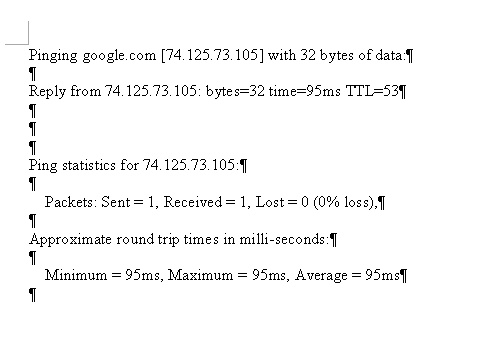

#347609 - 27/09/2011 23:40 Re: Ping Logger [Re: Robotic]
Hmm... I'm getting carriage returns between the temporary file insertions of the pings.csv file instead of getting each series on one line.
googling for some batch file how-to or help isn't quite doing the trick for me just now. I'm weak.
#347610 - 28/09/2011 00:01 Re: Ping Logger [Re: Robotic]
Easy enough to fix after the fact. Just open the CSV file in Excel and sort by date, time. The blank lines will sort to the bottom of the file and subsequent writes to the CSV will start at the end of the data.
#347611 - 28/09/2011 00:53 Re: Ping Logger [Re: tanstaafl.]
But you see, when I open the csv in excel, I get date and time in two columns of one line and three more lines in the first column:
date|time
loss
ms
If each compilation into the csv wound up on one line, I would have no issue with empty rows, but it does not.

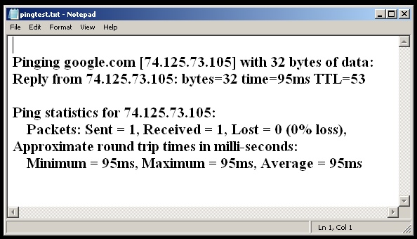

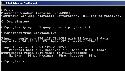

#347647 - 29/09/2011 22:21 Re: Ping Logger [Re: Robotic]
Hmm... I copy/pasted that directly from Notepad into empty code brackets, but there are twice as many carriage returns shown in what I've pasted.
The text in Notepad looks like this-
That may be something that Notepad does.
Here are three screen shots. The first is taken at DOS after the ping -n 1 command, and then displaying the output file.
The second is what the output file looks like opened up in Notepad.
The third is what the output file looks like after copying in Notepad and then pasting into MS Word. This third file is also what it looks like when pasting from Notepad into the empeg bbs. (I deleted the superfluous line feeds from my previous post. blush
In any case, I don't think the extra line feeds in the display of the output would matter, because the way the batch script works is that it "finds" a line with a key word, then acts on it.
I've asked Paul if he has any ideas...
Description: Screenshot from DOS
Description: Screenshot from Notepad
Description: Screenshot from MSWord
#347650 - 30/09/2011 06:01 Re: Ping Logger [Re: tanstaafl.]
Posts: 5691
but that shouldn't matter down at DOS level.
It's not DOS.
#347651 - 30/09/2011 12:07 Re: Ping Logger [Re: Roger]
It's not DOS.
Yes, I know. I'll repeat the mantra: "There is no DOS in VISTA". But whatever it is is a good enough imitation to keep me happy. smile
#347658 - 30/09/2011 14:26 Re: Ping Logger [Re: tanstaafl.]
Yes, that was my thinking, too.
I was half expecting Excel to do a better job importing the data- especially when I specifically tell it to only mind the commas, but it's not been a successful route.
The good news is that on the grand scale of things, this issue is just peanuts. Kinda fun to dink around with, but nothing to really worry about.

#348593 - 29/10/2011 11:27 Re: Ping Logger [Re: Robotic]
Many thanks to Doug for sharing his trials and tribulations from the networked netherlands.
It took some patience and perseverance, but I did get some results.
My English-speaking tech was kind of a dead end. His job, and his entire focus, is working with cables, connections, modems, and routers. "If your only tool is a hammer, everything looks like a nail." His focus was on what he was used to fixing (noise in the line, bad connection on the pole outside the house, reboot the modem and router, etc.) and I could not get through to him that the problem was not local.
Why did I think this? Because even when pinging Google showed absolutely no connectivity, I could always ping the gateway IP address and get practically instantaneous (<1ms) returns, and the cable TV never faltered.
After presenting him with a several printouts demonstrating this, he turned me over to the engineer at the office. He had about the same amount of English as I had Spanish, so we were able to more or less communicate, and he found the printouts informative and intriguing, although for the first two weeks he was stuck in the same rut as the installer, looking for local fixes. He, too, gave me his cell phone number!
I don't know if it was coincidence, or if the engineer finally put pressure on upstream (where I believe the problem originated) but at 3:30 (more or less) on October 22, following a nine and a half hour outage, the internet came back on, but with a difference. The ping times which had been running (on the occasions when there were any pings at all!) an average of 50-60 ms, were now running 70-90 ms, about a 50% increase, but still perfectly acceptable. The big difference, however, was an increase in reliability, from about 50% when I started logging to more than 97% since October 22. It would be more than 99%, except there was a [probably] planned outage of 2.5 hours on October 25. Other than that outage, all of my glitches have been single, occasionally two in a row, lost packets scattered randomly maybe 10 times per day. I'm told this is normal.
My thinking is that there was a problem with some piece of equipment upstream from the ISP, evidenced by gradually increasing ping times getting up into the 300-400 range before total loss of connectivity; then sometime later, frequently at the top of the hour, the service would return rock solid (for a while) with pings in the 50's, then after several hours (sometimes just a couple, sometimes 15 or 20) the cycle would repeat.
I think someone, somewhere upstream, was being reminded by their watch beeping on the hour, and going to "check the line" and resetting something. Finally they either replaced a failing piece of equipment, or possibly changed the routing so the ping to Google.com takes some extra hops, which accounts for the 50% increase in ping times, and the huge increase in stability. Of course, this is just surmise on my part, based on invincible ignorance of how the internet actually works, but it seems plausible to me. smile
I am now pressing the ISP to give me six months of free internet service as compensation for several months lack of service (the problem was there for at least one month before I began logging, possibly more) and for the thorough documentation I provided. The engineer has agreed that this is reasonable, and said he would work on it. I'm not holding my breath.
Since I doubt that anyone here is interested enough in my tribulations to want to look through 51,618 data points (that's what I've collected so far) I am attaching a screen shot, showing just the statistics for the first week and the last week (more or less) of the data collection. And if there are any Excel freaks among you, I am attaching the Excel template into which I paste the CSV data from the PingLogger batch file. There are a couple of neat things in it, particularly cells D2 and F2, and the conditional formatting in column C. [Owww, my arm hurts from patting myself so much on the back smile ]
$psTEMPLATE.xls (211 downloads)

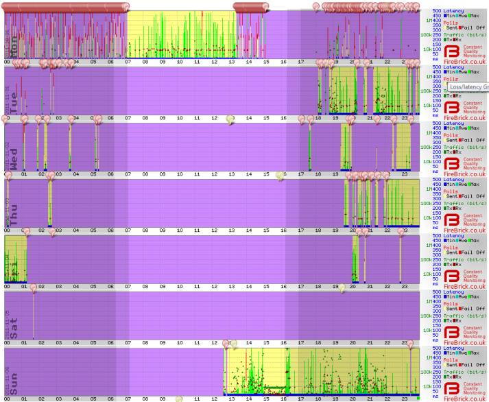

#348954 - 07/11/2011 08:25 Re: Ping Logger [Re: tanstaafl.]
Posts: 5691
Here's another screen shot (not that anybody is likely to care)
I can beat that frown
The purple is downtime.
Fortunately, a new router appears to have fixed it, for now.
#349056 - 09/11/2011 19:47 Re: Ping Logger [Re: Roger]
So exactly wtf happened there? New router at your end or their end?
#349062 - 10/11/2011 08:33 Re: Ping Logger [Re: altman]
Posts: 5691
Power notch appears to have killed my old router (but leaving it with enough magic smoke to appear to be working); I've borrowed a replacement from one of the guys at work until I get my FTTC upgrade installed (which requires a VDSL modem, rather than an ADSL2+ modem).
