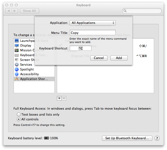

The keyboard prefs definitely don't appear to have this capability, and neither does the app I mentioned. I looked at keyboard prefs, and it doesn't appear, for example, like I can turn "control+C" into copy. Am I wrong?
Keyboard Preferences is the right place, perhaps a picture will help. See attached for setting Control-C for Copy in all Applications. This is taken from the "Keyboard Shortcuts" part of the Keyboard preference pane, Application Shortcuts, then the + button. The power of Keyboard Shortcuts is they can reassign anything that has a menu command, or even assign a shortcut if the app didn't provide one. It's limitation is that it can't remap meta keys, like the brightness or volume controls.
Description: Keyboard Shortcuts
I eventually figured out how to do this, and I really like how it behaves. I worry about whether other developers are consistent with their menu commands, but I mostly just need it in the browser.
It appears that the main thing I can't do with either this dialog or KeyRemap4MacBook is to modify actions that involve the mouse. For instance, Ctrl+click will not open a new tab, and I don't think I can change that...

Pointing Device → Button to Button → Control+LeftClick to MiddleClick
