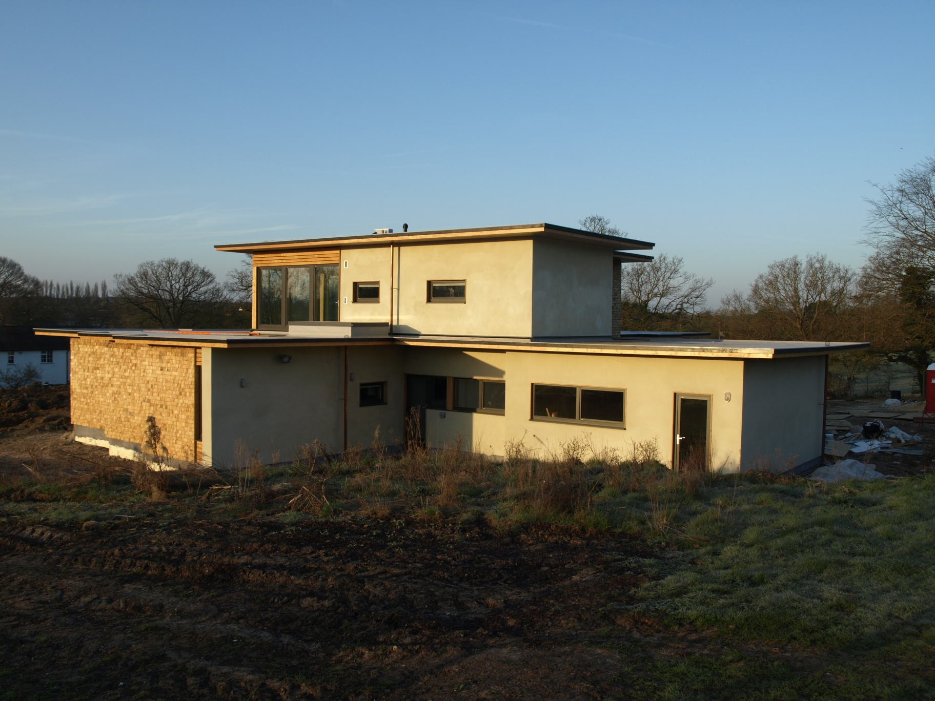

#355535 - 10/10/2012 10:21 New house pics
Posts: 1942
I did once say I'd post pics so here they are

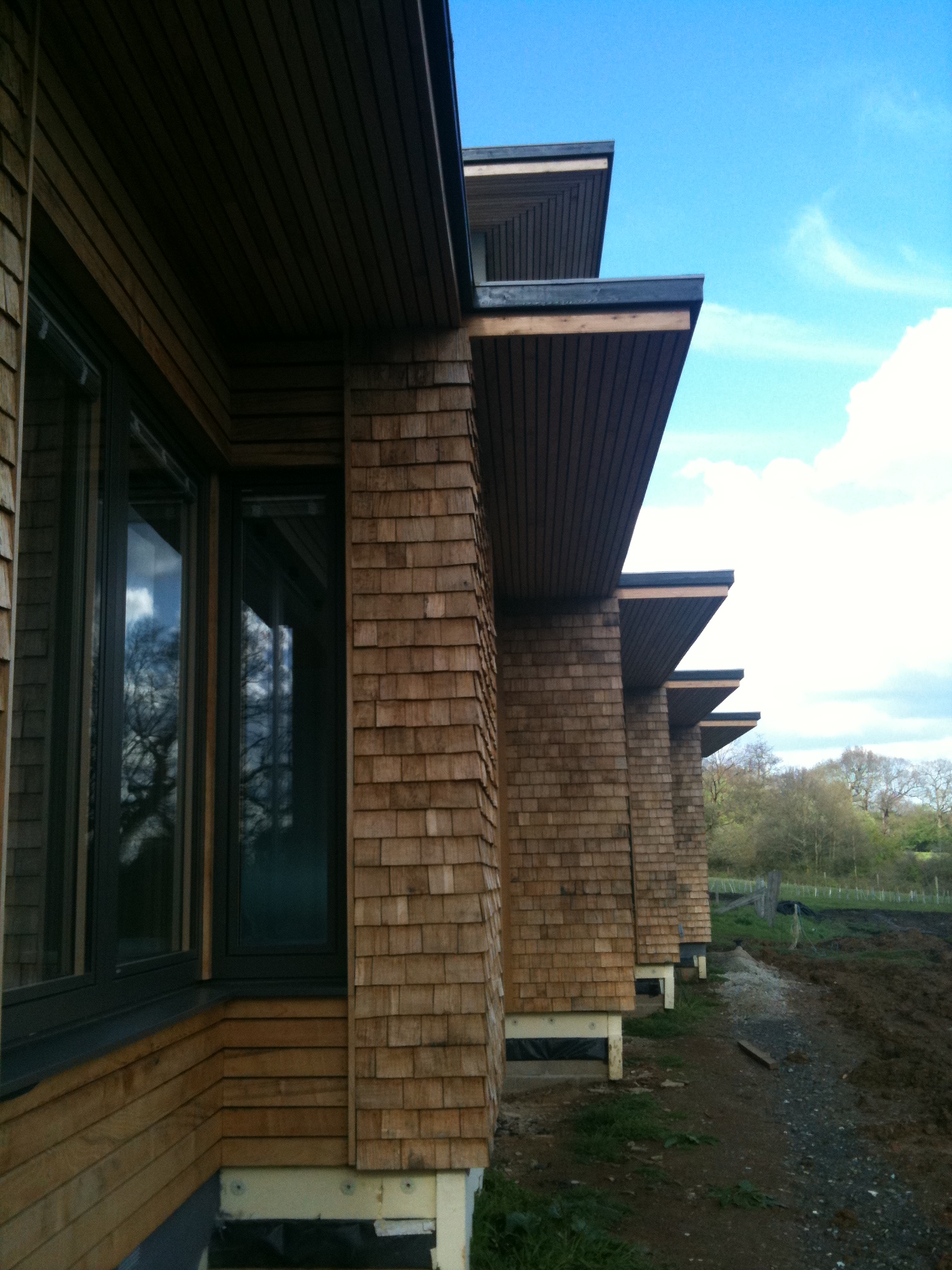

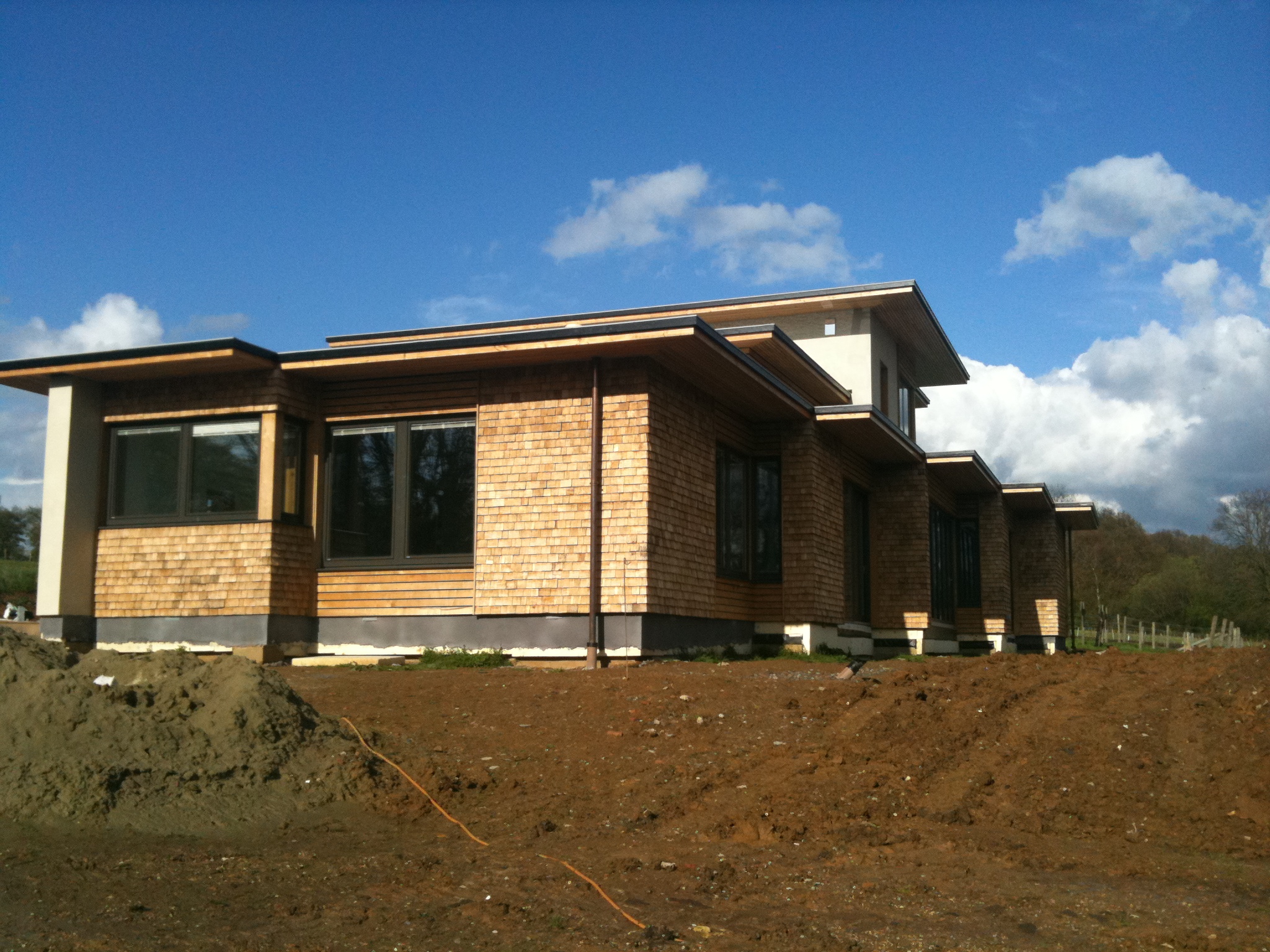

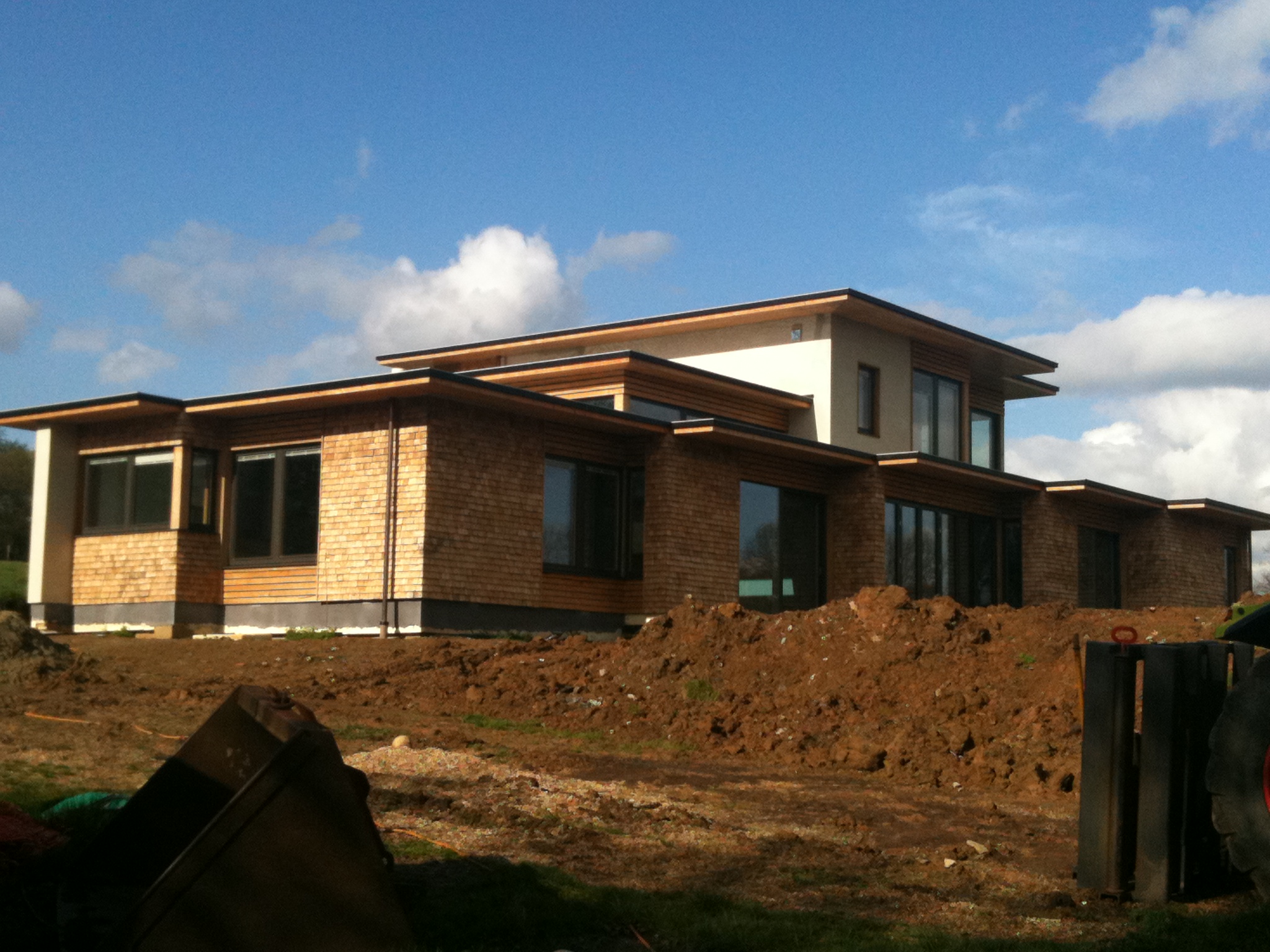

#355536 - 10/10/2012 10:22 Re: New house pics [Re: tahir]
Posts: 1942
Some more
#355537 - 10/10/2012 10:24 Re: New house pics [Re: tahir]
Posts: 1942
And some more

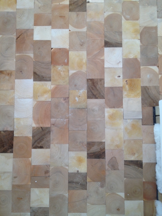

#355538 - 10/10/2012 10:25 Re: New house pics [Re: tahir]
Posts: 1942

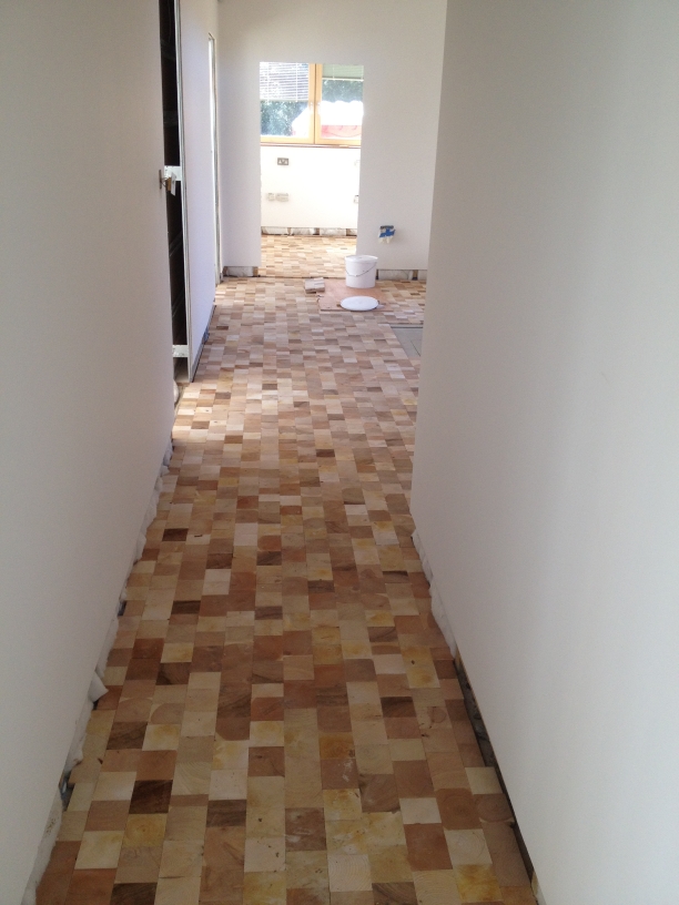

Last lot, the flooring is end grain blocks of various species harvested on site.
#355540 - 10/10/2012 10:29 Re: New house pics [Re: tahir]

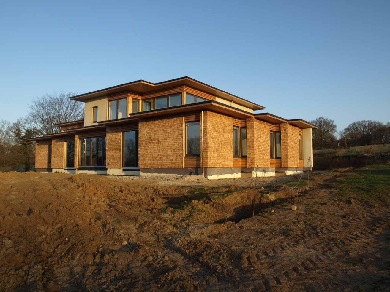

Nice! I really like the sides with the shingles. Sweetness. Congrats on the new place!
#355541 - 10/10/2012 10:41 Re: New house pics [Re: Dignan]
Posts: 1942
Thanks Matt, the shingles took ages to find locally, saw the guy fell the tree and everything

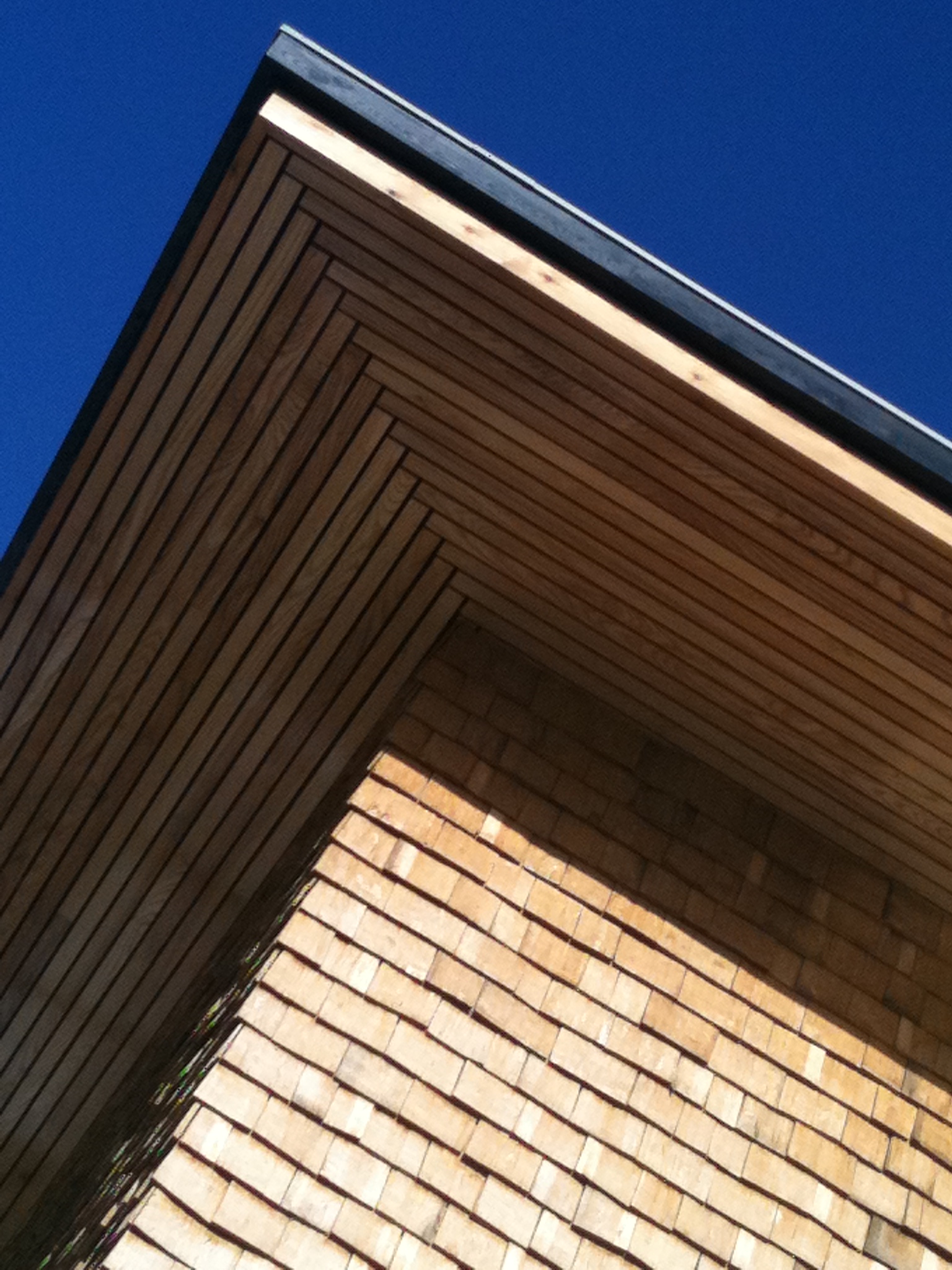

#355545 - 10/10/2012 11:33 Re: New house pics [Re: tahir]
Love the end grain flooring, and the mix of clapboards with the shingles for the siding. The way the corners was done with the shingles is nice, labour intensive, but very nice. I assume they are cedar.

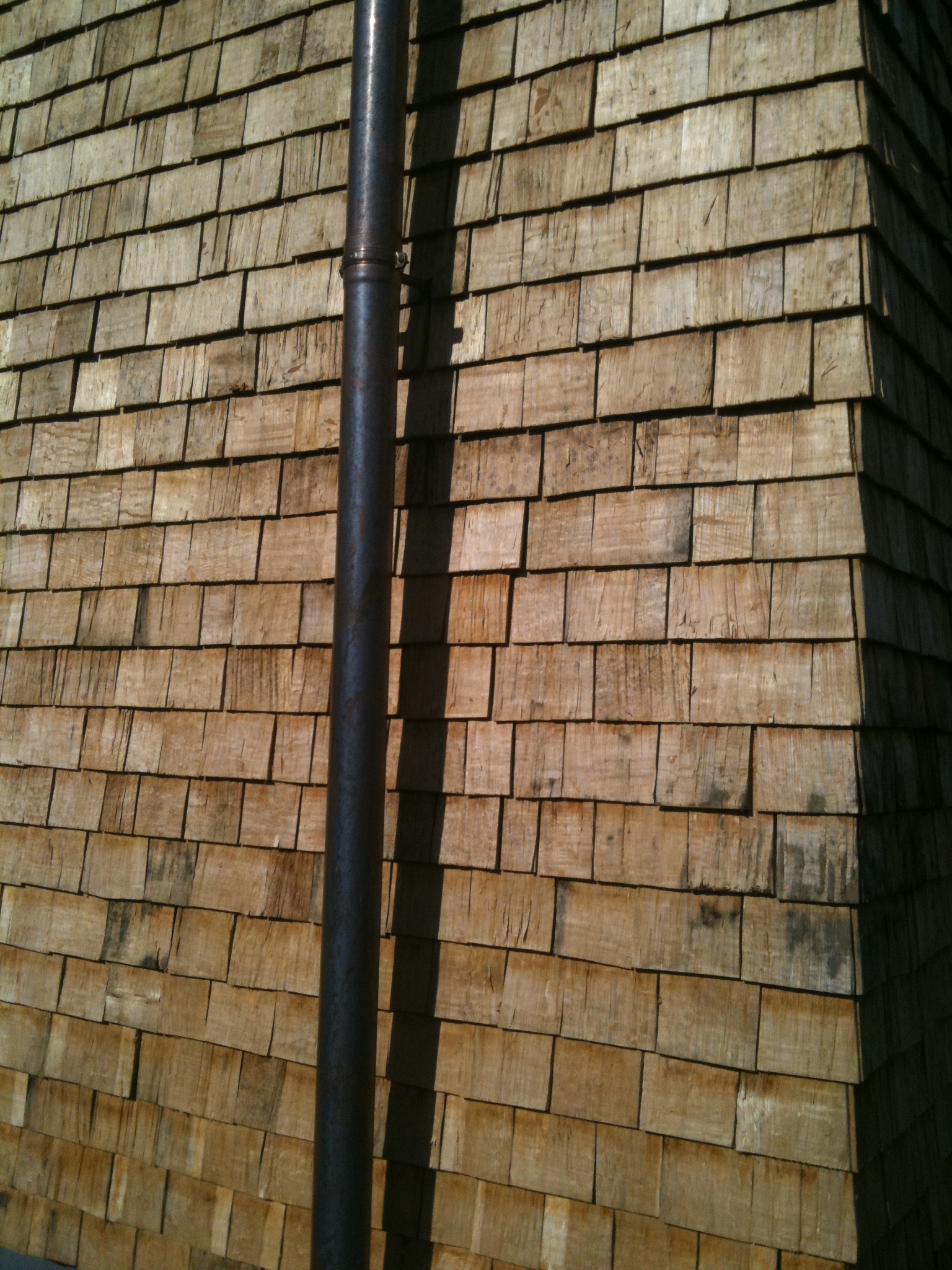

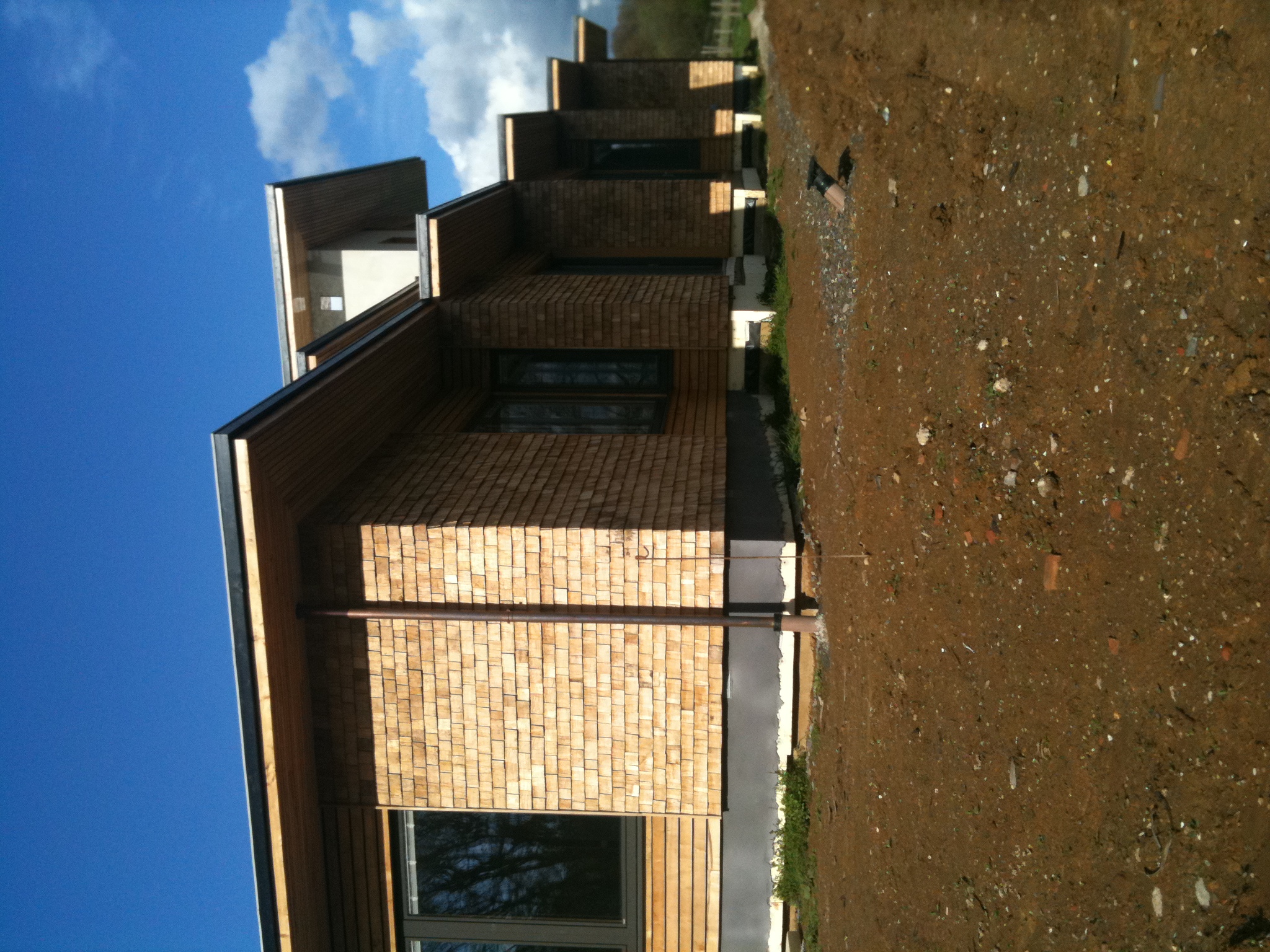

Is that a cast iron down spout? Also, the soffits, are those multiple ~2" wide strips with gaps in between them to provide for roof ventilation? Actually, that wouldn't make sense given that it is a flat roof... confused
#355547 - 10/10/2012 12:14 Re: New house pics [Re: Phoenix42]
Posts: 1942
The shingles are oak (traditional in Essex), clapboards chestnut, down spout is copper.
Soffits (ash) yes they are, and yes we do have ventilation beneath the roof, the visible roof is external to the insulated envelope of the house, it'll eventually be planted.
#355548 - 10/10/2012 12:31 Re: New house pics [Re: tahir]
Okay, now you really peaked pique my interest, what more can you tell us about the construction of this house, in particular the insulated envelope and heating systems. If you've covered this in a prior thread, feel free to slap me with an appropriated fish and direct me there.
#355549 - 10/10/2012 12:46 Re: New house pics [Re: Phoenix42]
Posts: 1942
OK, it's almost a passive house, so needs very little in the way of heating. It's heavily insulated all the way round, in the case of the walls the construction is part of the insulation (40mm fibreboard externally, then 140mm I beam filled with warmcel, then 18mm OSB). The whole thing is extremely airtight, airflow is controlled via a whole house MVHR system. We have a small gas boiler running a very low temp underfloor heating system (cuts out at screed temp of 27C) and in one room (the posh one for mums and dads) we've got the lowest rated woodburner we could find (old parents like a visible heat source).
I don't know if we'll ever need to run the heating, it's been warmer in there since December with no heating than our existing house with heating on.

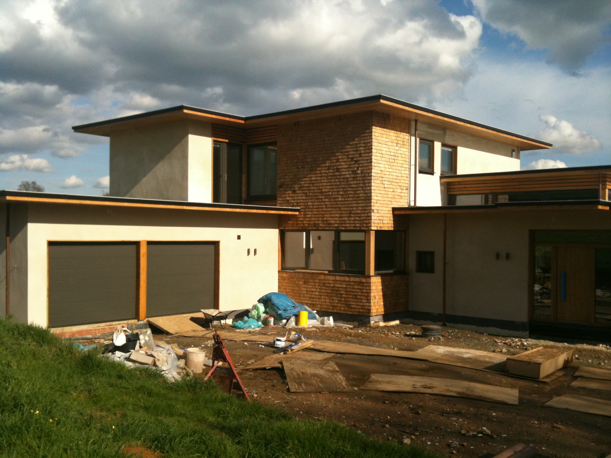

What about cooling? Is that an A/C compressor just partially visible in the very first picture?

This house is in the UK. Almost no one in the UK has any form of A/C.
I notice it has big overhangs over the windows, presumably to shade them and reduce the need for cooling in the summer (such as it is here).
Edited by andy (10/10/2012 13:12)
#355556 - 10/10/2012 13:13 Re: New house pics [Re: tanstaafl.]
Posts: 1942
No cooling, it doesn't get that hot here (mid 30s would be a v rare occurrence), we'll be relying on the shading (big overhangs), insulation and opening windows. You really have to see the house in it's setting to give it some context, our nearest neighbour is 600 mtrs away and with the lie of the land and the landscaping scheme it'll have melted into the landscape within a few years.
#355558 - 10/10/2012 13:14 Re: New house pics [Re: andy]
Posts: 1942
Yup, and the windows have integrated blinds as well, it's a 3 + 1 system so the blinds actually sit outside the insulated envelope, stopping the heat before it enters the building.

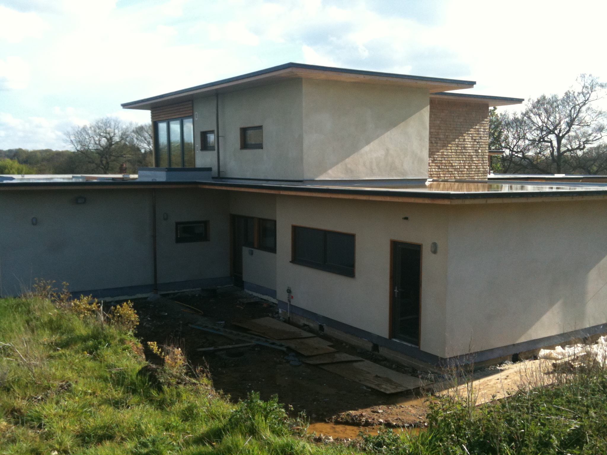

Very nice, congrats! But I do wonder a few things. I'm very interested in passive houses and that's why I also tried to build as passive as possible when we built out house, now 3 years ago. We didn't quite reach the passive norm, just the 'very low energy' norm.
1) Were bricks used for the supporting structure, or was it a wooden skeleton?
2) I'm sorry, but to me the amount of insulation doesn't seem all that much, not for passive standards anyway. 140 mm with warmcell is only about half to one third of what is needed for the house to be truely passive. The few months in which you claim only to need heating also seem very optimistic to me. In my case: we used 100 mm polyurethane which has a better lambda value than warmcell (so it insulates better per mm) The R value (larger is better) of our insulation is (thickness in meters / lambda value) 0.1/0.023= 4.34mēK/W. The lambda value of warmcell is 0.035 (best value) to 0.040 (worst value). In this example I'll use the best value. So your R value is 0.14/0.035= 4mēK/W. Conclusion: our house is still insulated a tad better with our 100 mm of polyurethane than yours is with your 140mm of warmcell. For the k value, you need to do 1/R, so for my insulation that's 0.23W/mēK and for your insulation that's 0.25W/mēK. (smaller is better here) Of course, to be completely correct, you need to add all the materials in the entire wall. In your case this means I would have to add the k values of the 40mm fibreboard and the 18mm OSB and most likely 15 mm of plaster on the inside as well.
In any case, our houses are insulated about the same, and they are built in areas with similar environmental conditions. Still, we could never go without additional heating from October to April/May. Granted, we use a low kW heat pump, but there's no way we could do without. I simply cannot imagine you needs so much less heating... maybe it is different for you if you haven't used bricks but used all wood? (just guessing here?), or maybe you can tolerate cold better than I can, but still... ?
3) Did you use triple-layer glass for the windows? Maybe even the so-called 4-season glass which has a special filter, which decrease your g-factor a lot?
4) I really can't get my head around the building style. Don't get me wrong, I like the look personally, but it seems very inefficient for a passive house. For passive, best is to have a boring square or rectangular house with a normal roof (a 'compact' house). I find the shape of your house, with all the sections like the garage and the living room jumping 'out' (I don't know really how to put this, I hope you'll know what I mean) like they do really inefficient because they all are extra surface that is in contact with the air outside the house. All this extra surface inevitably means more loss of heat through the walls and roof. Naturally it's imperitive this should be avoided at all cost in a passive house. Flat roofs can be done, but also are more difficult to insulate. I can see you did the homework on your windows though ; small to no windows on the North side, most other windows in the South side of the house. Were this factors you took into account, but let the look of the house be decicive in the end? (I could understand that)
5) Did you do a blower door test to test the airtightness of the house? If so, what was your g (small g) value? (just for my curiosity smile ) Did you have a thermal image scan of your house done?
6) For ventilation, you say you use a MVHR system. What unit did you use? Is the inlet simply pulled air from outside, or does the air get pre-treated via the heat in the soil outside the house? (I don't know the correct name of these devices in English, but literally translated they should be called "Soil Heat Exchanger" or something like that)
7) What is the kW value of your gas boiler? I suppose you also heat your hot tap water with this gas boiler? Or did you install a solar boiler? (can't really tell from the photos, but I think not?)
8) Did you install photovoltaic panels?
Not sure what you mean, the foundation is concrete; beam & block with a screed on top. The actual structure is pretty much all I beams with some glulam beams where needed.
I guess we'll find out once we move in, it's pretty much all wood, I can't remember the U & R values but we paid a lot of attention to avoiding cold bridging and air leakage. We're hoping to move in in November, yesterday morning (frosty) it was warmer in the new house with heating off than in the old house with heating on.
Yes, all triple glazed, some with an extra pane outside for the blinds. I don't think it was special glass.
It was a VERY difficult house in terms of targeting passive house, too many corners, too much external wall to volume. The form was dictated by the floor plan, we wanted all of the house to be used, and for it to be flexible in it's accommodation.
We were aware that we were making things more difficult from a detailing point of view but there's not much point building your own house if you don't optimise your living space. One of the reasons there's more glazing than you'd expect to the N is that our kitchen is on the N of the building and we wanted to make full use of natural daylighting.
Yes, but I don't have the figures. I'll dig them out. We haven't had a thermal scan done.
It's a PAUL unit, it has an electrical frost protection circuit but just takes in fresh air through the wall, the engineer did originally spec a ground loop but changed his mind, can't remember why.
I'll see if I can dig out the spec, we have solar thermal for hot water.
[8) Did you install photovoltaic panels?
No
I hope all my questions don't overwhealm you, but for me this is very facinating stuff. smile
I'm glad you find it interesting. I did a presentation on it with my architect at the AECB conference this year and will be doing another at EcoBuild next year.
