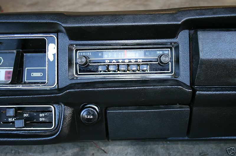

I'm making a custom faceplate out of acrylic for my empeg to make it look like a classic radio for my Datsun 510 (bakelite knobs with chrome inlays, etc)
In order to get the design right, I need accurate (better than I can get with a camera) locations of the screw holes, two-function button/knob, screen, and IR sensor.

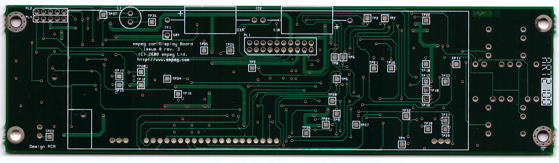

These may provide a decent starting point.
The scans were done at 300x300dpi, so each pixel in the images represents exactly 1/300th of an inch.
(Edit: fixed orientation and naming of original uploads)
Description: Front of empeg Mk2 display board.
Description: Rear of empeg Mk2 display board.

Attached is a 2D DXF file of the top and bottom layers of the last version of the Mk2A display board. It should be exactly 1 to 1.
issue 9R2 empeg display board 2d.dxf (412 downloads)
#359680 - 12/09/2013 20:09 Re: Display Board Technical Drawings? [Re: Joe Gorman]
Here's one with the silk screens, which will be more useful.
issue 9R2 empeg display board 2d with silks.dxf (420 downloads)
