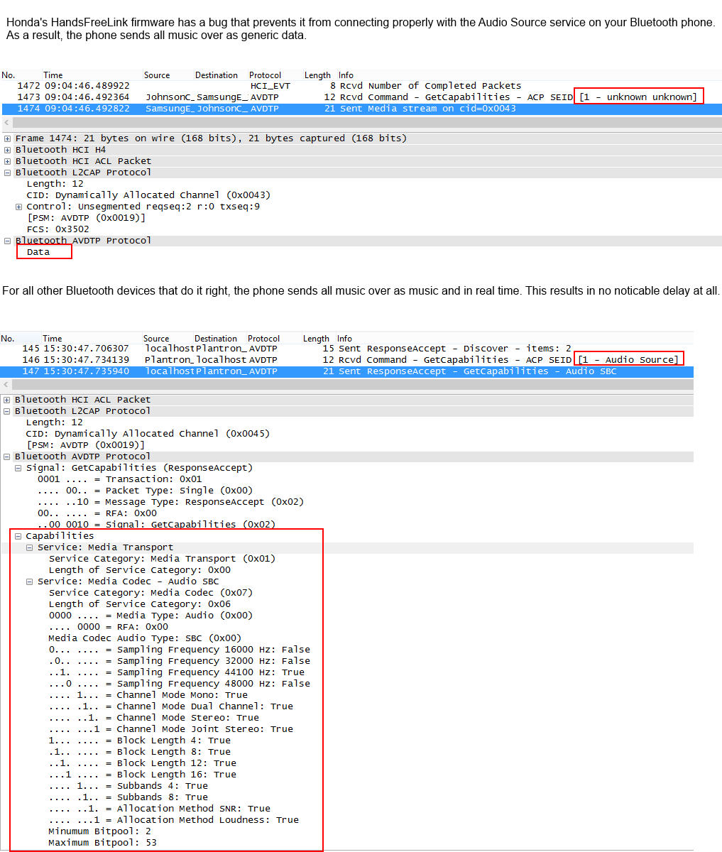

FWIW I think I've found the bug in Honda's code. When the Honda sends a "Service Search Attribute Request" for the "Audio Source" service on my phone it's omitting the UUID. The UUID is required. As a result, my phone responds with "Unknown service" and ends up transmitting all audio as generic data.
With the other devices I've tested, the UUID is there, my phone responds with the required information for the Audio Service, and all music gets streamed using RTP (Real Time Protocol).
On phone with Honda now.

FYI, I checked in with Honda on this. Unfortunately, I'm being told there is no way to get any kind of status update or even have a dialog going with them to help fix the bug. They basically said the only status update I can hope to get will when and if a firmware update comes out that fixes it.
I appreciate all the help and support on this one.
Just for kicks, I'm attaching what I think is a pretty clear illustration of the problem. smile

No major updates. Only that a family member has a brand new 2014 Acura MDX with Nav, hard-drive, and the high end AcuraLink feature. And it too has the 3 second delay. Took a trace and it matches up nicely with my Honda. I sent that trace to Honda along with a trace from a 2014 Toyota Camry Hybrid that has no delay.
#363263 - 07/01/2015 19:18 Re: Need help troubleshooting Bluetooth A2DP delay problem. [Re: rubennyc]
rubennyc
Registered: 27/01/2006
Posts: 142
In case anyone is still following this: Latest update from Honda is that the software engineers at Visteon are looking over the data I sent. (Visteon bought Johnson Controls's car electronics division last year.)
I remain cautiously hopeful this will get fixed before my lease ends 23 months from now. wink
