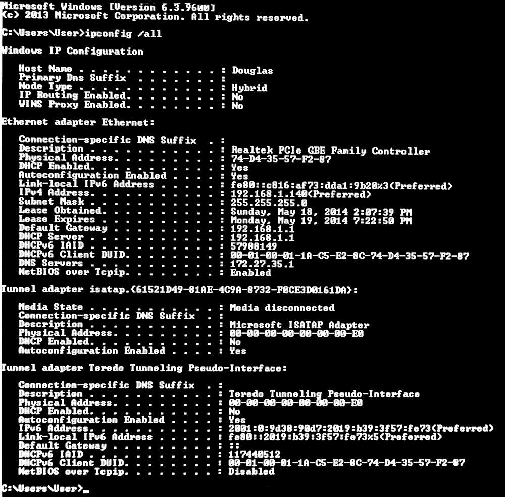

No, wait! I mis-spoke about my network. The cable modem feeds the OOMA which in turn passes through to the router. So I DO have a free port for the empeg. Theoretically, since my router is set up with DHCP, if I plug the Ethernet cable from the router into the empeg, it should talk to the computer.
It doesn't.
I am working with my "old" empeg now, a Mark II-A, Rio branded. Too many problems with the "new" player now. The "About" screen says:
etho IP: 192.168.1.104
etho DHCP: 192.168.1.1
ipconfig /all says:
IPv4 Address: 192.168.1.140 (see attached screen shot)
Shouldn't it "just work"?

It should in theory just work, and show up like this:
If not, you can click options on that screen, and I believe type the empeg IP in directly. In this case, 192.168.1.104.
My guess is that the Windows firewall may be interfering with automatic discovery. Though it's been over a decade since I've ran emplode on Windows.

I don't think I've needed to adjust Windows Firewall in a long time. Only real old versions of Windows Firewall were ever an issue.
Doug, you're right, it should Just Work based on the settings you were just showing. Double check the "Options" button in the "Select empeg-car" screen in Emplode, like Tom said. Make sure you didn't change the settings in such a way as to prevent the player from being discovered.
Another thing to check: Emplode can't talk to the player if the player thinks it's in "Car" or "DC" mode. Make sure the player is in "Home" or "AC" mode before trying to connect with Emplode.
#361724 - 19/05/2014 14:25 Re: Some player problems [Re: tanstaafl.]

While that is quite a high quality screen shot that you posted, it was clearly taken with an actual camera. On your computer, search for the built-in Windows tool named "Snipping Tool". Hopefully it'll be there in your version of Windows, it's located in %windir%\system32\SnippingTool.exe. That will allow you to take future screen shots with a lot less trouble. You can drag to select a rectangle of where you want the screen shot to be taken, and then afterwards highlight and/or draw annotations on the screen shot (though annoyingly there is no text annotation tool). There are other screen shot tools out there which are more full featured, but Snipping Tool ships with some editions of Windows, so you might already have it.

Next thing: From a DOS prompt, with the player plugged into the network, can you successfully PING the player's IP address?

Sigh... and now it does. It wasn't working last night, this afternoon it is. I don't know why. Maybe I didn't let it search long enough for the connection or something. Today, after about 15 seconds of searching, it found it.
The only thing I did was ping for it at a system prompt, as you suggested. The ping found it instantly.
Then I tried, for the umpteenth time, emplode. And emplode found it.
No need. I just use the Print Screen key on my keyboard, and it stores the screen shot into the clipboard. I paste it into Paint.net, resize it to show just the pertinent information, and save it as a .jpg or .png file.
I posted that camera shot because due to some weird mental lapse I had it in my mind that I couldn't save a screenshot from a system prompt. Of course I can, I don't know why I was thinking that.
But thanks for the suggestion.

I did that, changed the ip address so the third octet had a "1" subnet, saved the file, and changed the computer back to DHCP, fired up the empeg, and... no connection. Looked in the "About" file on the player, and my config.ini changes weren't there. I finally figured out that I had to re-synch the player for the config.ini changes to take effect. Aha!, he says. The config.ini file isn't kept in the player, is it? It's kept in the computer. After re-synch everything was fine.

Something else you should do. Instead of making that 'new' player be a fixed IP address on the .1. subnet, you should just change it to DHCP.
[Network]
DHCP=1
That way, you won't end up just having the same problem over again if your network addressing scheme changes.

... I mis-spoke about my network. The cable modem feeds the OOMA which in turn passes through to the router.
... my router is set up with DHCP...
Beware of double NAT.
If the OOMA is configured as I expect, then the OOMA is actually your main Internet router. It would be controlling the QoS for VOIP in addition to providing DHCP and NAT for your home network.
The Linksys I would hope is configured to NOT provide DHCP or NAT. Otherwise you have two layers of NAT happening, which can cause problems.
