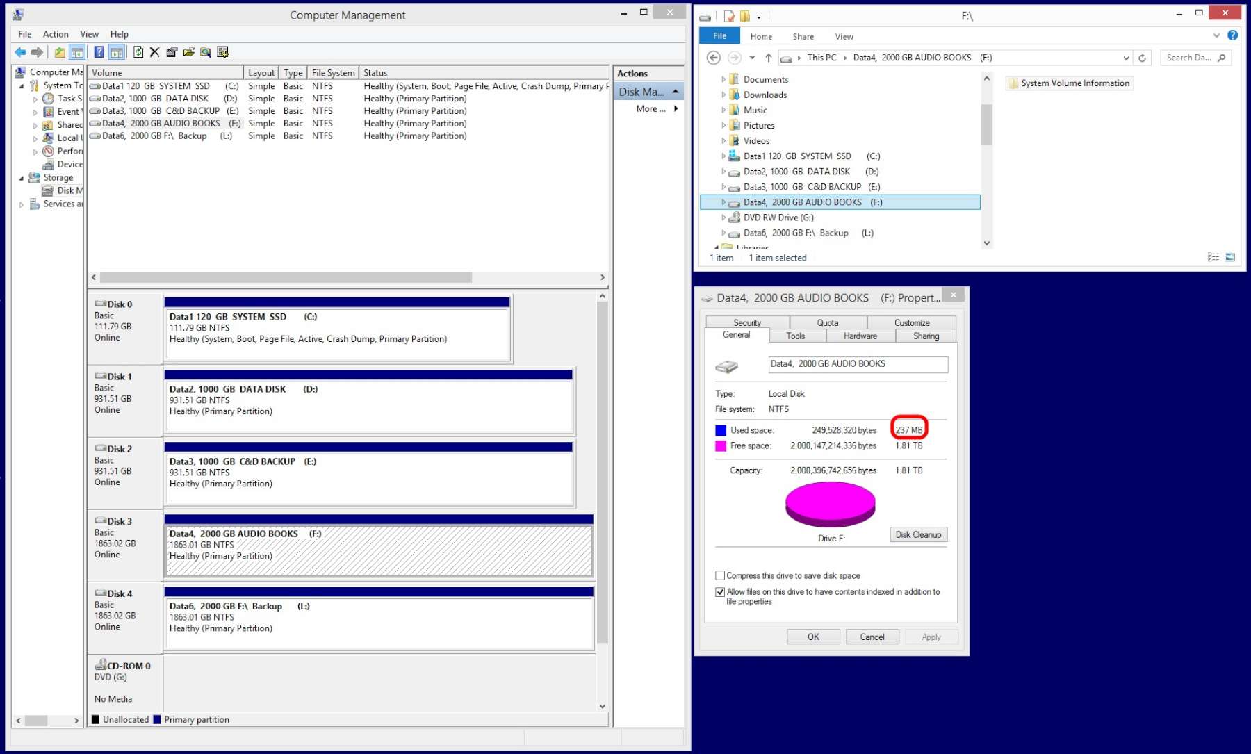

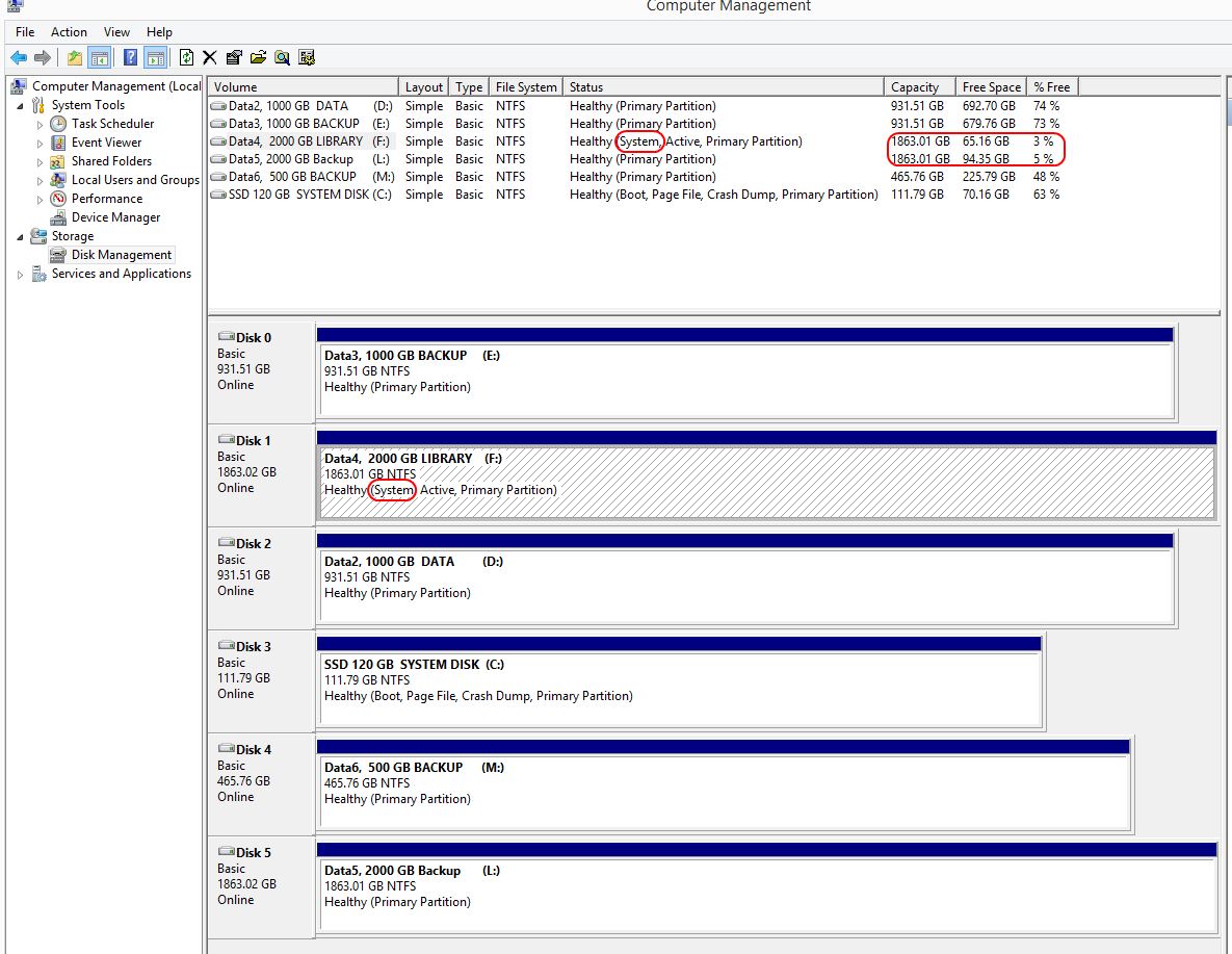

I have six hard drives in my system - four internal, and two external that are only powered up occasionally for backups.
My F:> drive is a two-terabyte internal drive that is backed up to my identical external L:> drive. F:> is somehow listed as a system drive. It is entirely data, containing nothing but a few audio books. (Few = 3877 books, 1769 gigabytes. smile )
Because it is shown as a system drive, it seems to be using up 29GB more space than the L:> drive, and when I run backups it throws errors trying to back up a very few files that apparently are involved in this "system" business. Not a great problem, just annoying.
What do I need to do to convince the computer that the F:> drive is not a system drive?

#361803 - 25/05/2014 11:02 Re: Disk Management Question [Re: tanstaafl.]
I don't think it's a hidden partition. Otherwise capacity would/should show differently. Hidden partitions should still show in Disk Manager too.
#361804 - 25/05/2014 12:50 Re: Disk Management Question [Re: andy]
Posts: 5554
It has a hidden partition on it used during the boot process.
I don't think that is the case. According to the article you linked, that would apply if:
Your computer has more than one operating system installed...
or
Your computer is set up to run BitLocker Drive Encryption.
Neither is the case with my computer. The F:> and the L:> drives are strictly data drives, both of them WD20EARS 2-TB drives. The only differences I can see in their setup is that one of them shows a status of "System, Active" and the other does not, and the "System, Active" drive has 29 GB less free space. Well, 31GB now, after clearing the recycle bins.
Except for the extra files caused by/created for the "System, Active" status the two drives are byte for byte identical, but several of those files don't get backed up to the L:> drive because of "...file in use.." error. These differences only account for about 55 kilobytes, however, so... perhaps you are right after all, because something is eating up those 31 missing gigabytes.
How would I find a hidden partition?
Edit: Possibly this? ? Then I would reformat the drive and copy just the files I want from the backup?
db
Edited by tanstaafl. (25/05/2014 13:13)
Edit Reason: Add link
#361819 - 28/05/2014 18:43 Re: Disk Management Question [Re: tanstaafl.]
Is it possible one of the following is in the internal drive:
MBR
BOOT directory
bootmgr file
pagefile.sys file
What is in the drive root if you issue the "dir /a" command?
#361820 - 28/05/2014 18:44 Re: Disk Management Question [Re: tanstaafl.]
and also
hiberfil.sys
pagefile.sys
swapfile.sys
Recovery (dir)
#361821 - 28/05/2014 22:02 Re: Disk Management Question [Re: Taym]
Posts: 5554
MBR
BOOT directory
bootmgr file
pagefile.sys file
and also
hiberfil.sys
pagefile.sys
swapfile.sys
Recovery (dir)
F:\dir /a:
LIBRARY
System Volume Information
and that's it.
There was a bootmgr file, and another boot-related file, but they are gone now. I spent an hour and a half with the computer at the computer store today and they were able, with considerable effort and a bit of risk (possibility of having to format the C:> drive and reinstall Windows) change the F:> drive from "System, Active..." to just plain "Healthy Primary Partition" like all the other data drives.
hiberfil.sys, pagefile.sys, swapfile.sys are all on the C:> drive and have been all along.
I disabled hibernation and got rid of the hiberfil.sys file, picked up 5GB of space on my SSD, and am working on moving the pagefile.sys and swapfile.sys files over to my D:> drive. I know it can be done, but so far the instructions I have found have been confusing.
After getting rid of the "System, Active" parameters on the F:> drive, I formatted it and as I type this am restoring it from backup. 1.72 TB takes a long time...
But that brings up another question. After a fresh format on the F:> drive, I immediately checked filespace, and somewhat to my surprise there was 237MB shown as "Used Space". Windows Explorer showed nothing on that drive other than the empty System Volume Information file. Now, that's a big improvement over the 31.4 GB that used to be hiding from me, but I AM a bit curious as to what's eating that 237 MB.

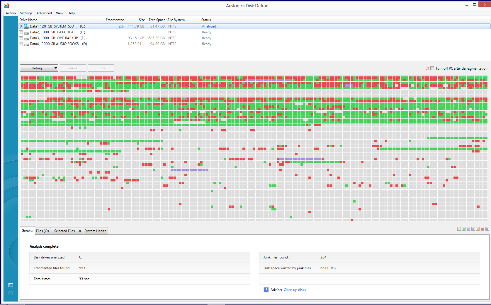

#361851 - 30/05/2014 14:44 Re: Disk Management Question [Re: BartDG]
Posts: 5554
With the most recent SSD's which support "wear leveling"
I bet wear leveling is why my fragmentation map looks like the attached.
Since there is virtually no penalty in reading fragmented sectors vs contiguous sectors in an SSD, defragging is counter-productive.
And now, for something completely different... I saved the screenshot below with my graphics editor, "Paint.Net", whose default save format is .png. Then I realized I should save it as a .jpg to get reduced file size, and did so. To my surprise, the lossy .jpg turned out to be considerably larger (7x bigger) than the lossless .png.
Odd.
#361852 - 30/05/2014 15:46 Re: Disk Management Question [Re: tanstaafl.]
Odd.
It's not really so odd. Different formats for different purposes. JPG was created for use on photographs, which typically have lots of high-frequency data (leaves in trees, sensor noise, etc), and gradual transitions between objects (blurs, etc). PNG was a replacement for GIF images, which were typically graphics (as in graphic design) characterized by high contrast/sharp color transitions, and very little high-frequency data. And don't forget that "lossless" isn't the same as "uncompressed."

#361860 - 30/05/2014 19:08 Re: Disk Management Question [Re: tanstaafl.]
Not really. The real reason your frag map looks like scattered rice is because SSDs have a seek time of about zero, so there's less need for data to be stored sequentially in flash for fast access. Not that the frag map shows the real layout in flash anyway. wink
#361863 - 31/05/2014 14:01 Re: Disk Management Question [Re: mlord]
Mark is, as usual, absolutely correct on this. I just thought I'd emphasise this point: the layout of blocks that the OS sees bears little relation to the layout of blocks in flash.
For example, if the OS writes to (what it thinks is) block #12345, which is currently mapped (by the SSD controller) to #98765, and the SSD controller decides it needs some wear leveling, it might move that data to block #50943. The OS still thinks the data's on block #12345, in its view of the world, but it's been moved in flash.
Spinning iron disks actually do something similar for bad sector remapping, and the OS (usually) doesn't know anything about that either. This is not new.
What it means is that what looks like a nicely-defragmented file in the OS's linear view of the disk might actually be scattered all over the flash blocks or physical sectors.
