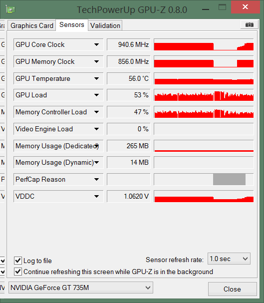

If I run the Techpowerup GPU-Z utility, I can clearly and unambiguously see that this is caused when there is a PerfCap of reason "16" ("Util") occurring. I have attached a screen shot of this happening in GPU-Z. You can see it very clearly, as if someone has taken a giant bite out of the GPU performance graph, accompanied by a gray bar in the PerfCap Reason graph.

- Attempted to find out if it was excessive temperature or GPU load causing the issue. It's not. As you can see in the screen shot, the GPU and memory controller load is only in the 50 percent range, and the GPU temperature is in the tepid Mid-50c range. I can run graphics demo programs which bring the memory controller load and GPU load up to the 99-100% range and heat the GPU up to about 66c, but no perfcap occurs during those tests. So it's not excessive temp or GPU load.

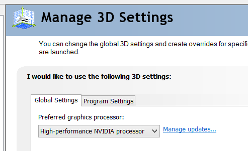

Or, you can also look to disable the Optimus feature, and try and force everything to the NVidia GPU at all times and see if the problem persists.
Is this the sort of thing you meant? If so, that didn't fix it. Do you think there might be some other way to disable the Optimus feature?

Looking at GPU-Z, I can see that the Nvidia GPU is still the chip that's being used when the problem occurs... it's just that the voltage to the chip has been throttled to increase the battery life of the laptop.
