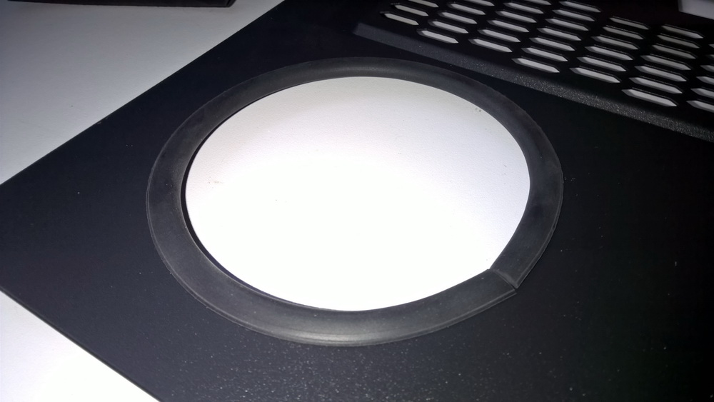

My home server is in a Cooler Master HAF XB. I removed the side panel, and that alone caused this temp drop:
WD 49°C
Seagate 54°C
This is good, since I just found out I do not possess any home fan! laugh frown
I do have possibly 10 PC fans in my PC parts boxes, so I'll see if I can do anything with those.

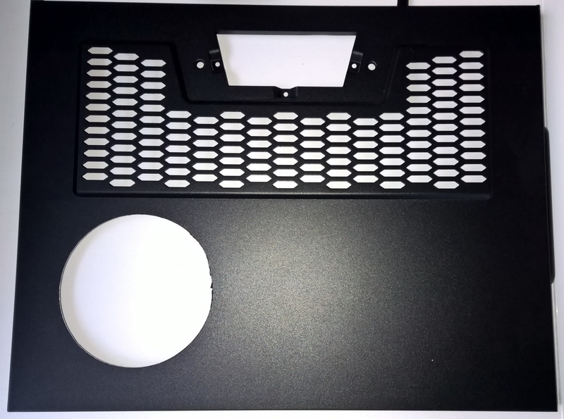

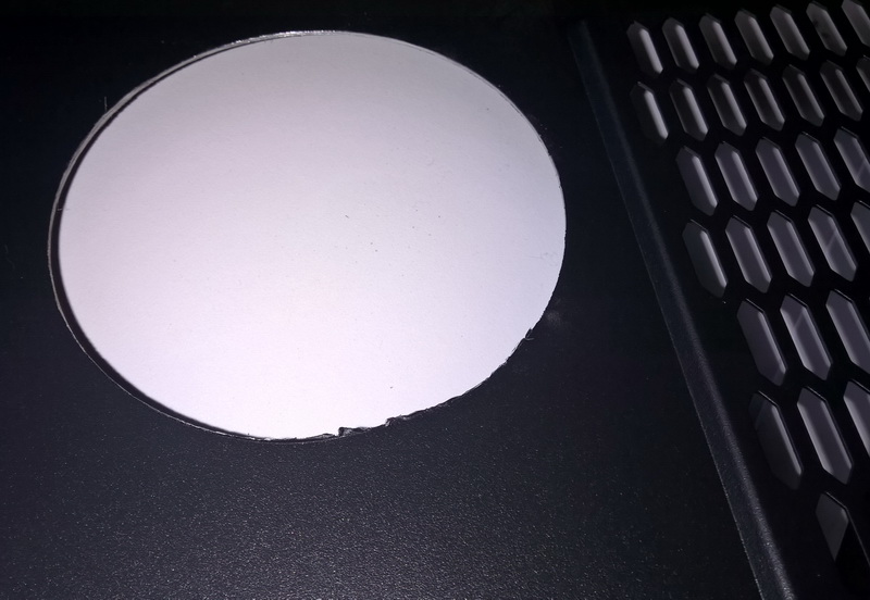

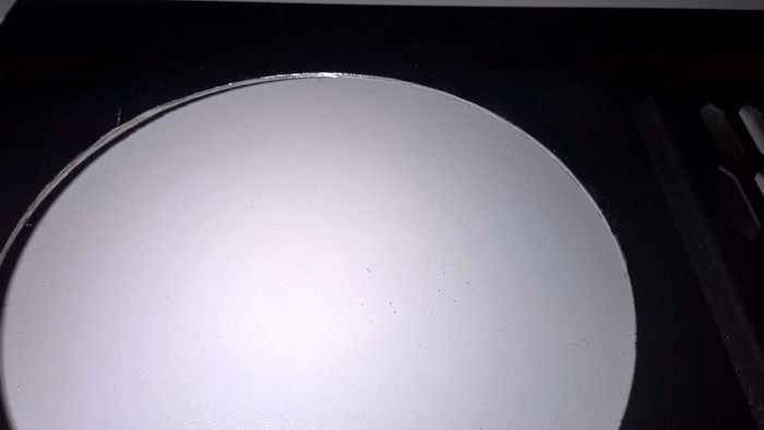

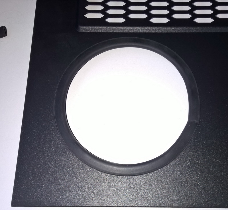

I am now planning to improve cooling of the hot-swap HDD area of the case. Sadly, the HAF XB has no hole in the bottom part of the side panel, where the hot-swap hdd tray is located. Which is a really silly flaw in what I consider a beautifully designed case otherwise:
http://www.cmstore.eu/parts-replacements/case/haf/haf-xb/haf-xb-side-panels/
So, I may have to use a Dremel there. Even without a hole, though, there seems to be enough space between the hdd tray and the side panel to allow some forced air circulation. I'll try that or keep the case open on one side while I make the hole myself.

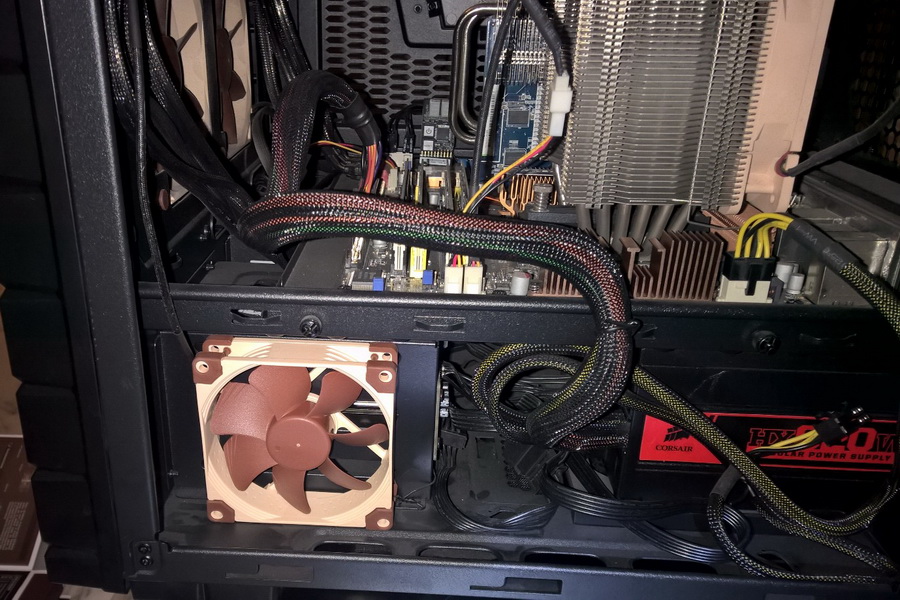

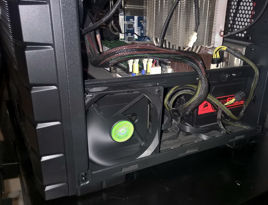

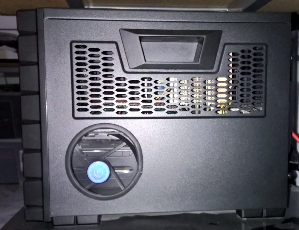

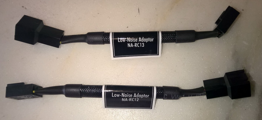

I am now installing a temporary additional fan, waiting for the proper, silent Noctua to be delivered and put in place permanently.
#366109 - 28/02/2016 12:20 Re: Seagate ST8000AS0002 [Re: Taym]
Temporary fan installed.
Temperature now, in normal operation, is
WD 32 C
Se 33 C
Much, much better.

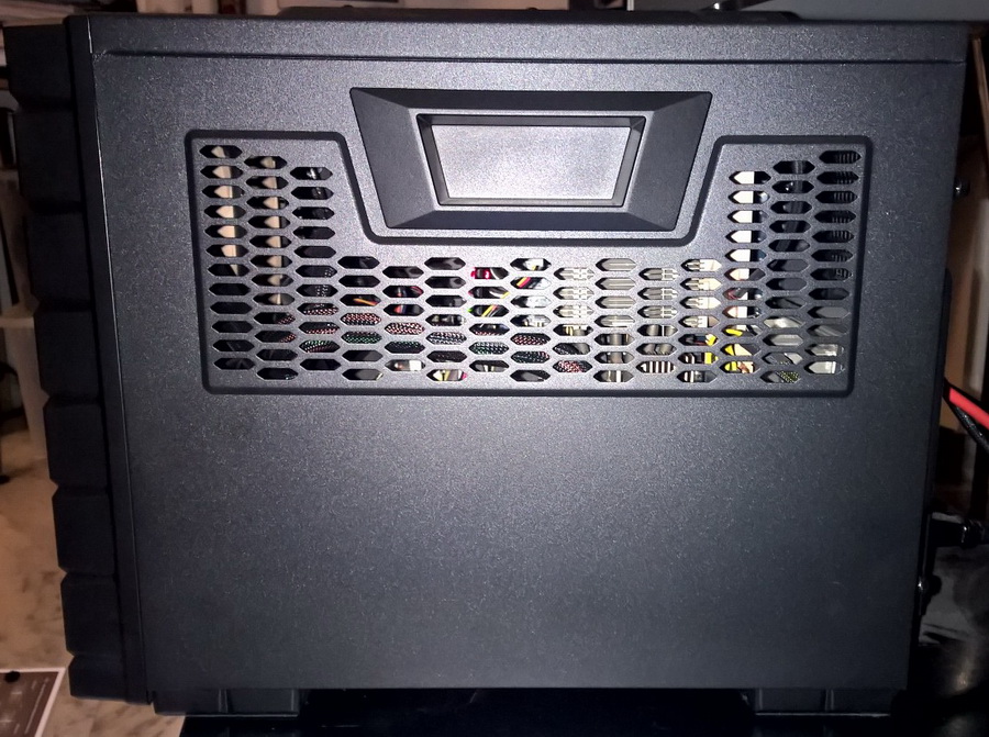

Case is still open, though. So, once I put in place the proper fan (which will be both more powerful and silent) and I close the case, I hope I can keep around 35. That'd be great.

I have tried Noctua fans for my 100% silent server (under my home desk) and MythTV box (media room), but was surprised that they weren't completely silent.
My aim for fans is simple: large diameter, low RPM, no perceptible noise in a pretty quiet room.
For the slim fan under the drives in the MythTV box, I used a Kaze-Jyuni SCYTHE (120mmx12mm) Sy1212SL12H-P. Nominally 1200rpm, but I slowed it down further with a fat resistor. smile
I cannot find the spare 700rpm fan I bought for the server (dead silent) to see what brand it is (cannot find loads of stuff.. moving house is very stressful on memory..). EDIT: Found it: another SCYTHE fan: SP1225FDB12L. Didn't need to add any resistors to it either.

Mark, indeed, this is possibly the best case I had for a home server. The top half is cooled really, really well, so, MoBo CPU, Video card are all at ideal temperature. The bottom half only has room for 2 80cm fans in the back left side of it. But, hot-swap HDD location, front right, right in front of the PSU, is completely lacking any ventilation. Which is quite silly as

#366156 - 02/03/2016 18:14 Re: Seagate ST8000AS0002 [Re: Taym]
So, in installed the proper FAN (Noctua).
In the attached pictures you can see
1. Cooler Master temporary FAN, case open. With this setup I achieved 29/31 °C temperature, almost constant, for the WD and Seagate drives respectively.
2. Noctua NF-A9 FLX Fan, which I bought as a permanent install.
3. Nocuta included Low Noise and Ultra Low noise adapters for the FAN. I installed the Ultra Low Noise adapter, which is of course also the one producing less cooling.
4. Noctua in place. Notice how, being smaller, I could push it further in. I am hoping the fan can more effectively pull air from the bottom holes you can see in the picture when the case is closed.
5. Case closed. As you can see, there's NO ventilation holes whatsoever in the side panel.
After 30 mins up and running, case closed and Noctua FAN spinning at very low speed (Ultra Low Noise adapter), HDD are operating at
WD 34 °C
Seagate 35 °C
If they stay like this, I am going to bee happy. We'll see in few days.

#366207 - 05/03/2016 19:23 Re: Seagate ST8000AS0002 [Re: Taym]

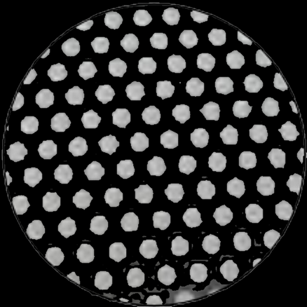

... because I am impatient and I do not own (yet) snips, as a temporary solution I decided to
- reinstall the 12mm fan
- make some small holes, approximatiely in a circle, on the side panel, by using a regular drill with metal bits (which I do own).
Side panel has been in place for 1 hr and temps are
34 C
36 C
Also, i can't hear anthing.
Pretty good wink

... and so I have to take that back. Not good. Temp increased up to 42/44, so the few holes I made are not sufficient.
Would it be ok to use a 10cm hole saw (which I do have) to create a 10cm hole, and then enlarge it to 12 by using snips, once I get them and practice using them?
Or alternatively, take a 6mm drill bit and make a lot of small holes in a nice symmetrical round pattern.
#366218 - 08/03/2016 09:01 Re: Seagate ST8000AS0002 [Re: Taym]
Yes, that is an option too Doug. The ones i made are already larger than 6 and pretty random, though, so i'll probably resort cutting a big round hole somehow...
#366219 - 08/03/2016 12:36 Re: Seagate ST8000AS0002 [Re: Taym]
Posts: 14531
Tin snips, man. Just practice on paper or plastic first. Just like scissors, except they only go around a circle in one direction. The red one goes one way, the green cuts from the other direction. Don't touch the yellow ones for this job!
Practice is easy: just draw/trace a couple of concentric circles inside the real/final larger circle. Practice on the inner circles, then graduate to the outer real one. Has the benefit that larger circles are easier, too.
You mentioned earlier that you already plan to wrap the cut edges with something, so absolute perfection isn't needed. Black gaffer tape is an excellent edge wrap, if you don't want to bother with something more specialized.
Edited by mlord (08/03/2016 12:39)
#366220 - 08/03/2016 15:56 Re: Seagate ST8000AS0002 [Re: Taym]
Mark, ok, I'll see if I can refrain from using that tempting hole saw and break the case side panel, and wait to get those snipping tools. wink
Jokes apart, I just did not want to keep the server open and do something temporary in the mean time. But the truth is, server case can be left open no problem. I'm just impatient to have some fun with this. smile
Thanks again.
#366221 - 09/03/2016 00:04 Re: Seagate ST8000AS0002 [Re: Taym]
You do realize, I hope, that once you finish with this project, you will need to install some sort of drip pan underneath your server, because if you ever turn the server off, all the frost and ice that has accumulated on the hard drives is going to melt and leak onto the floor as they comes back up to room temperature.

#366226 - 09/03/2016 16:14 Re: Seagate ST8000AS0002 [Re: Taym]
K447,
My server case has two main sections. The section above for Mother Board, Video Card, CPU, expansion cards, etc, is extremely well cooled. Two 12cm Noctua Case Fans, plus 1 14cm CPU heatsink fan, produce what i consider an ideal airflow.
Underneath, case section devoted to PSU, Optic unit, HDD, is instead poorly cooled. There is no fan other than the one mentioned in this thread. ALso, there is not much space, and several cables (fromt he PSU to the above section and to two SSDs, 2 HDDs, and DVD reader), and SATA cables to all the same units from the above motherboard.
So, yes, you are correct, air flow is actually significantly compromised by all cabling. I was thinking precisely to see if I can re-route them in some more orderly way to improve the situation.
I do not have a thermometer in my studio, but I'd guess the room is around 25°C . Delta between environment and HDDs is therefore between 5°C and 10 °C
Edit:
Bottom section has 2 locations for 2 8cm fans. Unfortunately, they'd be at the opposite side of the HDDs, separated from them by a lot of cables, which is why I decided to go with a larger fan close to the HDDs (see pictures above) and related case modding that I've been mentioning in this thread.
Edited by Taym (09/03/2016 16:18)
#366249 - 13/03/2016 15:16 Re: Seagate ST8000AS0002 [Re: Taym]
One more test with flipping the fan (still large one, case side panel removed).
30/31°C vs 36/37°C .
Quite amazing.

#366417 - 02/04/2016 15:47 Re: Seagate ST8000AS0002 [Re: Taym]
So, this project was on hold for the last three weeks as I had my apt bathroom re-done. I just resumed it and decided to give the hole saw a try. It worked nicely, I have to say. Here are some pictures for you.
As you can see 90% of the edges are nice, 10% a bit too sharp. However, I fitted the rubber finishing I planned to use, and it looks decent.
Server HDD temp, after 1 hr running with the new panel fitted, raised from 30°C to 33°C . It seems stable now.
Thanks again everyone for the many suggestions!
Edit: Sorry pictures 01, 05, 09 are too big to show in the post. Just click on them if you're curious, of course.
#366418 - 02/04/2016 18:10 Re: Seagate ST8000AS0002 [Re: Taym]
Posts: 14531
Good job, looks like you got there in the end.
Also, decent idea putting the hole off-center like that: the view through it to the drives shows that it probably helps the cooling positioned like that!
#366420 - 02/04/2016 22:44 Re: Seagate ST8000AS0002 [Re: Taym]
Actually I was forced to put it off center: on the back side of the panel are metal "hooks" to secure the panel to the rest of the case, and I wanted to keep 0.5 cm far from them to insure they'd not be damaged by the hole saw. In retrospect, it was a relatively clean job, so I could have centered it a bit more - but not completely anyway.
#366421 - 02/04/2016 23:02 Re: Seagate ST8000AS0002 [Re: Taym]
After few hrs now, temp is 33/34 C . While this is very good, it is interesting how having the side panel fully removed makes 3/4 C degrees difference.
Also, weather is improving and I wonder how things will be as it gets warmer.
I am considering making a second similar hole (with a net or dust filter of some sort, this time) not far from this one. Not sure it would pay off, but it is actually a fairly easy thing to do and now I have all I need. Mmmh...
