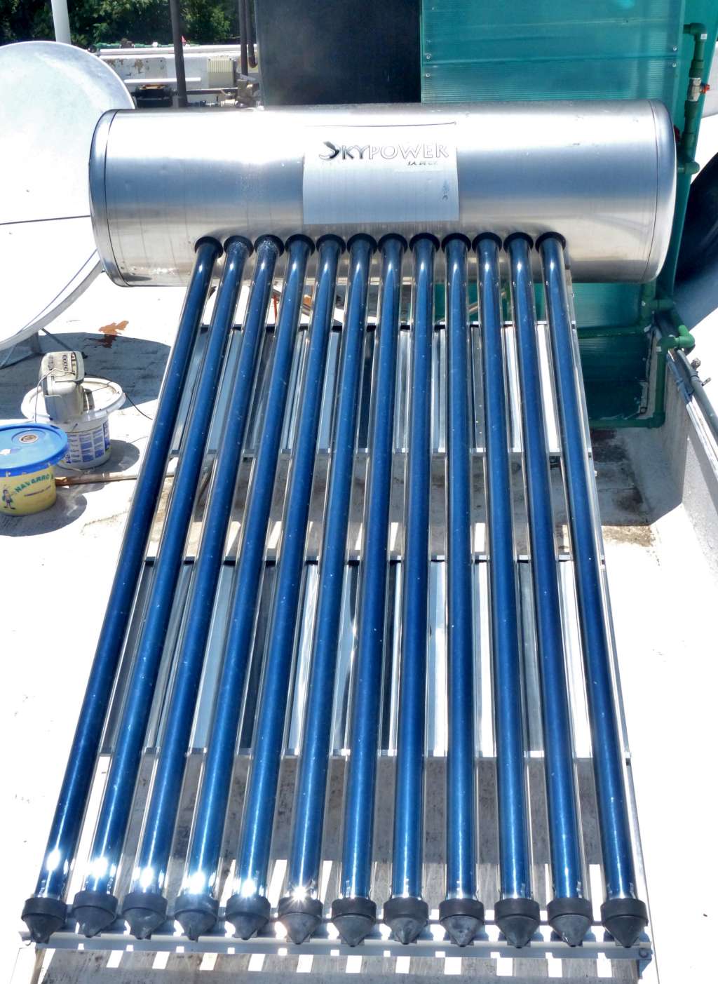

My apartment, which is on the top floor of the building, has solar hot water heating which has proven highly effective. A couple weeks ago, on a day when the outside temperature was in the high eighties, I measured the temperature of the hot water in my kitchen at 170 degrees F.
However, in contrast to John's apartment, three of the four walls of my place are glass from floor to ceiling, and it is not uncommon for indoor temperatures to get into the 90's. So, we have A/C in our place. Because of all the glass, we don't try to cool the house. Instead, if it is just too warm, we lie on the bed, switch on the A/C for half an hour, and cool ourselves. We used the A/C very liberally in May and June, with the result that our electric bill was staggering -- $52.94 for the two month billing period, or something over twenty six dollars a month.

#366986 - 28/06/2016 19:43 Re: Electrical Usage Strategy [Re: K447]
or even better, heat the water with a rooftop solar water heating system.
Like this. It provides water hot enough that I have to be careful, and in sufficient quantity to serve two apartments.
Interestingly, even on a hot day when many things are uncomfortable to touch, those glass tubes transfer heat so effectively that they feel cold.
#366990 - 28/06/2016 21:34 Re: Electrical Usage Strategy [Re: tanstaafl.]
Precisely like that.
Those vacuum insulated tubes can provide hot water even in cold Canadian climate and on moderately overcast days.
If there was a cost effective way to convert excess thermal hot water into electricity, PV and batteries would not be needed.
