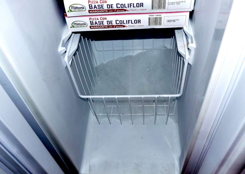

I have a side-by-side refrigerator freezer. It has a built-in ice maker that worked properly until I moved the refrigerator to a different room. Now there are no water pipes connected to it.
It takes about six months for the freezer to get into the state shown below, gradually, a bit at a time.
What is causing this, and how can I make it stop?

Is that basket part of the ice-maker, or just a sliding basket tray?

It is not part of the ice maker (the freezer dispenses ice cubes on the outside of the door) but it is not sliding at the moment as the bottom of it is pretty well locked in ice.

As for the frozen mass of ice at the bottom of the freezer, it must be from condensing/freezing moisture from humid air. This used to be "normal" when you and I were children, but modern "frost-free" freezers have dehumidifiers and/or heaters to prevent it.
So cause #1: perhaps there is a source of humid air entering the machine? Possibly from the still-operating (?) ice-maker mechanism? Or from a leaky door seal (or something stuck to the door seal)?
Or cause #2: something has gone wrong with the defrost circuitry. Most likely a sensor has failed.

I second the opinion that the frost free stuff is kaput. Most freezers use heaters to melt the ice, it is likely that the relay or solder joint on it is bad.
Every time you open the door, all the heavy cold air runs out the bottom and hot humid air rushes in. The freezer will load up on water because of this. The same thing happens if the door seals aren't perfect, as the freezer cycles thru its cool / off / cool cycle, the inside changes pressure and will expel inside air and intake outside air.
That hole in the door for the ice cubes is a prime suspect.
All of which you'd never notice if the defrost stuff is doing its stuff.

Alternative theory: I believe this is a symptom of a blocked freezer drain. When the automatic defroster runs (which I suspect is working fine), it heats up any ice buildup on the evaporator, turning it into water. However, that water now has to go somewhere, otherwise you've just relocated the problem -- once the heater turns off again, the water will simply re-freeze wherever it now is in the freezer unit.
To avoid this, there is a drain hole below the evaporator which will allow the defrosted water to exit the freezer compartment and collect in the drain pan underneath the unit, where it will evaporate naturally.
If the drain hole is blocked, the water will instead remain inside the freezer, eventually filling up the bottom of the evaporator compartment (which is usually behind a cover at the top rear of the freezer) and running down the rear wall of the freezer to collect at the bottom, where it will slowly form a mass of ice.

The ice on the bottom of the freezer is crystal clear, not hoarfrost as would be the case if it were humidity condensing bit by bit. It is extremely likely that it is liquid water from the defrost system running down to the bottom and then freezing.

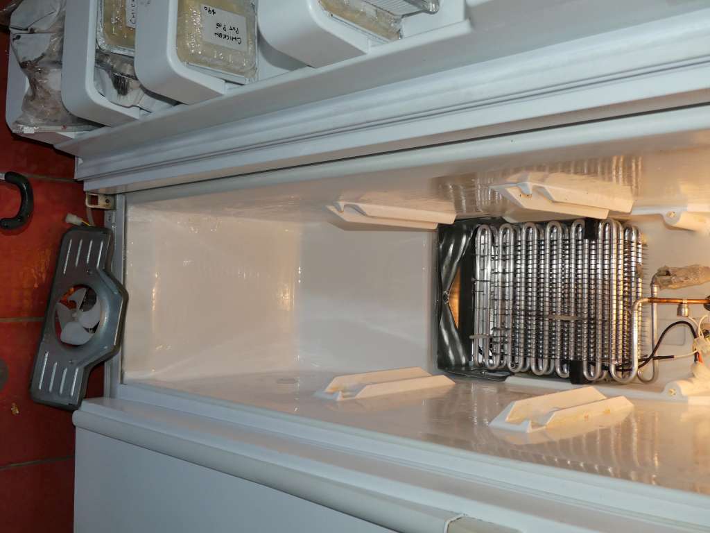

I called in the pros (i.e., the fabled Maytag repairman) and he opened the freezer door and knew instantly what the problem was and how to fix it.
There is no drain on this freezer. The defrost/dehumidify functions are handled by a small ventilation fan that cycles air from the freezer into the refrigerator side and returns it. This carries away the excess moisture before it ever condenses on the walls of the freezer, and it brings cold air into the refrigerator, the amount regulated by a sliding lever to keep it at the correct temperature.
The repair took 45 minutes with a two man crew who drove 50 miles from Guadalajara, and cost $2,000. Fortunately that was $2,000 pesos, not dollars. Figure $89 USD, of which $58 was for parts. Gotta love Mexico.

The repair was to replace the fan motor. That took about five minutes. The rest of the time was spent removing the iceberg from the bottom of the freezer, using special tools available only to factory-trained and authorized Maytag repairmen, that is a hammer and a screwdriver used as a chisel.
