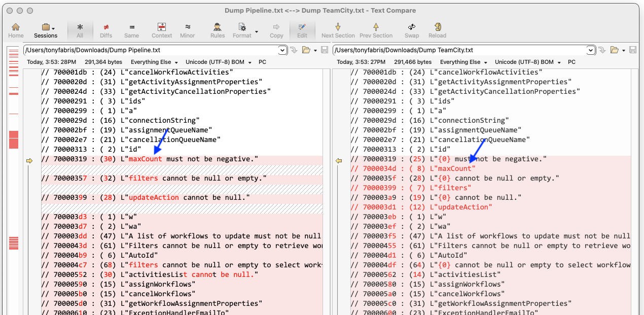

I've done a "dump" of a particular DLL in our artifact set using the ILDASM tool, and I see this interesting difference in the "User Strings" section. The Azure DevOps Pipeline build is "baking in" some of the format-strings, whereas the Team City build leaves them separated. An example screen shot from Beyond Compare is attached below, to make my question clear.
Does anyone know what compiler optimization setting controls this thing shown in the screen shot? For example, a command line parameter to MSBuild or something.
