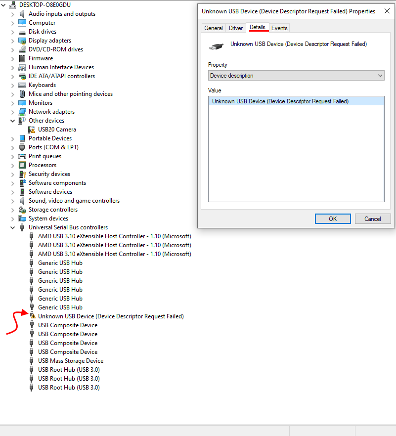

Three days ago my Windows 10 computer stopped talking to my Kindle. It also stopped talking to my wife's Kindle, two old keyboard Kindles, and a brand new Kindle taken out of the box for the first time.
In addition to not recognizing five different Kindles, it also stopped connecting to two cell phones.
Yet, as near as I can tell all other USB devices in the house will connect without problem. This includes external hard drives, a scanner, a printer, my headphones, a card reader, three different USB hubs, my iPod Shuffle, and no doubt a few other things I can't think of off the top of my head.
I have tested the Kindles and phones on ten different ports on three different USB hubs and on the USB ports on the front of the computer case itself. I have tried five different USB cables. All of the devices, Kindles and cell phones, will recharge on any combination of cable and USB port, or off of any wall wart plugged into an outlet. They will not logically connect to the computer. I don't know if this is a software or a hardware problem. Windows 10 gives me a helpful error popup shown below. I don't think this popup is telling me the truth.
What should I do?

Googling for the problem says that in Device Manager you should see, under "Portable Devices", either "Kindle" or "MTP device", and that those puppies might need a driver update.
You said that it disappeared from device manager altogether. Is there any yellow boo-boo icons, something like "unrecognized device" or something?

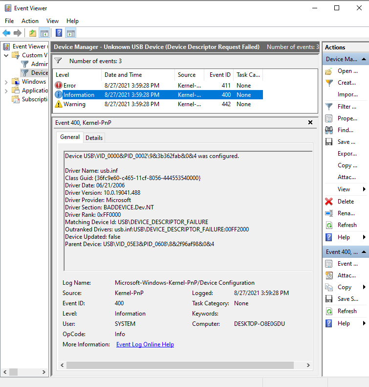

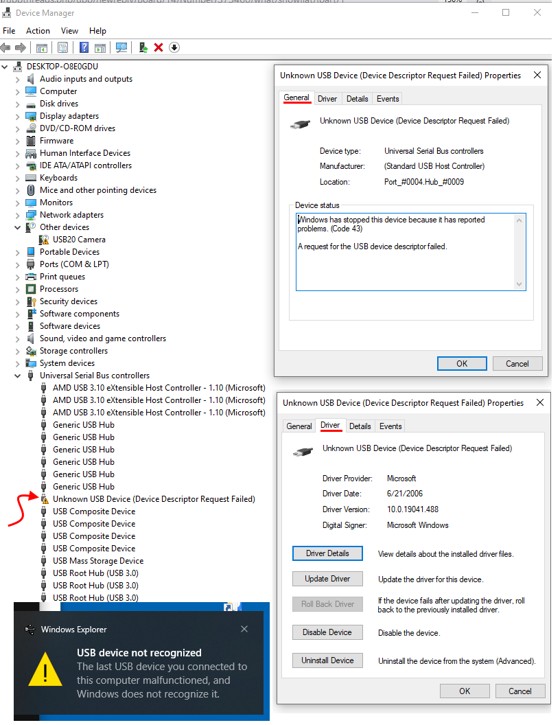

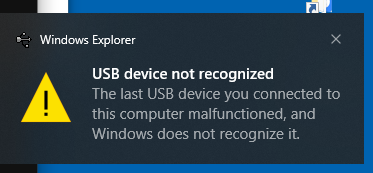

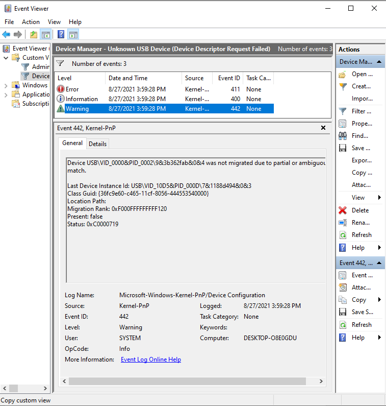

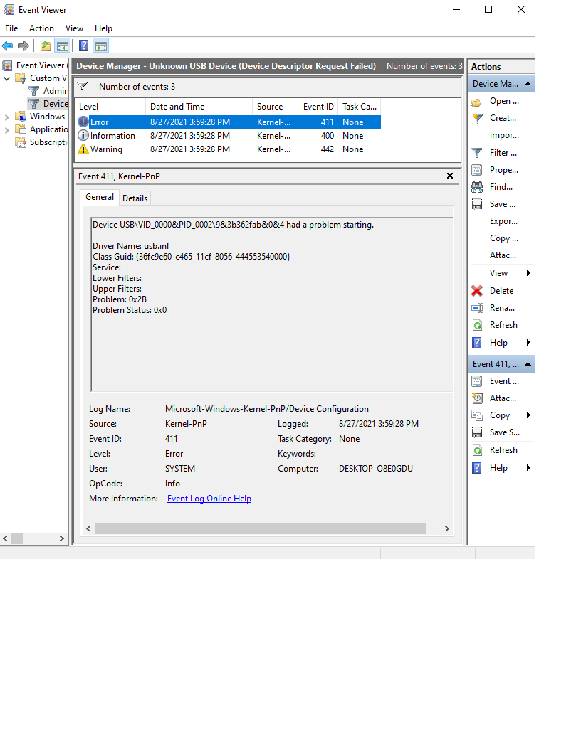

Yes. Attached are screenshots of as much information as I could gather from this.

Wow, a USB vendor ID of "0000" is weird.
Question: When this issue started occurring, what changes had been made to that computer? Examples would be: Plugging in someone else's USB device for the first time, installing a new piece of software, installing new device drivers for a piece of hardware, running Windows Updates, that sort of thing.
Also, is that "camera" with the boo-boo icon something you recognize? Or is that the kindle being incorrectly detected?
