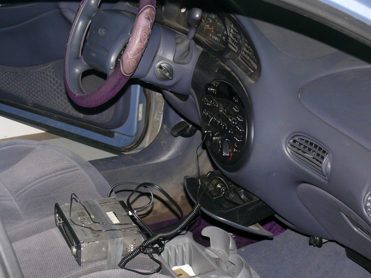

Anyway, attached is my very professional empeg installation. The strap is a piece of mountain bike innertube, and a cassette adapter feeds the audio into the OEM stereo system. Note that I went first class with the power adapter -- not only does it plug tightly into the cigarette lighter, but it has its own on-off switch!
Little Blue Thing, I know you're proud of your remote display adapter in your Jaguar, and I hope you don't become too despondent about the pitiful inadequacies of your own installation after seeing what a true professional can do. Maybe with a few more years experience you may be able to approach (but certainly not surpass) the magnificence of my efforts.
Seriously, though -- this is a $700 temporary car, and I was pleased to be able to somehow get my empeg in it at all, and for a total installation cost (including the piece of innertube!) of about $20. (I already had the cassette adapter on hand.)
Well, I've got to say... I'm impressed!
There's no duct tape visible anywhere!!! wink
I notice the adaptor you've used has nice thick phono leads - good call; they should keep the signal in pristine condition.
PS Love the steering wheel cover though - do they do a Jag one? laugh

And not only is it rather fetching in appearance, it is also extremely functional in a northern climate.
