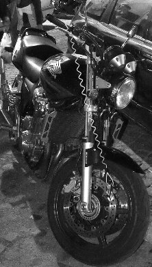

Now you just need a similar interface for the bike!
Description: The "bike"
#316443 - 16/11/2008 17:35 Re: Fusion vs Alpine [Re: mlord]
Hey, that looks familiar. Mine is in color, though! wink
