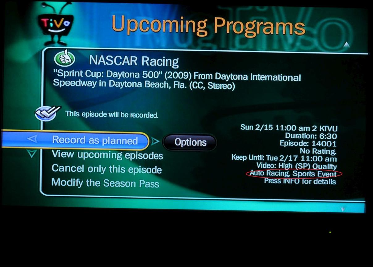

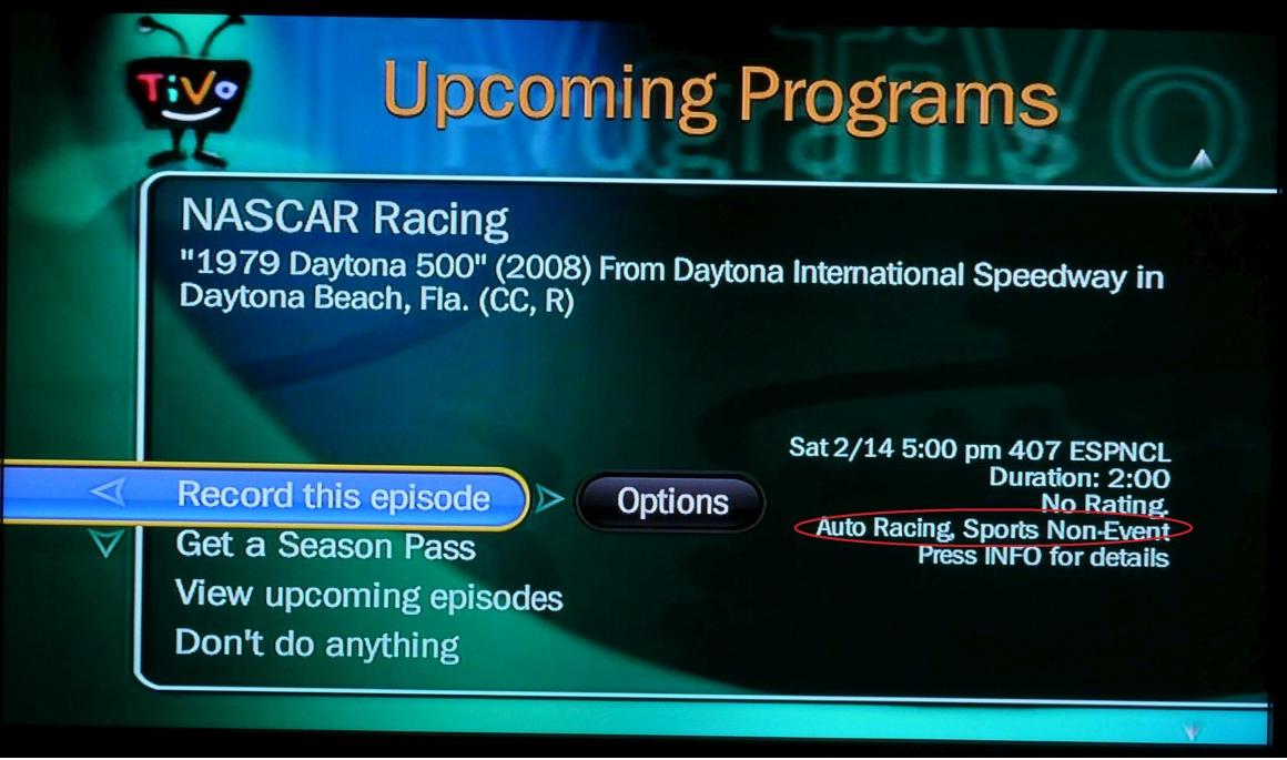

Specifically, I need to look for "Auto racing, sports non-event" and key on "sports non" as an exclusion so I don't end up recording the NASCAR shopping channel and the pre-race show etc. I don't think those categories show up as keywords. I'm not in front of my TiVo right now, but can't you set up a wishlist search and select the subcategory "event" (or whatever the opposite of non-event is)? (I don't watch sports, so I'm not familiar with the categories available for it.) When I select Input 1 on the TV set, it flashes a brief message that it is running at 480P resolution. Is this normal for my setup? I have no idea what sort of resolutions TV sets use, but 480 seems low compared to my LCD computer monitor which is running 1680 x 1050. "Standard" TV — that is, NTSC: what we've all been watching in the US for fifty years — is effectively 480i ("i" meaning "interlaced" and "p" meaning "progressive"), which is 720×480×30Hz. Digital TV supports several resolutions up to (as of now) 1080p, or 1920×1080×30Hz. But NTSC is the highest resolution that you can transmit over an S-Video cable.

Specifically, I need to look for "Auto racing, sports non-event" and key on "sports non" as an exclusion so I don't end up recording the NASCAR shopping channel and the pre-race show etc. I don't think those categories show up as keywords. I'm not in front of my TiVo right now, but can't you set up a wishlist search and select the subcategory "event" (or whatever the opposite of non-event is)? Unfortunately, no. The furthest down the subcategories go is "Sports-->Auto Racing". What I am looking at and trying to catch with key words isn't the program title nor the program description. It's the boilerplate stuff down at the bottom that is the only real distinguishing feature. A little testing shows that the key word search does not address that information. See the attached pictures for what I mean. The "non-event" show is a discussion panel about a 30 year old race with video clips thrown in. The third picture is just a sample to show how bad the picture is when recorded at lowest TiVo quality. It is much better at higher quality levels (no surprise) but even at highest quality it is no better than my old OTA signal at lowest record quality in Alaska. I think Tony has it right a couple of posts before this one. But NTSC is the highest resolution that you can transmit over an S-Video cable. Since my TiVo is not an HD unit, then NTSC is as good as it gets, right? tanstaafl.

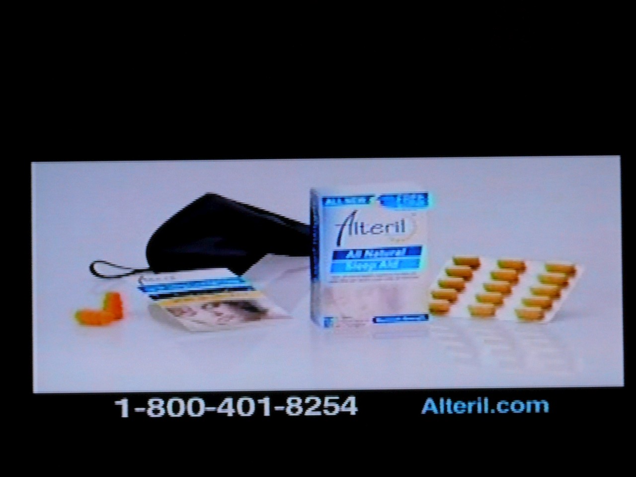

The third picture is just a sample to show how bad the picture is when recorded at lowest TiVo quality. That third picture has a very specific problem to it that isn't related to data compression. It has an interlacing issue. It appears to only be showing one of the two interlaced fields in the frame. It has its lines doubled-up, similar to the problem pictured in the section titled "Single-Field Interpolation" here.It's possible that it's simply an artifact of the thing being in "pause" mode. Sometimes a "paused" picture does that. If so, that's normal. But if your regular day-to-day viewing of a TV show always looks exactly like that picture, then you really need to get it fixed. If that's the case, say so, and we can discuss possible causes and solutions for it. Other than that, yeah, it looks like a typical overcompressed digital broadcast to me: Fuzzy. Muted color palette. Color channel is smeared.

But if your regular day-to-day viewing of a TV show always looks exactly like that picture, No, only if I record it on TiVo at TiVo's lowest ("EP") setting. At the two highest quality levels the picture is acceptable, but not as good as I had OTA in Alaska. tanstaafl.

Remember that your TiVo is lossily reencoding that video, which has already probably been lossily reencoded by your cable company. Even when you're watching it "live". The same caveats that apply to mp3s also apply to video.

Specifically, I need to look for "Auto racing, sports non-event" and key on "sports non" as an exclusion so I don't end up recording the NASCAR shopping channel and the pre-race show etc. Got it! First I set up a wish list for just Sports-->Auto Racing, with title keyword "NASCAR". Then I went to "View upcoming programs" and made a list of keywords that defined what I didn't want. In this case, it was "practice", "qualifying", "preseason", "nascar now", "countdown", and "angels". Then I edited the wish list and added those words as exclusions, and deleted the NASCAR title keyword so it was just auto racing. Ran "View upcoming..." again, found I had to exclude a few items from the Title keyword ("3 Wide" and "Raceline") and voila! A clean To-Do list with only the auto racing events I want in it. Drag Racing and Motorcycle Racing (I am a fan of any mechanized sport) will be easy, just straight wish lists. It's only the NASCAR listing that has all the extraneous stuff. tanstaafl.
