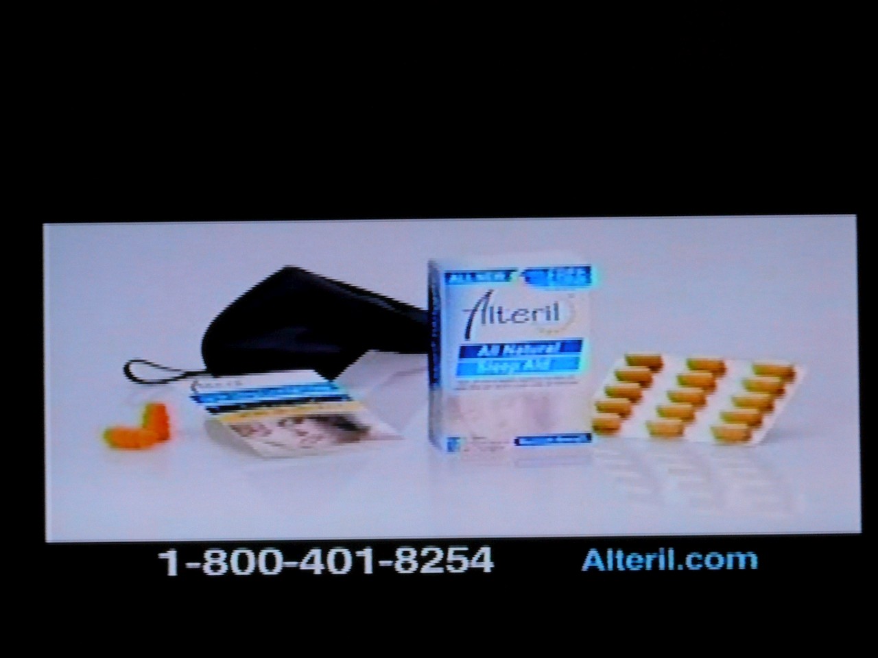

The third picture is just a sample to show how bad the picture is when recorded at lowest TiVo quality. It is much better at higher quality levels (no surprise) but even at highest quality it is no better than my old OTA signal at lowest record quality in Alaska. I think Tony has it right a couple of posts before this one.
But NTSC is the highest resolution that you can transmit over an S-Video cable.
Since my TiVo is not an HD unit, then NTSC is as good as it gets, right?
That third picture has a very specific problem to it that isn't related to data compression. It has an interlacing issue. It appears to only be showing one of the two interlaced fields in the frame. It has its lines doubled-up, similar to the problem pictured in the section titled "Single-Field Interpolation" here.
It's possible that it's simply an artifact of the thing being in "pause" mode. Sometimes a "paused" picture does that. If so, that's normal. But if your regular day-to-day viewing of a TV show always looks exactly like that picture, then you really need to get it fixed. If that's the case, say so, and we can discuss possible causes and solutions for it.
Other than that, yeah, it looks like a typical overcompressed digital broadcast to me: Fuzzy. Muted color palette. Color channel is smeared.
No, only if I record it on TiVo at TiVo's lowest ("EP") setting. At the two highest quality levels the picture is acceptable, but not as good as I had OTA in Alaska.

Remember that your TiVo is lossily reencoding that video, which has already probably been lossily reencoded by your cable company. Even when you're watching it "live". The same caveats that apply to mp3s also apply to video.
