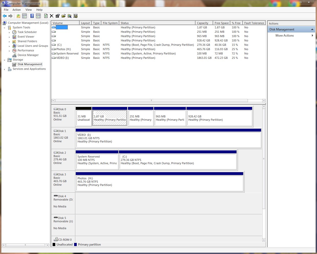

Oh...now that I look at what you had me post, I'm assuming I'm having trouble because the VM has created a virtual disk with the assignment of sda? How do I give it access to the disk that's showing up in Windows as the actual sda? Or should I be trying to get my optical drives working now? smile
I've attached a shot of what I have in Disk Management.

Which of the drives in your Disk Manager picture is the one we're talking about? How is it attached to your PC -- USB? eSATA?

D'oh! Sorry. Yeah, we're looking at the first drive, the one that's all chopped up into multiple partitions, and we're looking at the last partition of that drive. I found some instructions online that said the fourth partition on the first SATA drive would be sda2, but I don't know how you get "2" for the fourth partition. Wouldn't it be "3?"
And the drive is connected to SATA just like the others.
