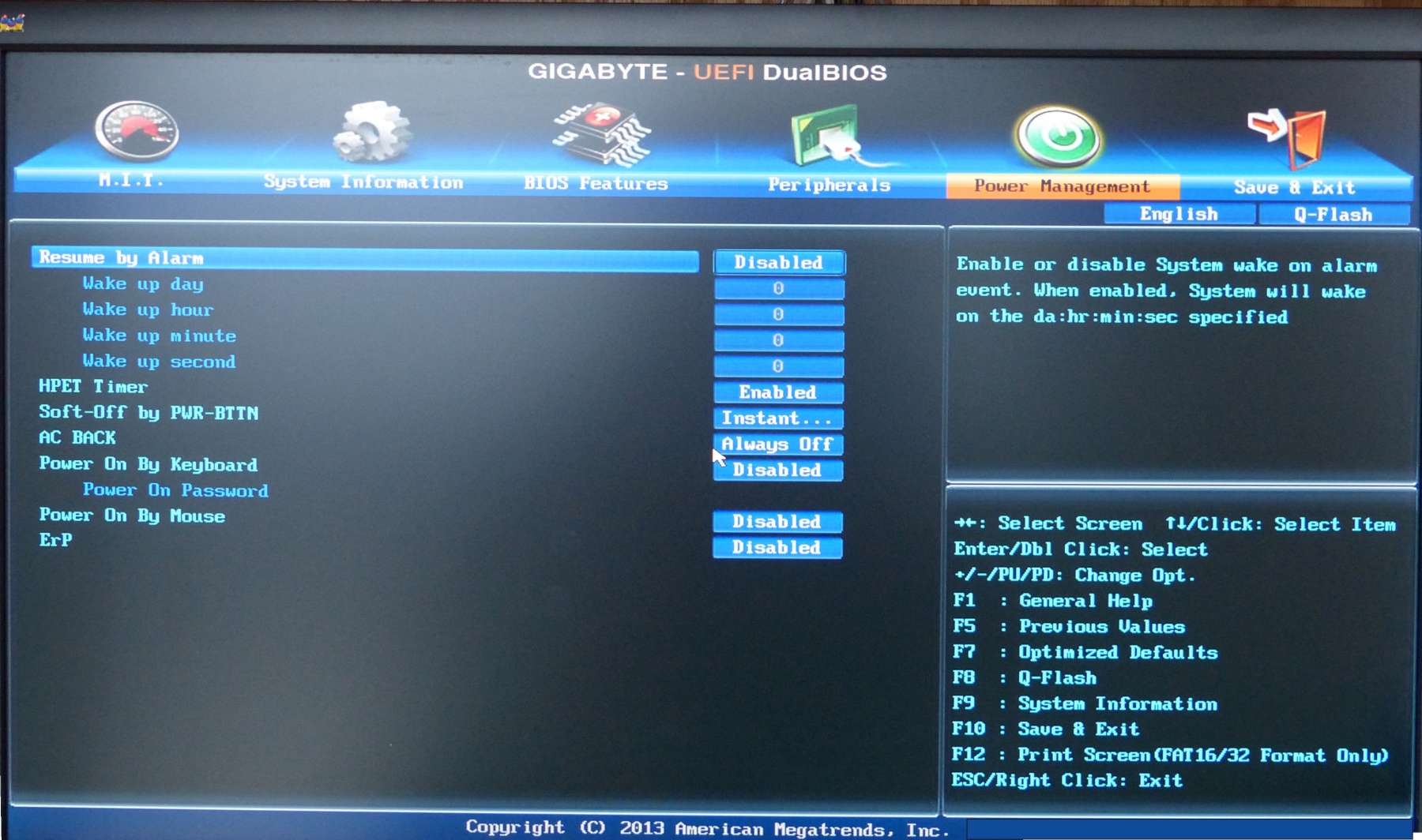

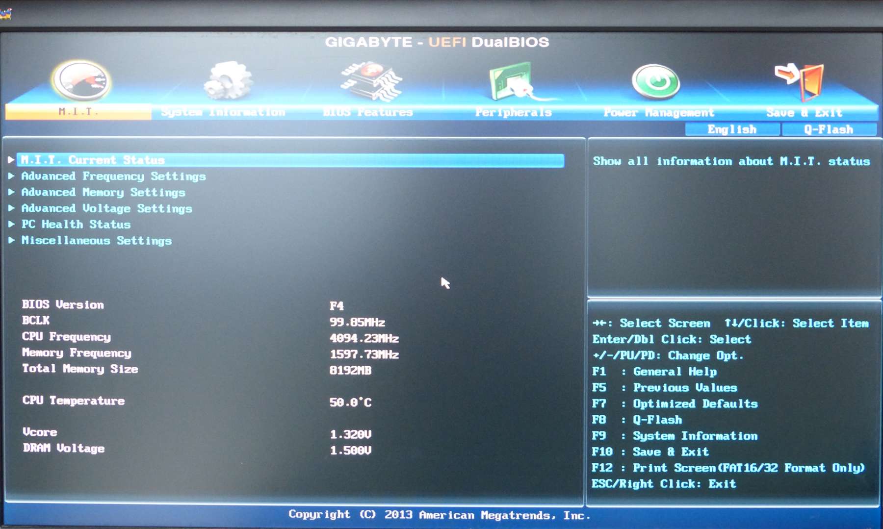

#361420 - 20/04/2014 11:11 Re: A Death in the Family [Re: tanstaafl.]
Posts: 5554
In some cases there is a mainboard jumper or BIOS setting to enable/disable this persistent USB power feature.
I just had a look at the BIOS setup... there must be two dozen acronyms and abbreviations I have no idea what they mean, quite possibly one of them had to do with that. There certainly wasn't anything that simply said "Turn off persistent USB Power". smile
I am not comfortable experimenting with BIOS settings that I don't understand!

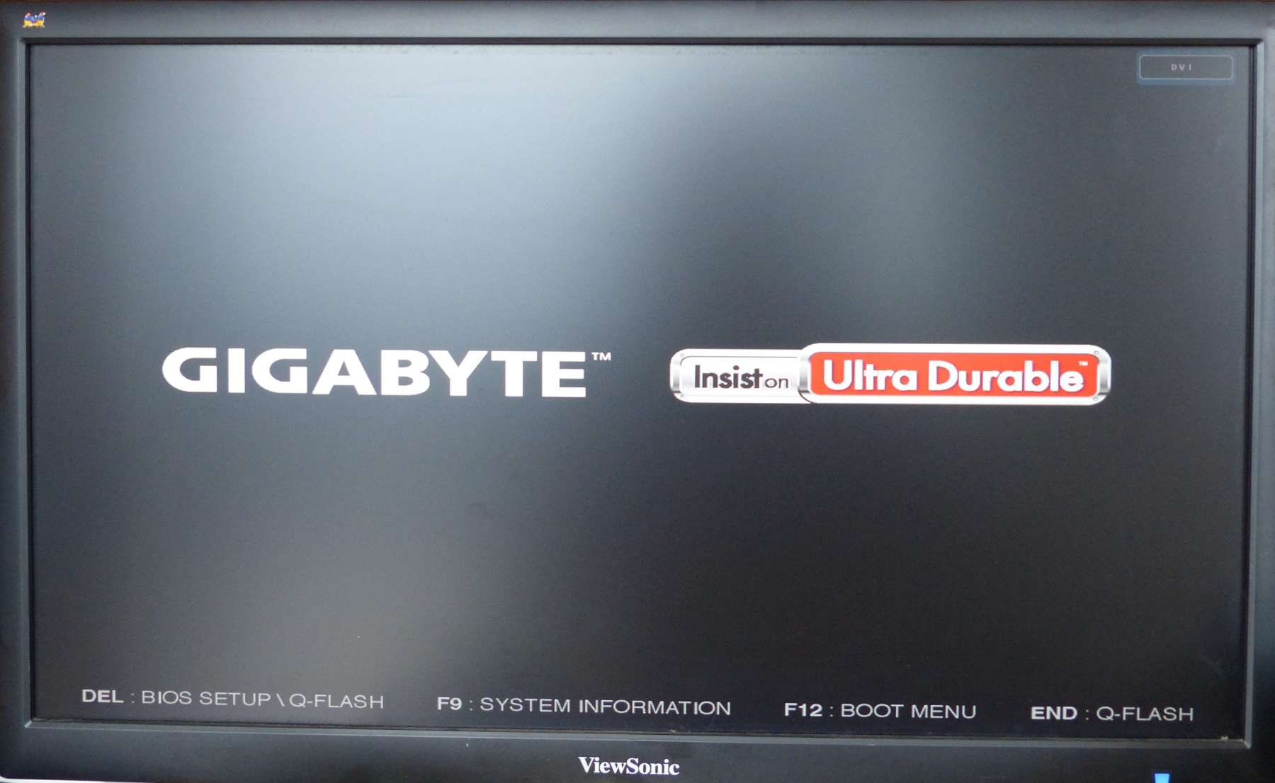

FWIW, on startup the screen flashes "AMD Gigabyte Ultra Durable", and the BIOS setup screen is quite pretty and well laid out, even if it is incomprehensible to me.

I think they like me there, because even though by the standards of this BBS I am a clueless ignoramus, I am vastly more knowledgeable than most of the people who come through their doors. Makes me easier to work with.
OK, update: I found that changing the ErP setting in the BIOS fixed the problem. [ErP refers to Energy related Products directive]. The default setting is "Disabled". When Enabled, the USB ports do indeed turn off when the computer is shut down.
However... there may be an undesirable side effect. I need to re-test this, but the one shutdown I did with ErP Enabled seemed to turn off the whole computer... permanently. It wouldn't power back up. After ten minutes of fiddling with the power switch, the power supply switch, plugging and unplugging the A/C power cord, suddenly there was a relay click from inside the computer and it came back up.
Since the only way I can get into the BIOS is to turn the computer off again... well, if you don't hear from me for a few days you'll know what happened. smirk

The ONLY thing I have done in the BIOS was to Enable the ErP setting, and we saw how well that worked out. It took me another 15 minutes to get the computer to power up (not boot, just start spinning hard drives and fans) and the only way I could make it happen was to (a) unplug the power cord; (b) turn the power supply switch off; (c) plug in the power cord and listen for the relay click; (d) turn the power supply switch back on; (e) press the start button on the front of the case. This procedure worked twice, the second time allowing me into the BIOS to disable the ErP setting (that is the default) and now it is working almost normally. Strangely enough, I now get a "No Video" message during the bootup at just about the time the full-screen "Durable Gigabyte" logo screen used to appear, but no longer does so.

"Enable" the ErP thing. That should cause the USB ports to power down completely.
EDIT: Oh, I see you've already discovered that. Good!
Except it shouldn't give the grief that it does (mine doesn't).
Hunt for BIOS updates?

The real issue is that ErP didn't work when Doug tried it. It solves all of these BIOS-created problems, by making "power off" mean "99.9% powered-off" again.
I use a very recent GigaByte mobo here with that feature, and my power-on button does still work fine.
Try it again?
Look for BIOS updates that might fix the bug?
RMA the defective mobo?
