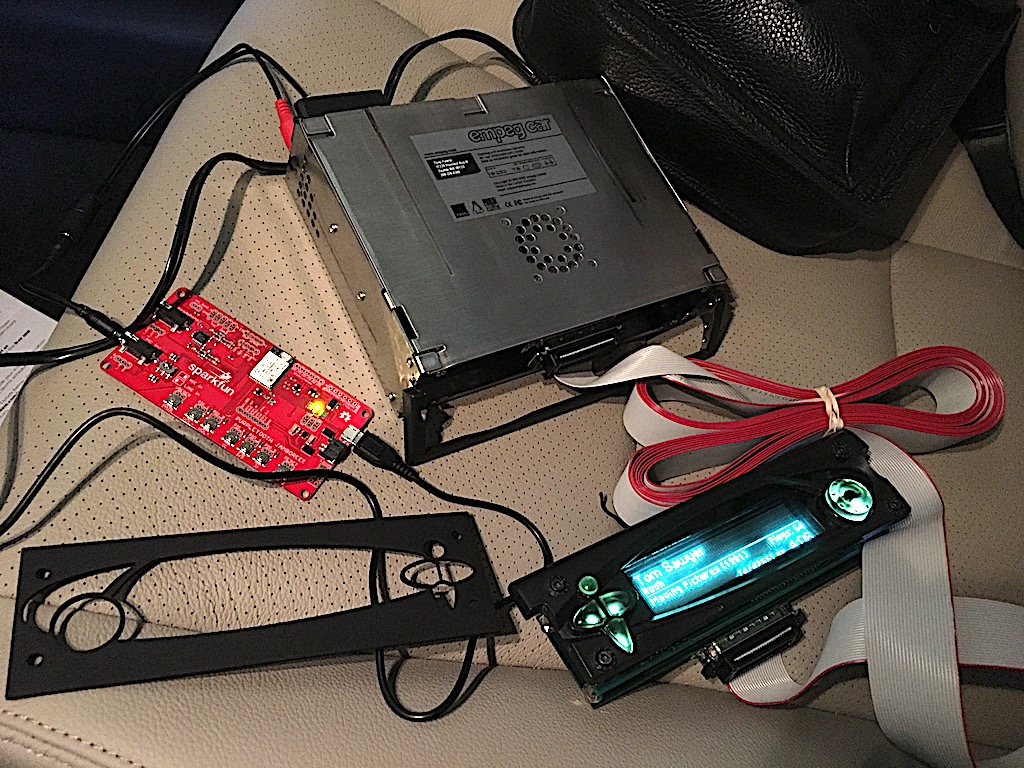

Current status of project:
- Sparkfun Purpletooth Jamboree board acquired after a bit of a wait for it to come back into stock (thanks, elperepat!).
- Purpletooth board tested, successfully pairs with my Honda stereo and survives power cycles and re-pairs automatically afterward. Empeg's output into the bluetooth into the car stereo sounds good.
- Confirmed that it accepts bluetooth commands from my factory car stereo. At least I think it does. It should. Though the empeg doesn't yet accept serial commands from the sparkfun board, I can at least press "pause" on my car stereo touchscreen and the sparkfun board mutes its output. I'm pretty sure that's what it's doing at least, since the pause button on the board itself also does the same thing.
To do:
- Figure out how to get the serial output of the Sparkfun board to change tracks and play/pause on the empeg itself.
- Options are: (a) Additional arduino piggyback board to translate sparkfun board's output into empeg-serial-input-compatible commands, or (b) Hijack kernel patch as Shonky suggested.
- Since I know how to do (a) but not (b), I might go that route.
- I need to learn the stuff in the undertanding the BC127 guide to do either of the above.
#369135 - 24/08/2017 23:18 Re: I made a Bluetooth interface. [Re: FieroSTi]
You shouldn't need to patch the kernel. So the Sparkfun board has a USB from the photo. That will probably just give you a virtual COM port if you plug it into a PC. I would expect from that you would/could/should get the skip/play/pause type messages. You can probably test and do that with some fairly simple (AT?) commands.
Now the empeg doesn't have a USB host port but does have a regular serial port. I'm assuming the white square in the middle of the red board is the actual BT module doing all the work. It will likely have a regular serial port on which with some level shifting should talk to the empeg serial port.
Then it's a case of an application or script that sits on the empeg talking to the BT module via the empeg serial port for commands and also talking to the player software (or kernel) to control the empeg player software. Passing the track info back to the car is likely even possible.
Or an Arduino that can do the USB host to the sparkfun board and then convert it to empeg serial commands. Arduino just seems a bit superfluous to me although is likely and easier method to program if low level stuff isn't your thing.

I've currently got the Sparkfun Jamboree board successfully getting its power from, and outputting its serial output to, an Arduino Uno that I had lying around, but I think I need to get a different Arduino board that includes two serial ports.
What I think I need is:
Sparkfun serial ->
Arduino serial input 1 ->
Arduino code to translate sparkfun messages into Empeg serial commands ->
Arduino serial output 2 ->
Arduino RS-232 Add-on board ->
Empeg RS-232 input.

#369155 - 29/08/2017 08:57 Re: I made a Bluetooth interface. [Re: tfabris]
Sure, just seems rather complex to put something inline in the serial port. You wouldn't necessarily need to compile code on the empeg. A script should be able to do it.
You could probably bitbang a suitable UART with your Arduino that you already have couldn't you? I'm not much of an Arduino guy, but I'm pretty sure it's feasible particularly for a reasonably dedicated device.
#369156 - 29/08/2017 12:22 Re: I made a Bluetooth interface. [Re: FieroSTi]
Yeah, all Arduino chips have "Software Serial" that enables multiple additional serial ports, in addition to the usual "hardware" port. So all that's needed is just a simple Atmega-328p chip, and a MAX RS232 interface chip.
