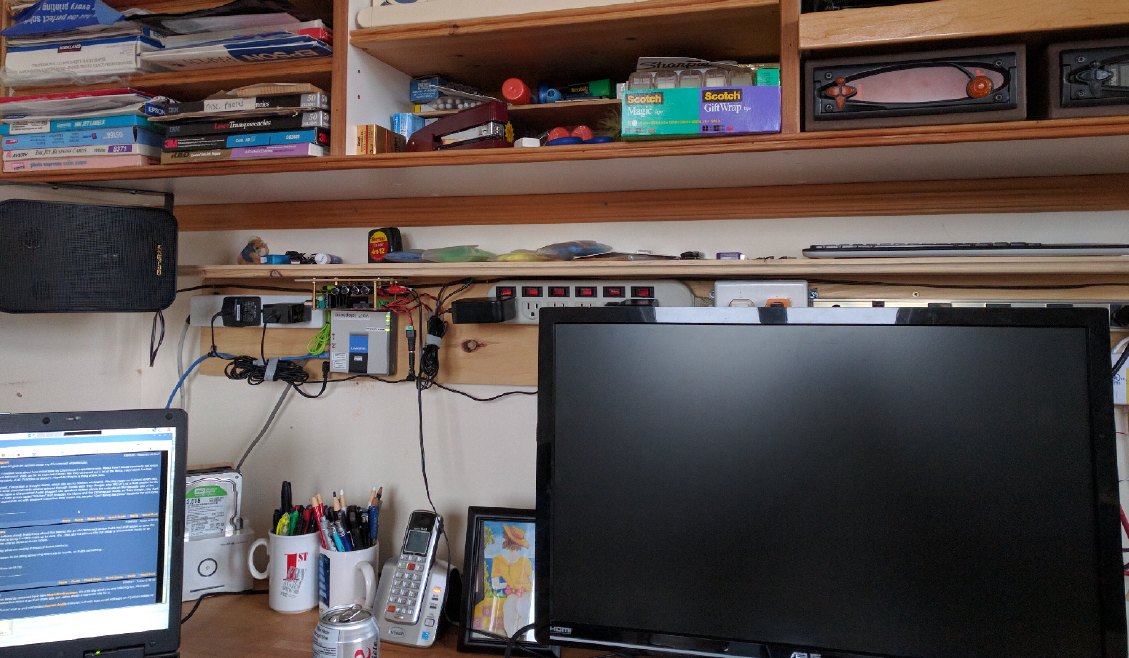

#368592 - 07/04/2017 11:48 Re: Whole home audio [Re: Dignan]
Posts: 14535
Exposed wiring an issue? Nah.. wink
One corner of my home office, with the "sound system".
Description: Amp near centre of photo.
#368593 - 07/04/2017 12:38 Re: Whole home audio [Re: mlord]
Wall mounting small electronics stuff really does make a difference.
If I can avoid stacking electronic stuff on a shelf, or not even have a shelf, so much the better. Especially for gear that is not going to change in configuration very often.
I have been known to just poke screws straight into the drywall for equipment mounting, with nary a plastic plug, but a section of wall mounted plywood makes it easier to rejigger locations as needs evolve. I sometimes paint the board wall colour, if the opportunity arises.
Tucking the equipment inside a closet (perhaps with modest ventilatation), I will install an LED lighting strip so I can see what I am looking at when working in there. Which hopefully is not often.

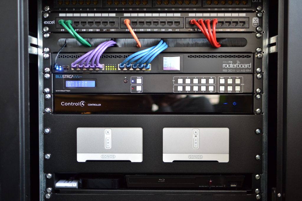

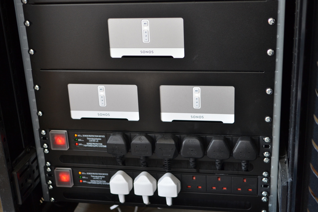

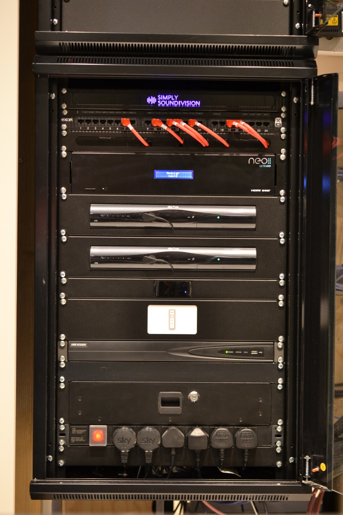

I do quite a lot of residential projects, working on everything from a couple of Connect:amps to huge Control4 systems.
There are rack mount solutions for SONOS products that work well, you can see some of these on this Instagram account: https://instagram.com/ssavprojects
A similar albeit higher end alternative is Bluesound. While it may look like a me too product, the proof really is in the sound quality.
If you do really like Chromecast Audio, take a look at the NAD CI 980 and CI 940. With one of each and six Chromecasts you would be done.
#368599 - 08/04/2017 15:39 Re: Whole home audio [Re: sein]
Originally Posted By: sein
There are rack mount solutions for SONOS products that work well, you can see some of these on this Instagram account: https://instagram.com/ssavprojects[/url]
I'm sorry, but I wouldn't call that a rack mount solution. It's more like multiple Sonos units on a rack. smile

#368600 - 08/04/2017 15:56 Re: Whole home audio [Re: sein]

#368601 - 08/04/2017 22:37 Re: Whole home audio [Re: BartDG]
There are some freestyle solutions in there for specific locations, but if you keep scrolling you'll find some actual 19 inch rack solutions too.

#368602 - 08/04/2017 22:41 Re: Whole home audio [Re: sein]
Ah, didn't see those pics, thanks for that! However, I still don't think that's a true rack based solution, but I do agree it's nicely done. Probably the best somebody may expect with the limited options there are.
