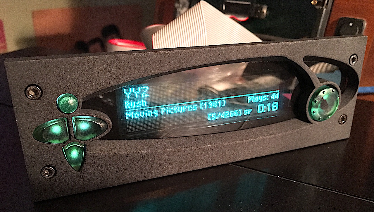

Current work in progress. This is my second test print. I think I need at least one more revision before making the files public.
Notes:
- It's deliberately smaller in the X direction, without the "ears", so one must carefully trim the ears off of the lens without cracking it.
- Bottom edge is deliberately "big", it extends downward so that it covers the position of the downward-pointing ribbon cable connector on the display extender. Eventually I think I might make a version of this design where it's a full-box that completely encloses the display extender instead of just being a fascia, and so I needed that clearance.
- Everything fits and all buttons work, screws fit perfectly, pretty happy with the fit overall. However...
- After all the measuring and tweaking, the left/right buttons still fall out of the fascia. I need to make the holes a bit narrower at the top still (again). I'm sure I got the measurements right, so I can only conclude that the plastic printing and sintering somehow makes plastic around the openings shrink a bit?
- I still haven't sculpted the ring around the encoder knob. That needs to be recessed a bit so that the knob isn't so buried in the ring. It works fine, it's just you can't grab the sides of the knob.
- All the buttons work well but the bottom button ended up a hair recessed: The original fascia has that area sculpted downward, so I'll want to match that on my final version.
- Maybe I'll change the upper curve a bit so it doesn't cut off the upper left corner of the display as easily? Dunno.
- The curve on the far right still gets too close to the edge, I think I'll try to rein that in a bit.
- The final version of the published files will contain a "Squared off" version like pictured, and another with rounded beveled edges at the top and bottom.
#369185 - 31/08/2017 12:47 Re: 3D model of fascia? [Re: tfabris]

#369280 - 09/09/2017 02:55 Re: 3D model of fascia? [Re: tfabris]
Third test print:
- Recessed the swoop around the knob.
- Made the entire thing 1mm thinner so that the bottom button would protrude a bit more.
- Made the button holes smaller.
And this one has more problems:
- The left/right buttons STILL fall out. The plastic has as much as 0.4mm shrinkage in the final print, so I keep overestimating how big the button holes have to be.
- With the thinner fascia now the four screws don't sit all the way down, so I have to make them sit up in little protrusions like the original fascia.
So I'm going to do those things and do yet another test print, and if the button holes are finally fixed then finish it up with the two versions (flat and beveled).
Pretty happy with the looks of it overall though.

#369283 - 09/09/2017 13:38 Re: 3D model of fascia? [Re: tfabris]

Looks pretty good. One small suggestion: slightly round those rather sharp looking outside corners. Just slightly, enough to take the edge off without making them look rounded
You mean the outermost four corners of the rectangle? Yes, I intend to do that depending on how the final installation ends up.
I'm planning to post two versions of the file. The first one will be where the fascia is inset into a simple flat rectangle as shown, with the purpose of that being the "baseline" from which other custom installation projects can work off. Having the outer corners of the model start off as a simple rectangle makes modification easier from that point.
Then the second one will have rounded corners and beveled edges for my particular installation.
