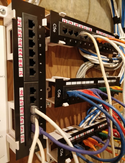

Edit: I get my stuff from a nearly "local" wholesale supplier: http://www.computerplug.com/nav.php?cat1=Networking&cat2=Patch_Panels_and_Accessories The 12-port CAT5E panels I use are about CAD$22 each; a 96-port CAT6 panel sells for about CAD$200.
Description: The rj45 patch panels I use here.
Edited by mlord (08/07/2019 14:31)

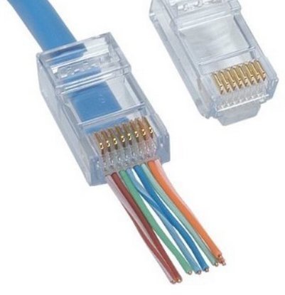

.. I really hate terminating RJ45 if I have to do more than about 4 ends in a sitting.
For RJ45 terminations, years ago I switched from run-of-the-mill style connectors to the EZ-RJ connectors (and tool). Much, much faster.
https://www.amazon.com/Platinum-Tools-EZ-RJ45-Crimp-RJ-11/dp/B00084Y1ZI/
https://www.amazon.com/Platinum-Tools-100010C-Connectors-Clamshell/dp/B000FI9VU2/
Description: EZRJ connectors
Edited by mlord (08/07/2019 14:49)
#372138 - 08/07/2019 18:52 Re: Patch panel vs keystone? [Re: Dignan]
I've been using those too and it definitely makes things much easier, though the connectors are more expensive.
Yeah those front/back connector models don't make sense to me unless for some reason you already have a bundle of terminated cables.

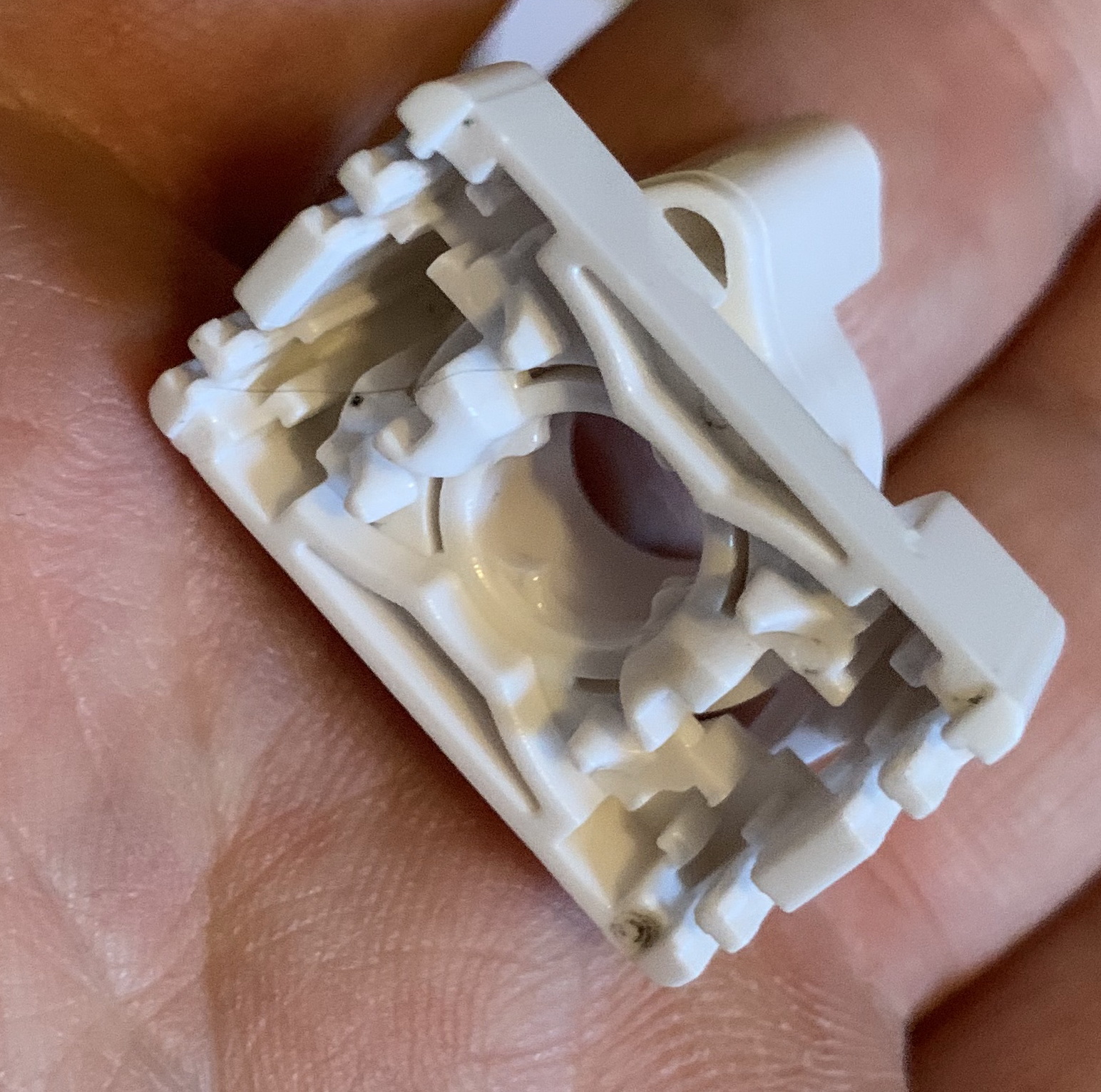

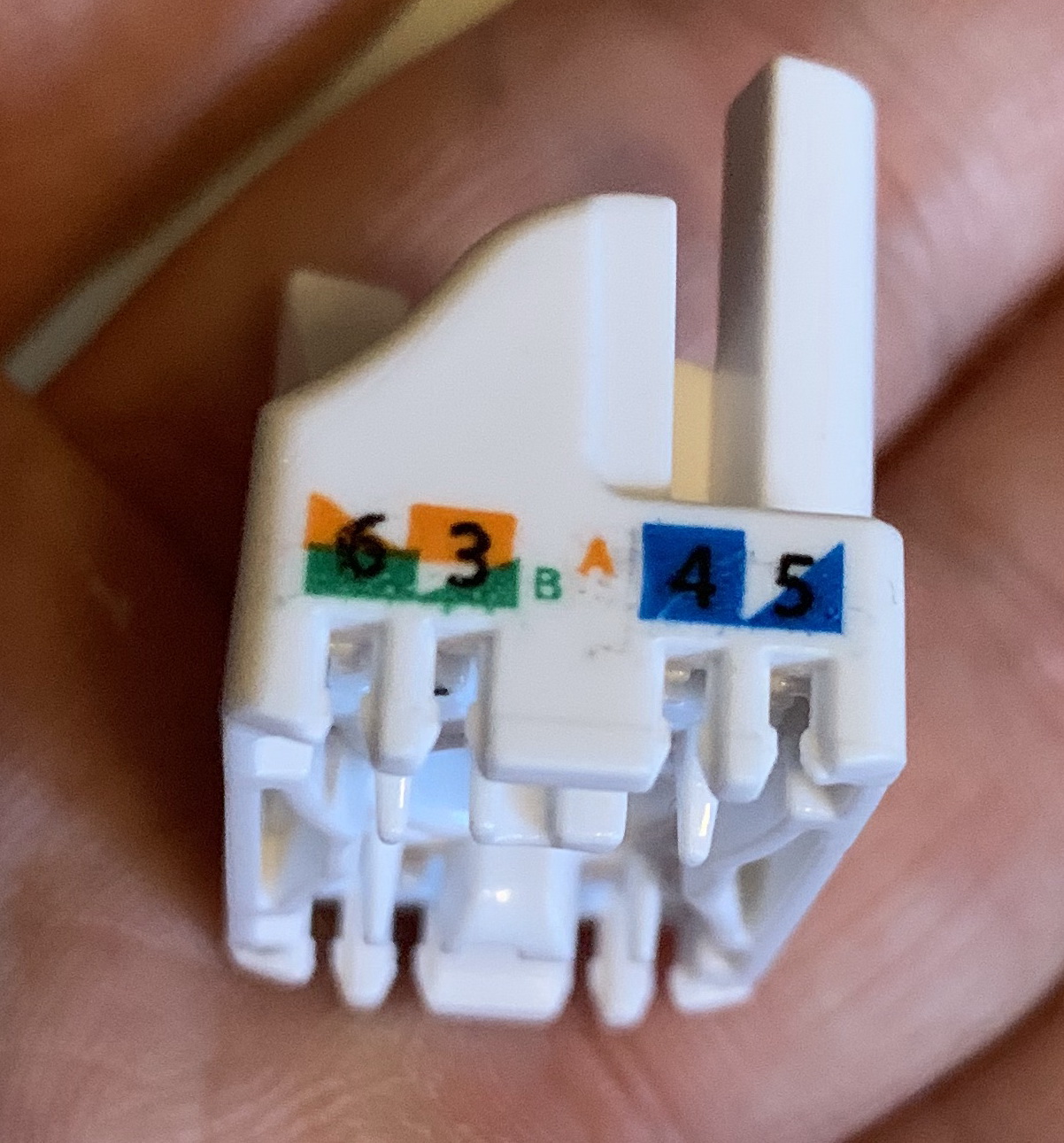

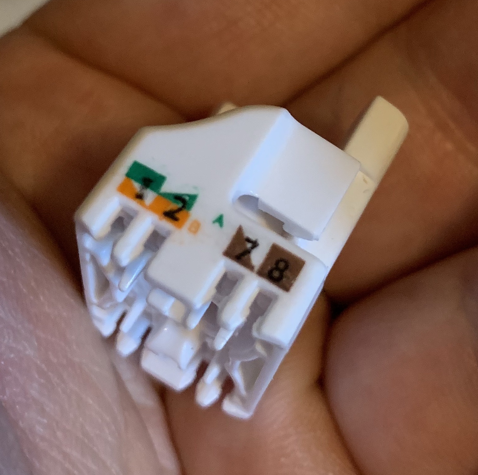

Originally Posted By: Taym
I'll try to take a picture of it, tonight, once I am home. At the time I remember finding various brands (all unknown to me) using this system. But, I made a quick search now and I can't find any.
No brand or model anywhere! Sorry. I took a number of pics for you to see. I’ll tru to post them later or tomorrow. Hopefully they’ll help u find similar products.

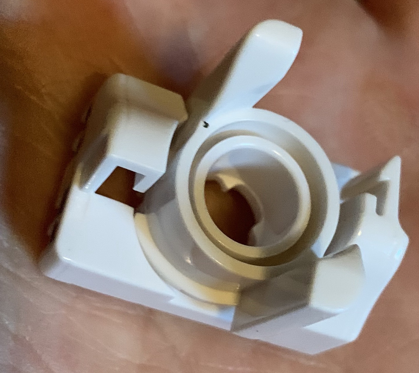

#372164 - 21/07/2019 13:56 Re: Patch panel vs keystone? [Re: Dignan]
Some pics. Not sure this helps, but...
#372165 - 22/07/2019 02:56 Re: Patch panel vs keystone? [Re: Taym]
Posts: 798
So, no logo or name anywhere frown
#372166 - 22/07/2019 10:09 Re: Patch panel vs keystone? [Re: Dignan]
Nope. Sorry.
Funny thing is that when I bought this (2 years ago, I realized by looking at my Amazon order) I remember there were few other patch panels all with a similar system. Nothing now. That is unfortunate. I really like the system.
#372167 - 22/07/2019 10:15 Re: Patch panel vs keystone? [Re: Dignan]
Anyway, as you could see, cable goes through the cap center hole, then individual wires are separated and go into their specific place, still in the cap. Then you cut the part of the wire that sticks out. Then, finally, you place the whole "assembly" (cable + cap) on the patch panel - a notch will guide you and insure proper positioning - and finally you twist the rotating part of the cap. That will screw the assembly in place, and press the cables and insure electric contact. I've done this quite a few times and it never failed.
I am really surprised there's no company to own/patent/brand/sell this. It's a clever product and using it is faster than explaining it in words.
Oh well.
edit: unless there's some weakness I am not aware of, but I've been using it for two years without issues. It's CAT6, supposedly, and I do get 1Gbps full speed on virtually anything connected to it (NAS, servers, APs, etc.).
Edited by Taym (22/07/2019 10:17)

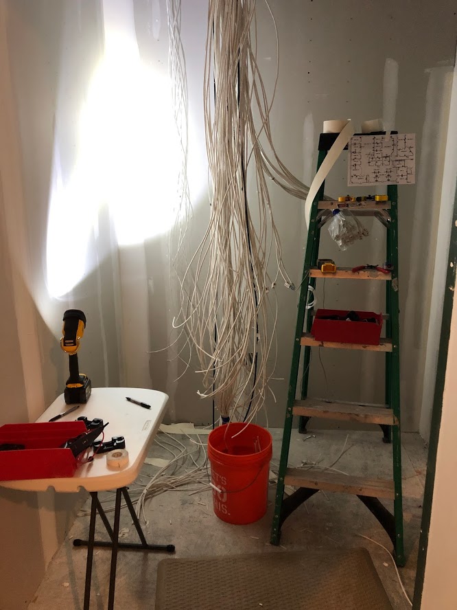

#372191 - 07/08/2019 20:43 Re: Patch panel vs keystone? [Re: Dignan]
I've pulled the lines. It took forever. I need to hire people.
But here's before:

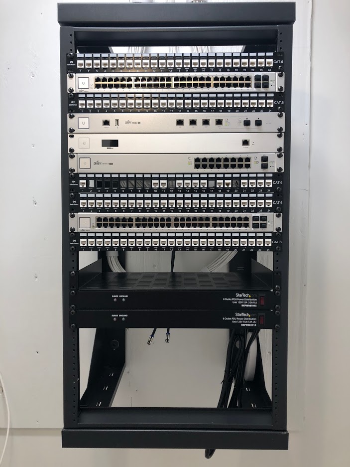

#372192 - 07/08/2019 20:43 Re: Patch panel vs keystone? [Re: Dignan]
And here's after:

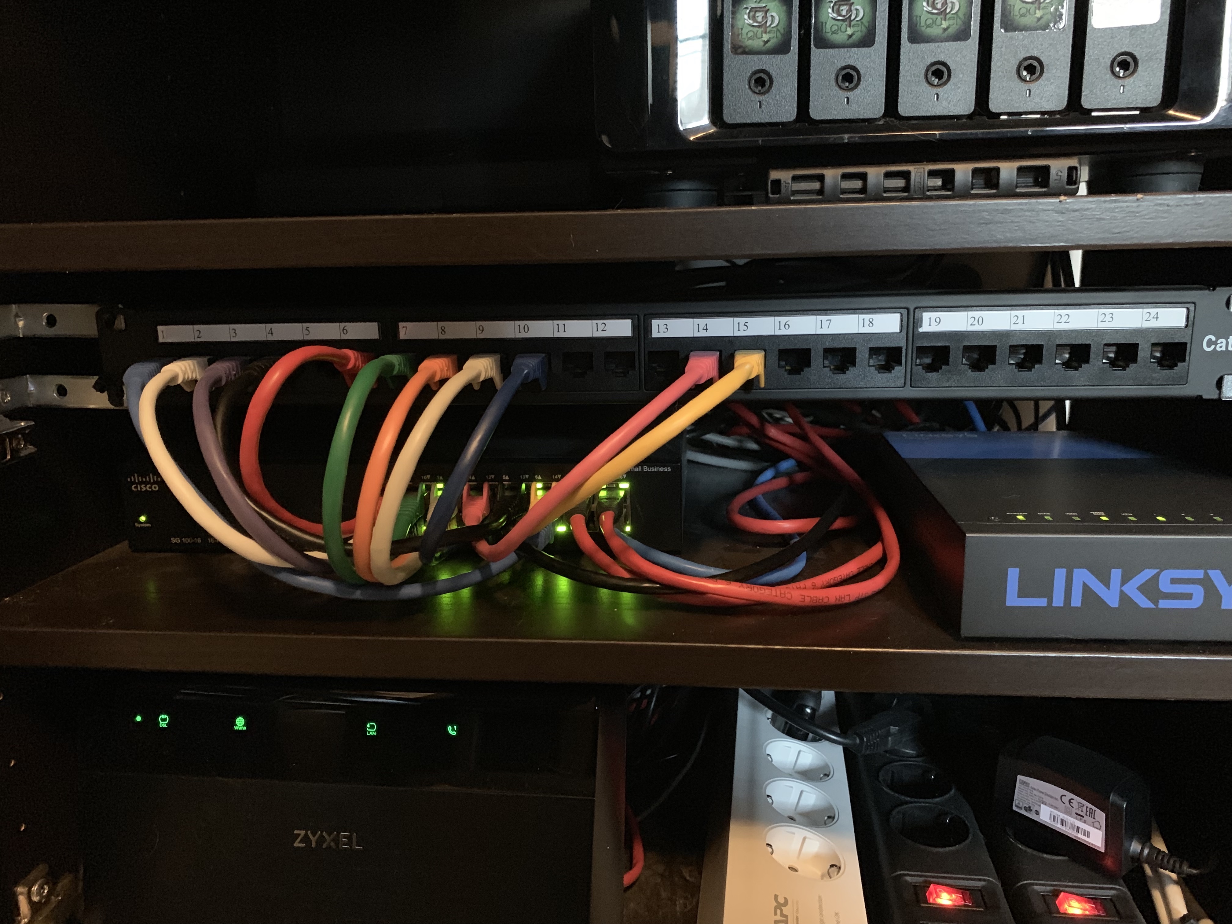

I have no significant experience, but would it not be wise to have a couple of cable management 1RU pieces?
Looks nice now, but how will it look when patched?
#372208 - 14/08/2019 20:19 Re: Patch panel vs keystone? [Re: Dignan]
I seem to have forgotten to take a photo of it patched, but I think it still looks good. I'm not sure what kind of cable management piece you're referring to. Do you have a link?
#372209 - 14/08/2019 21:08 Re: Patch panel vs keystone? [Re: Dignan]
Posts: 31572
I think he's referring to these kinds of doohickeys.
https://www.amazon.com/Server-Rack-Cable-Management-Horizontal/dp/B073X4PLG9
#372210 - 14/08/2019 22:28 Re: Patch panel vs keystone? [Re: Dignan]
Yep, those. To keep the excess bits of cable tidy as patch cables are rarely the exact right length.
#372218 - 22/08/2019 13:14 Re: Patch panel vs keystone? [Re: Dignan]
Ah ok. I'm not sure why I'll need that though? all the lines come into the back of the patch panel, then all my connecting are with short patch cables. I took a photo last night...
#372219 - 22/08/2019 13:22 Re: Patch panel vs keystone? [Re: Dignan]
Sure, patch cables are rarely the exact right length, but you can get pretty close laugh I also organized the rack so that I could use mostly a single length of patch cable (6"), and as a bonus the switches get some room to breathe. I generally try to keep dozens of patch cables in varying lengths on hand in general, though for a project like this, my design let me put in a bulk order for ~120 6" cables.
I never make my own anymore. At least not in this quantity. It's not worth my time, TBH. And I can pass the cost along to the client anyway smile
#372220 - 22/08/2019 13:28 Re: Patch panel vs keystone? [Re: Dignan]
The boxes to the left of the rack, btw, are access control boxes for the six doors they hired me wire up. I just finished installing and wiring those last night.
